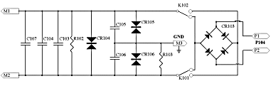

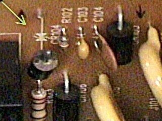

There is a TVS that is located on the actuator supply pcb that go bad. I believe the part # is CR104
Here is a link for the part:
1.5KE51CA-E3/54
You can clip one end of the leads if it is shorted to see if it restores operation. If it does get the new parts before using it for regular service.

Removing the TVS diode did not allow the circuit to function. Would I be correct; one could use the diode check function on a VOM and get no passage either way? I don't. :confused: I did run into a Dinosaur TVRO guy here that is going to let me have some old 922s to play with, maybe I can switch out the entire rectifier board and get it back up.

Is there voltage at the input and output of the bridge? Is the bridge rectifier shot? The circuit is pretty simple. Vcc through bridge feeding a couple relays. A few protection devices too.
You should check the caps and other parts for any signs of short, value change etc. If your going to get another 922 with a known good board in it then I would do a swap. If that don't fix it the issue, it's looking like a logic control problem. If that's the case you would be better off to ship it to ATS. To answer your question about the TVS if it was shorted when you clipped it from the circuit the thing would work as long as the logic circuit is good.
