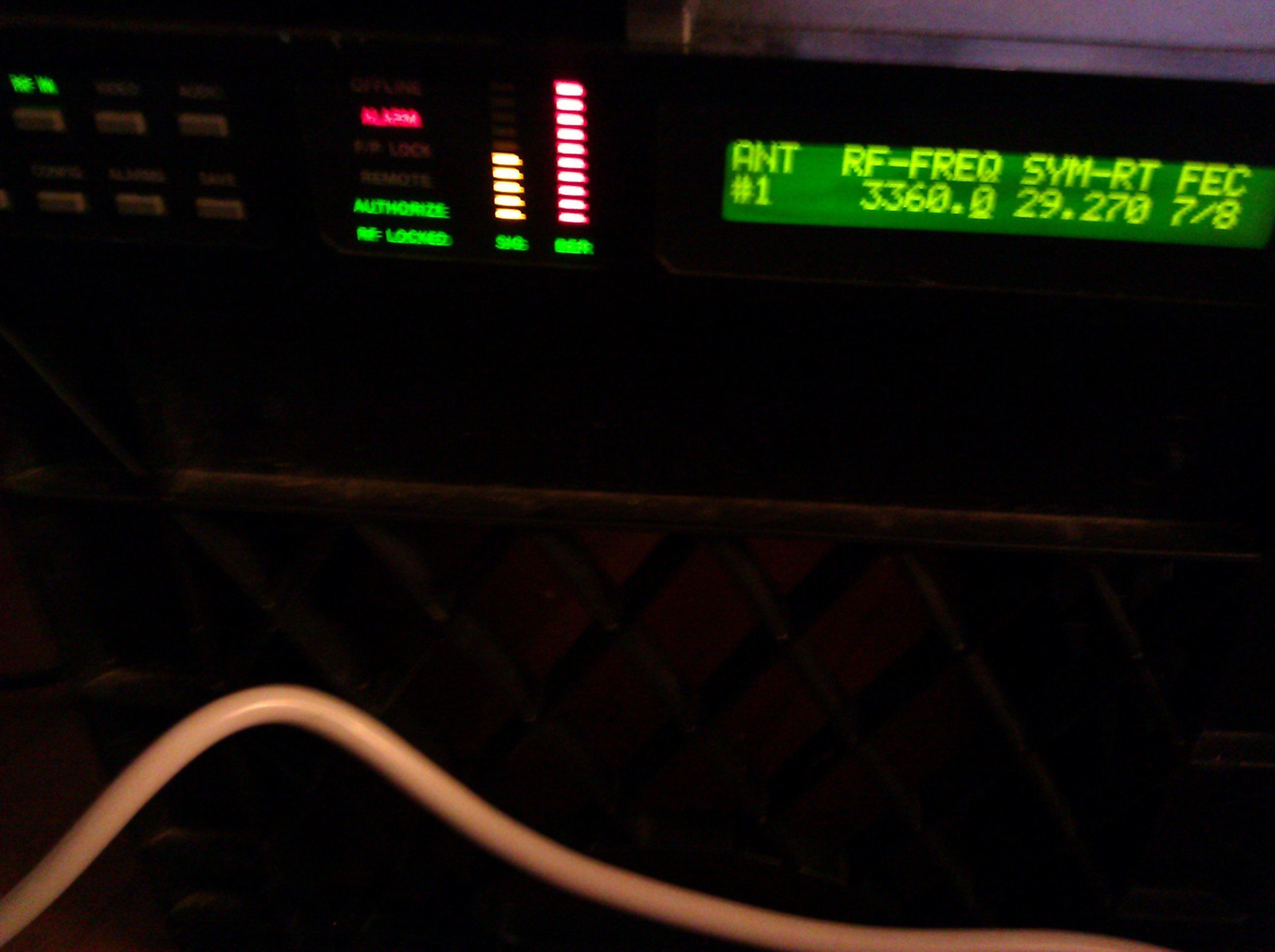

I am using a dte-7100 receiver and it seems whenever I lock in H signals. I am unable to manually enter and tune vertical signals. For some reason it won't let me switch. I have it slaved VIA Openbox. Even when the channel on the openbox is on the desired polarity the digitrans will not tune in that polarity. I am not sure if there is a setting I need to switch but it is very inconvenient.

I just fired up my 7150 and the only LNB options are none, 5150,10750,11250 so you would set it for 5150 and just take the frequency and subtract 600 from it and enter it that way
Well I had the H transponders working on DC2 the other night when I discovered I and Q modes. But the receiver will only do either H or V for some reason. The other day I am not sure what I could have changed but now all I get is V no matter what I try. It did that to me when I first got it when trying to access the Ku Canadian locals. I was never able to get the other polarity. I am feeding it a good signal too through the S9.
OK I went below 600 on the frequency and BOOM the transponder locks again for horizontal. I do not understand why the magic number is 600 though.Thanks for the tip I never would have figured that out.
It would make sense but I am able to scan both polarities on the S9 with normal transponder values. Unless I wasn't paying attention but I will double check.
OK when I rescanned all the channels with my new LNB I didn't notice that the H transponders are 600 lower. Now everything makes sense. I don't have a manual for the LNB. It makes sense now why some receiver menus have a 5750 setting.
I just found the 5750-5150 5150-5750 setting in my openbox menu. I switched it to the former and now all of the transponder numbers scan correctly. Learn something new every day!
Bandstacked LNB has 2 LNB LO's 5150 & 5750
Vertical use 5150 LNB LO
Horizontal use 5750
5750-5150 = 600 ;)
So because you use 5150 for the LO all horizontal needs to be dropped 600 MHZ
