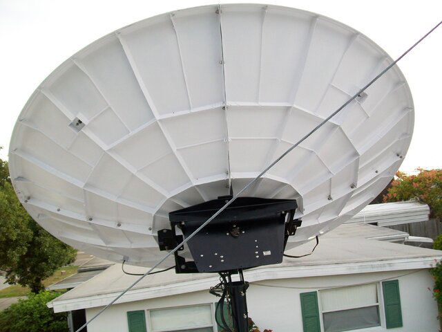

A Birdview mount is a hell of a thing to put a 1.2m dish on, but I was about to post a link to Phlatwound's thread anyway. - :D
It would be difficult to find a stiffer or more rugged motor/mount! - :up
yes I can say Anole "you hit the nail on the head" yes they are built very strong an well built. really they are over built for a 8 1/2 foot dish, I even fab a mount on to a 12-foot Paraclispe an it ran it fine too, but here is a picture of my 10-foot ChannelView on a Birdview mount.
