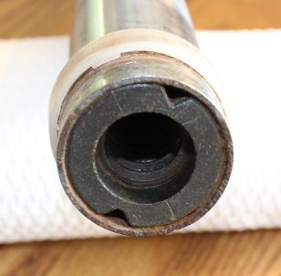

FTAPA,how difficult was it to pull the actuator arm apart? Did the threaded rod just unscrew? The only one (SuperJack) I have attempted to take apart was impossibly rusted tight.
The reason I ask is because I have another SuperJack that I want to disassemble and service before mounting it.

It took a little effort but not too much. I was able to do it by hand. I did give the outside of the tube and the end of the rod a couple light taps first. Yes, the threaded rod just unscrewed once it broke free. Here is a pic of the opening on the smaller tube that the rod screws into (after I cleaned it up). I would have posted it above but max is 20 pics per post. :rolleyes:
