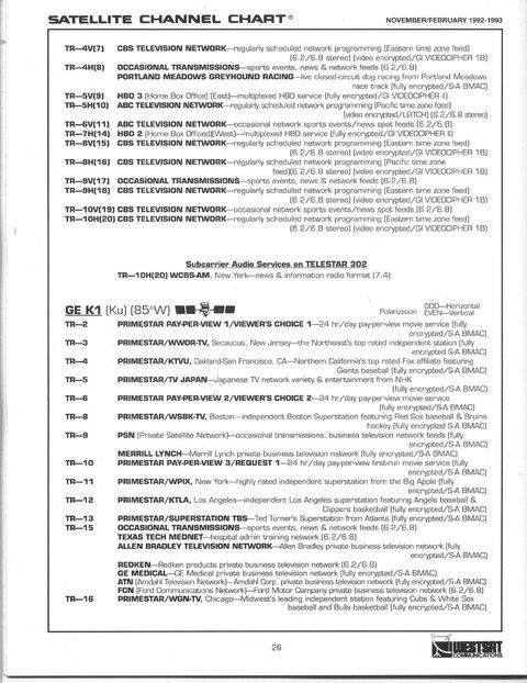

OH, I see, I wasn't reading it right. I see the BMAC footnote now. I was seeing something up near the top that said VC1, but I see now that that was "Viewer's Choice 1", not Video Cipher..... duhh.

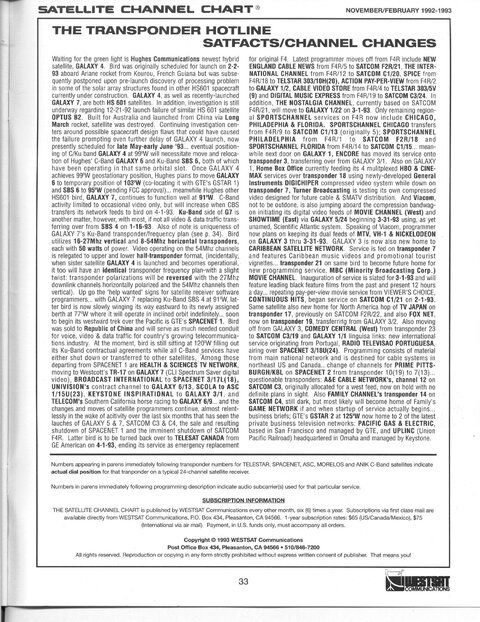

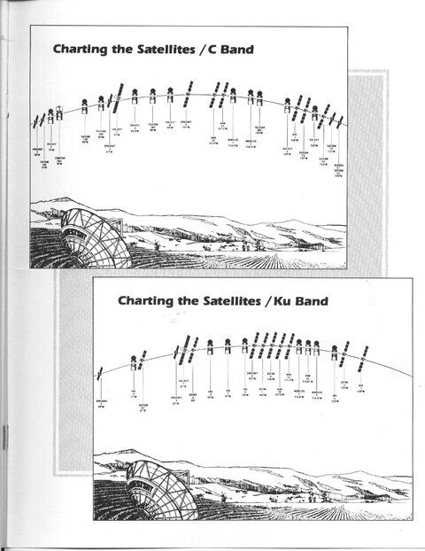

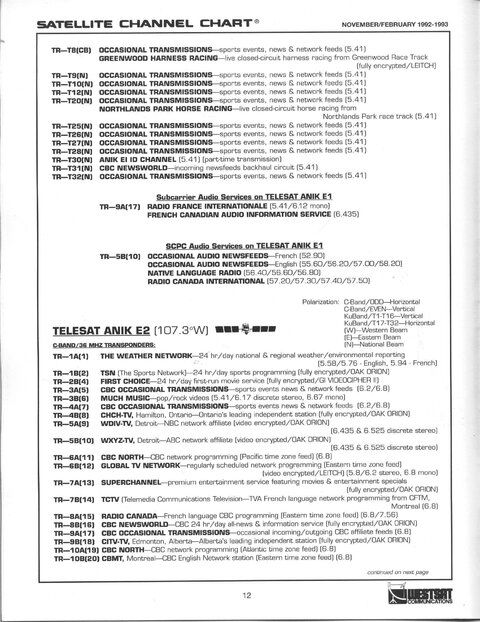

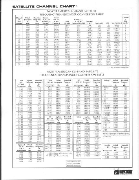

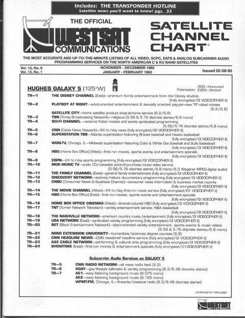

I'll have to scan a couple pages from one of my old Westsat charts. I have several of them from 91 thru 98, plus one commemorative one from 1981. They were really different from most of those programming type charts, as they had info on FM^2 and SCPC audio services as well as the video, and also information on transponders used for corporate purposes, etc, plus full lists of transponder freqs.
I scanned a few pages from the winter 92-93 issue. Scanned the cover, the page with Satcom K1, a page showing SCPC and subcarrier audio entries, a news page, a frequency page, and graphic charts showing the relative positions of the sats. I didn't scan the back page which has a similar graphic chart having both C and Ku on the same chart.
The SCPC freqs may seem strange, but they are based on the fact that many people who listened to SCPC used the so called "70 MHz loop" (some receivers used a different freq, like 140). The 70 MHz loop is a 40 MHz wide band taken from the IF, representing the channel that the receiver is tuned to. So the freqs are in the 50-90 MHz range. I used a receiver that tuned the IF directly, so I had to re-calculate those numbers. I think the numbers in the chart are based on the center of the transponder being 70 MHz.
Most of the 1990's charts are about 30+ pages long. The 1981 version was 1 folded piece of heavy paper, ie 4 pages.
