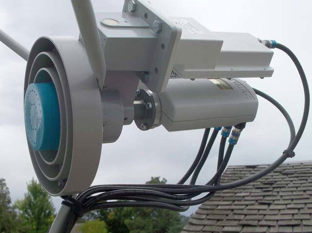

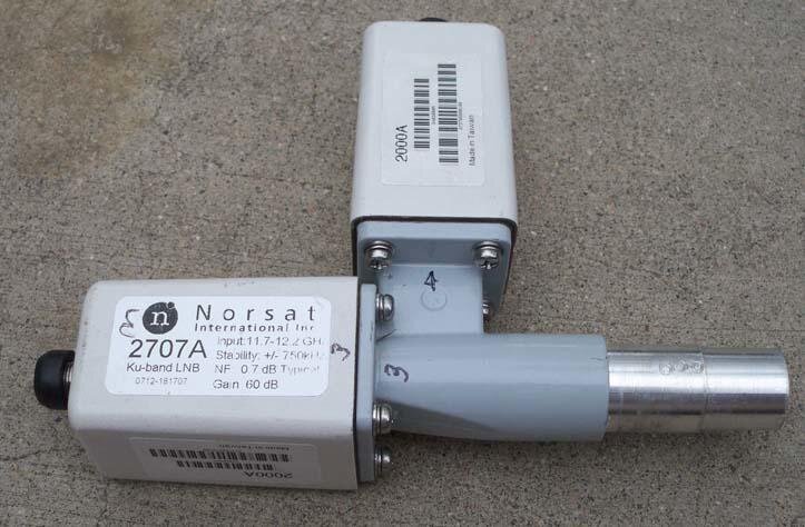

So off with the Ku waveguide and Ku LNB mounts (see first picture). Note on the right side the tubing has three successive diameters; this slides into the back of my ADL RP3-2-2B feed and is held with set screws. The Chaparral Bullseye looks very similar and can likely be similarly modified.

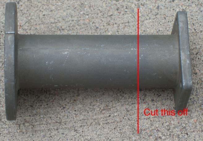

Next came an otherwise useless flange leftover from a Superdish 121 feed assembly (next picture). I had liberated many 119 and 121 feeds from each other with a hacksaw to use the 121 LNBs and feeds on my toroid. That left me with a box of 119 feeds, flanges and LNBs to stare at. The flange is a C120, which is the same used by the Invacom, and the waveguide diameter was only a bit larger than the dual ortho port in the back. Off with its head! (see next picture).
The rest was easy. One can either mill or file the Superdish tube to fit the dual ortho feed. It works best with two steps as in the original Ku waveguide. I was on the roof so a file seemed the more appropriate weapon, and in a couple of minutes everything fit perfectly. Down came the lousy Ku feed holder on the 1.8m (and straight to the sledge-hammer) and up went the Frankenstein dual ortho C/Ku-universal assembly. It performed so well that I pardoned the dual ortho and it became my permanent choice for the 1.8m. The only headache was dragging a total of six coax lines back to the switch matrix from my farthest dish.

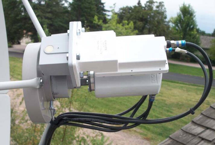

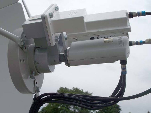

Very interesting solution. Am I correct, you cut a piece of a standard Superdish flange to a calculated length (how calculated?), then inserted the flange into ADL RP3-2-2B feed's Ku-band port, and mounted Invacom Universal Quatro LNB on that flange? How did you fix the flange inside the feedhorn with screws - are they included in the feedhorn assembly? Was your Scalar Ring included with the feedhorn? What makes Norsat C-band LNB better than others in your view?
Yup. The Superdish flange is acting as a waveguide so the length isn't very important. I chose a length that would give easy access to all the components and not cause anything to bump into anything else.

In purely mechanical terms, the QTF-031 fits this application very well. It's small and it hides completely behind the scalar, thus causing no additional shadowing. It does not interfere with the C-band LNBs at all. I'm sure its plastic case is only cosmetic; not that it matters much, but I'd prefer a rugged metal box like the Norsats with the LNB outputs on the back.
The QPF-031 appears to be based on the QPH-031 and therefore probably has a larger case. I have a QPH-031 on my 1.2m and I don't see any reason why the QPF-031 wouldn't work as an alternative to the QTF-031. The C-band LNB mounting on the dual ortho is such that the QPF-031 would simply jut out in the opposite direction. Unlike the QTF-031, it will extend beyond the scalar's shadow (but see below).
Also, your LNBF assembly looks a bit heavy for that dish LNBF support struts set - is it?
The Fortec arms look flimsy, but once bolted to a scalar, they are quite rigid and strong. I previously had a single ortho on this dish and ended up using the same scalar ring for the dual ortho. No doubt the dual ortho is heavier, either with the original Ku waveguide and two LNBs or the QTF-031 (which is lighter than the original). I have a homemade laser jig for aligning C-band feeds and the additional weight had no effect. I've swapped the single and dual orthos in the scalar and they both end up pointing exactly the same without any adjustments.
How big part of the dish surface it shadows?
My single and dual ortho feeds, with or without the mod, essentially only shadow the dish with the scalar ring. This causes a negligible loss, even on a 1.8m. How much is negligible? Well, a 1.8m dish has a surface are of about 2.5 sq meters. A typical scalar ring has a surface area of 0.02 sq meters. Scalar shadowing will cause a loss of only 0.035 dB. Any prime focus dish of this size will suffer at least this same loss because of the scalar, regardless of the feed.
I'm estimating the less than ideal extension of the QPF-031 will occlude an additional 0.008 sq meters, causing a further loss of 0.014 dB. Even a tiny misalignment error, that would require fairly sophisticated instrumentation to measure, will result in a larger loss than this.
