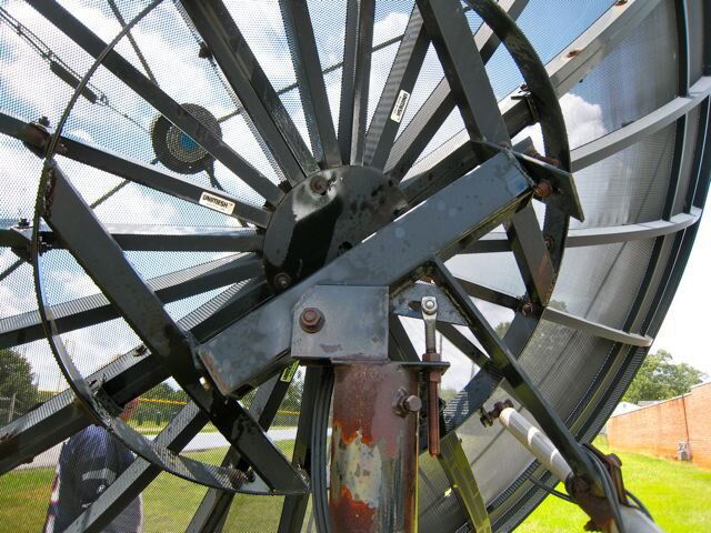

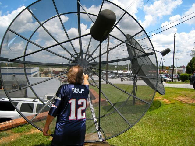

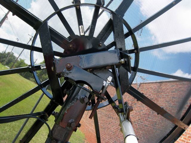

I started taking the dishes down today. Nothing special under the feedhorn covers. The ten footer had a toshiba lnb and the 12 footer had a gardiner lbn both on standard chapperal feeds. The 10 footer is in great shape it pivots fine and the 24 inch I want to say DMJ acuator works fine. The dish moves fine with the actuatordisconnected. The 12 footer has a bad actuator and the dish binds trying to go east of true south. I see a catsalated nut with a cotter pin on the pivot so assume there is a bushing in there that needs replaced. Still fixable and a great find by Dachshound. And like I was told the owner of the store just scrapped a bunch of 10 and 12 foot unimeshes new in the box!

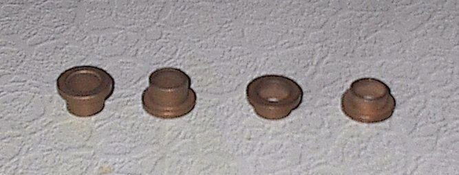

Ya there is a bronze bushing in there. You could even use a larger bolt and a couple fender washers and it will work. (see attached picture)

Ouch :eek: That would have been nice to get our hands on. I have 2 brand new polar mounts for my 12 foot Unimesh. Buried under boxes in my basement. It's a long story how I got them but if I ever took my dish down to move etc I would put a new mount on my reflector.
Thanks for the link Mjac lots of stuff there. But my local NAPA has bushings from stater drives to king pins. I would rather have both pieces there and make a bushing with a perfect fit.No slop wanted, this one is going up perfect.
