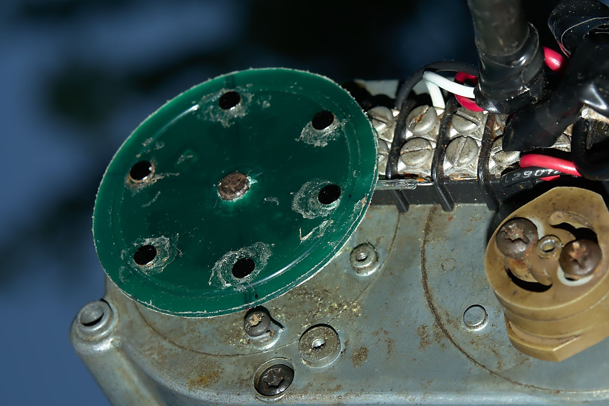

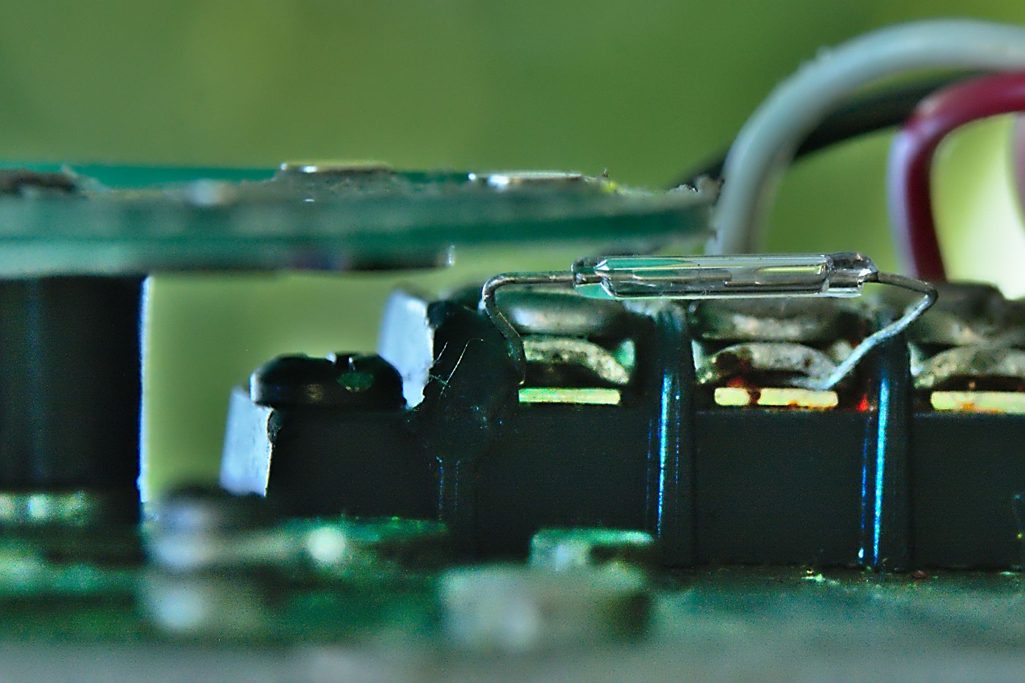

It turns out I was right, it was too early to call. It was still having problems when it warmed up in the daytime. I took the whole sensor board out and made a magnet wheel and used a glass reed switch. I thought and looked at it, and thought some more about how to encase and mount the reed switch. I was over engineering it a bit at that point.
The glass reed switches look like a resistor so I just bent the leads (very carefully) into the right shape to put the ends right under the screws where the sensor wires go. It's bent so it stands out and up under the wheel just right! I used a seasoning salt lid to make the wheel, one of the bigger ones. Just cut the threaded part off and you have a perfect size disc. My Von Weise has the optical wheel and the 1/4 shaft sticks up through it a bit, just enough that I made a hole in the disc and forced it on. I didn't need glue or anything and it's a nice tight fit and holds good. The optical disc braces it a bit too from the bottom.
I used six 3/16" dia. x 1/32" thick N52 magnets from K&J Magnetics. These here: http://www.kjmagnetics.com/proddetail.asp?prod=D301-N52
I glued them on with dollar store rubber cement and they're on there good. I tried slightly larger magnets that were 1/16" thick (N42 & N52) but the switch never opened. They were 1/4" dia. x 1/16" thick D41G-N52's and something a bit smaller than that but the same thickness. The thinner 1/32" ones were just the right strength. I think the width played a big part of this too. N42 & N52 are the strength ratings, the site explains it. There is a lot of cool info there.
The ones I used are very thin and strong and it doesn't miss a count, none, and I haven't had any errors! I linked them above but they are D301-N52's if you look them up by model number. The optical wheel had six slots and six magnets works great. When it was optical I couldn't get it to move by a 1 count, almost never, it'd jump 2 no matter how fast you hit the button. Now it'll count one at a time easily and consistently! Now that I've done it I could make one and install it in a half hour.
It works really good and time will tell if it's missing counts and getting out of sync but I just don't see how it can now. I wish I'd have done this before I ever put it on the dish, it's that good. I have a new Freesat V7 on the way, a new C/Ku LNBF from Brian and a dish that goes where you tell it and I told it to go a few places! :oldmad
I'm guessing the optical sensor was the problem and it didn't crop up until it had been warm for a while. I installed it in the winter and one day it just went goofy. It was hard to pin down the problem. It would fake you out and make you think you had it fixed when it cooled off but then go goofy when it warmed up. When it rained it cooled off and it worked but I thought it was possibly getting water somewhere, took a while to soak in maybe. Nope, it was heat!
I found all of the info about where to get the magnets etc here in the forums. I also read that 10 or 12 magnets really doesn't noticeably help your resolution. It turns out 6 magnets fits and works good and it's so easy to do, I used all hand tools. I cut the disc out of the lid with a pocket knife and used a file to round the edges and smooth them. Then I just made a hole in the center, slightly smaller than the 1/4" shaft.
I used forceps to grip the lead on the reed switches right up next to the glass, very close to it. If you put pressure on the glass while bending the leads you'll break it so use the forceps! Needle nose pliers are not narrow enough to let you get the leads bent the direction you need them to go and have enough lead left to fit under the screws. Grip it tight so it doesn't turn and form it in sort of a U shape so it'll stick out and up at an angle when you put the ends under the screws. Tighten them down and you have it mounted! Once the cover is on it nothing can break the glass and it works great and is easy to change should you ever need to. Glue your magnets on the disc and force it on the shaft and you're good to go!

Ok, here is a couple of photos. By looking at the first photo you can see the leads of the reed switch are under the tabs but I think I'll make another one with some lugs soldered onto them. It's working fine but I don't like the looks of it, looks like it could move and come loose. You can also see that I chipped the glass on the right side of the switch, didn't know that until I seen these closeups.
In the second photo you can see the whole wheel and the mess I made with the glue. I was putting on and removing different size magnets and when it worked I just left it on there. If you glue on the right size to begin with you won't have that mess. Also, you can see that the reed switch is not fully under the magnet wheel but when you have the switch in your hand just holding a magnet close enough to the lead closes the switch. I guess it magnetizes the lead and pulls it closed. Still, I'd rather have the switch directly under the magnets and lugs on the leads would give me more lead length to bend it that direction. But the fact is this works great just the way it is. The photos were taken with a Nikon D7100 and I processed the raw files so that's why they're so good. I reduced them to 2MP from 24MP for file size.
