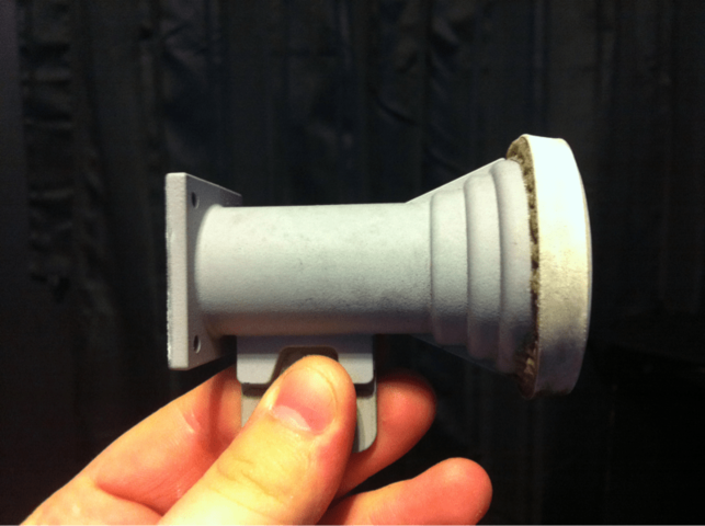

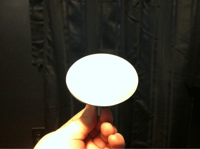

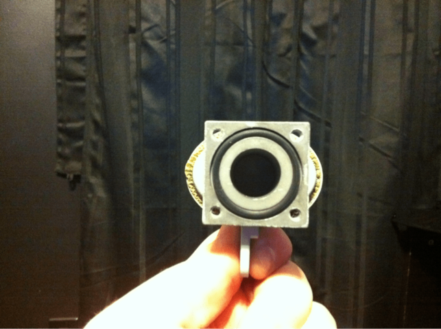

PS: you say the dish is elliptical... look directly into the feedhorn...
Is it round? Elliptical? Could you post a picture?
Cause, if the feed is round, then it treats the dish as round.
1. a round feedhorn will get by, at slightly reduced efficiency, so...
- you could mount any dual or quad output LNBF and try it.
2. you can remove the feed and mount it to another LNB

I know the feedhorn on my DirecWay dish is threaded.
That's a problem, because the DishNet LNB is threaded, too.
So, to mate them, I'd have to simply drill out the feedhorn, and bolt it on.
Not a major project, and probably the worst you'd face.

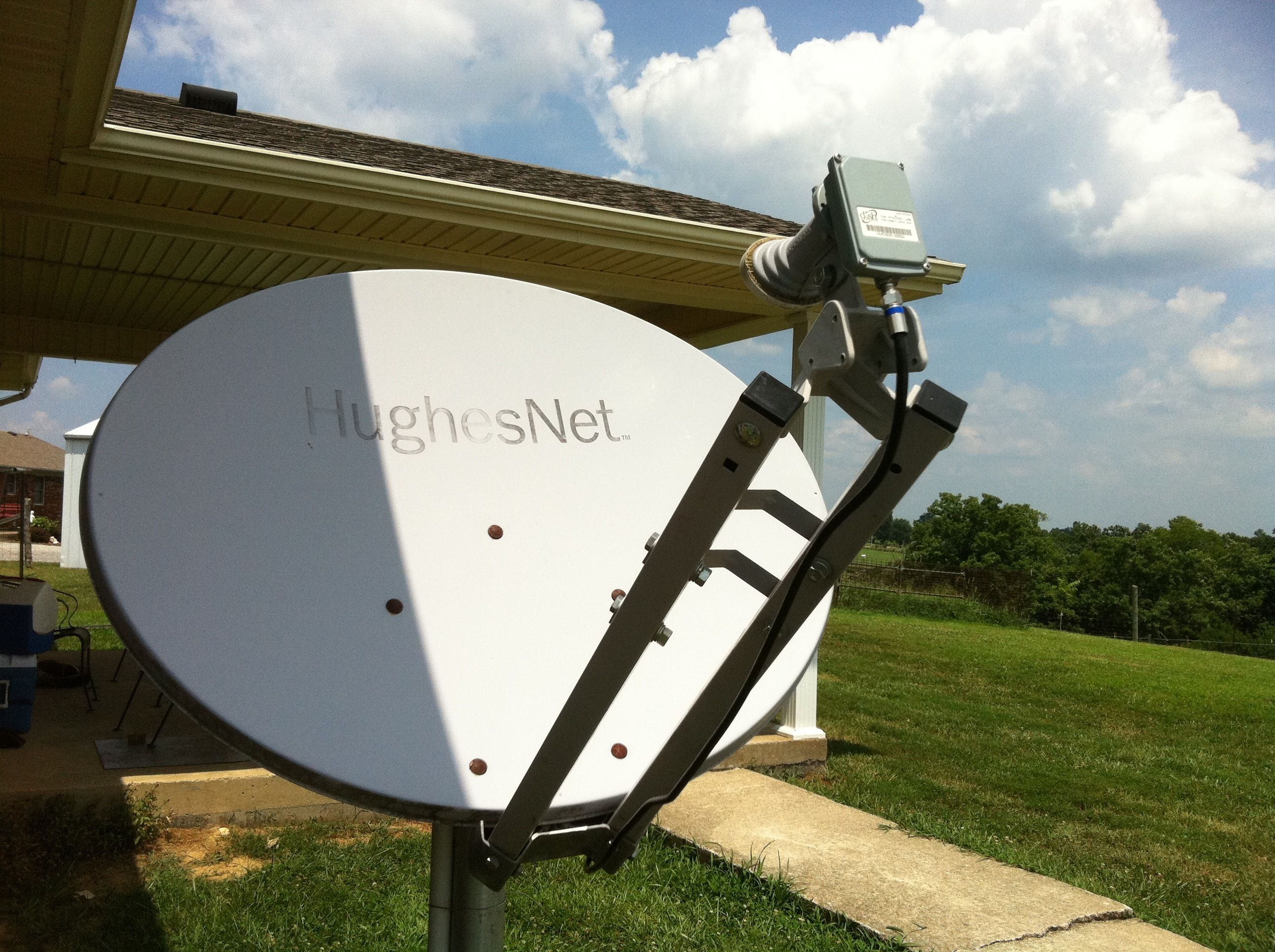

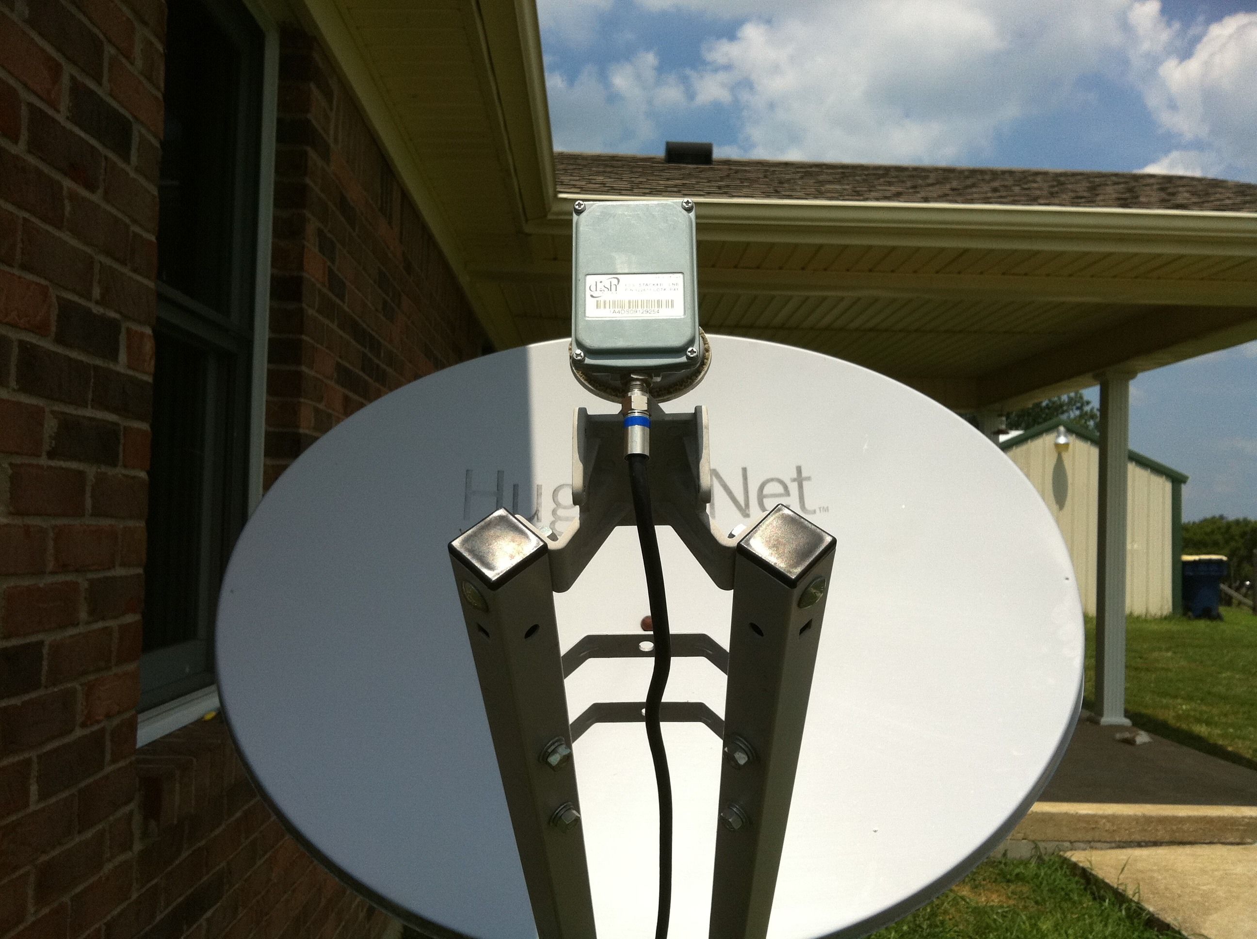

I further inspected the Hughes lnb and it is elliptical but inside the feed it's circular. So my question is does it make the feed a elliptical or circular? If it is circular I'll just get me a dual output lnb and slap that baby on there... Lol

Dishnetwork had provided a dish for awhile, that used a bandstacked lnbf, I think it was used when they had channels on 121W...they still can be found sometimes, elliptical dish with linear (bandstacked) lnbf. As far as I remember , all their other dishes are set up for circular polarized signals.

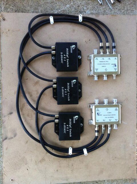

And to answer another question, it kinda depends on what else you have in your dish farm.
But a nice left-over DP-34 switch would work.
Mind=blown! Lol but I'm learning so it's all good. So basically what I'll need to do is feed the cable into the v side of the multiswitch and scan at the specified freqs for h and v? then the receivers will b able to tune both since it only sees them as being v?

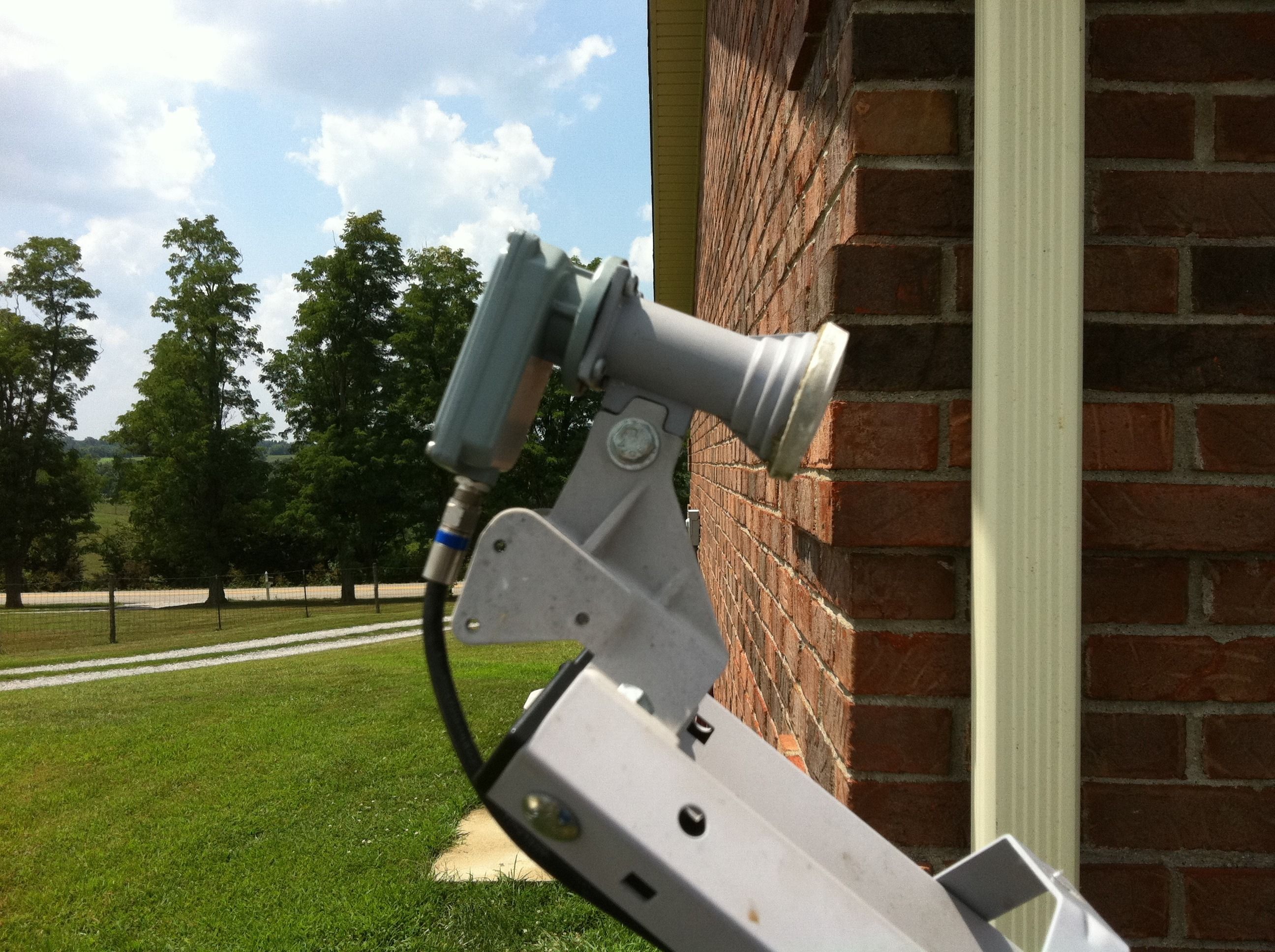

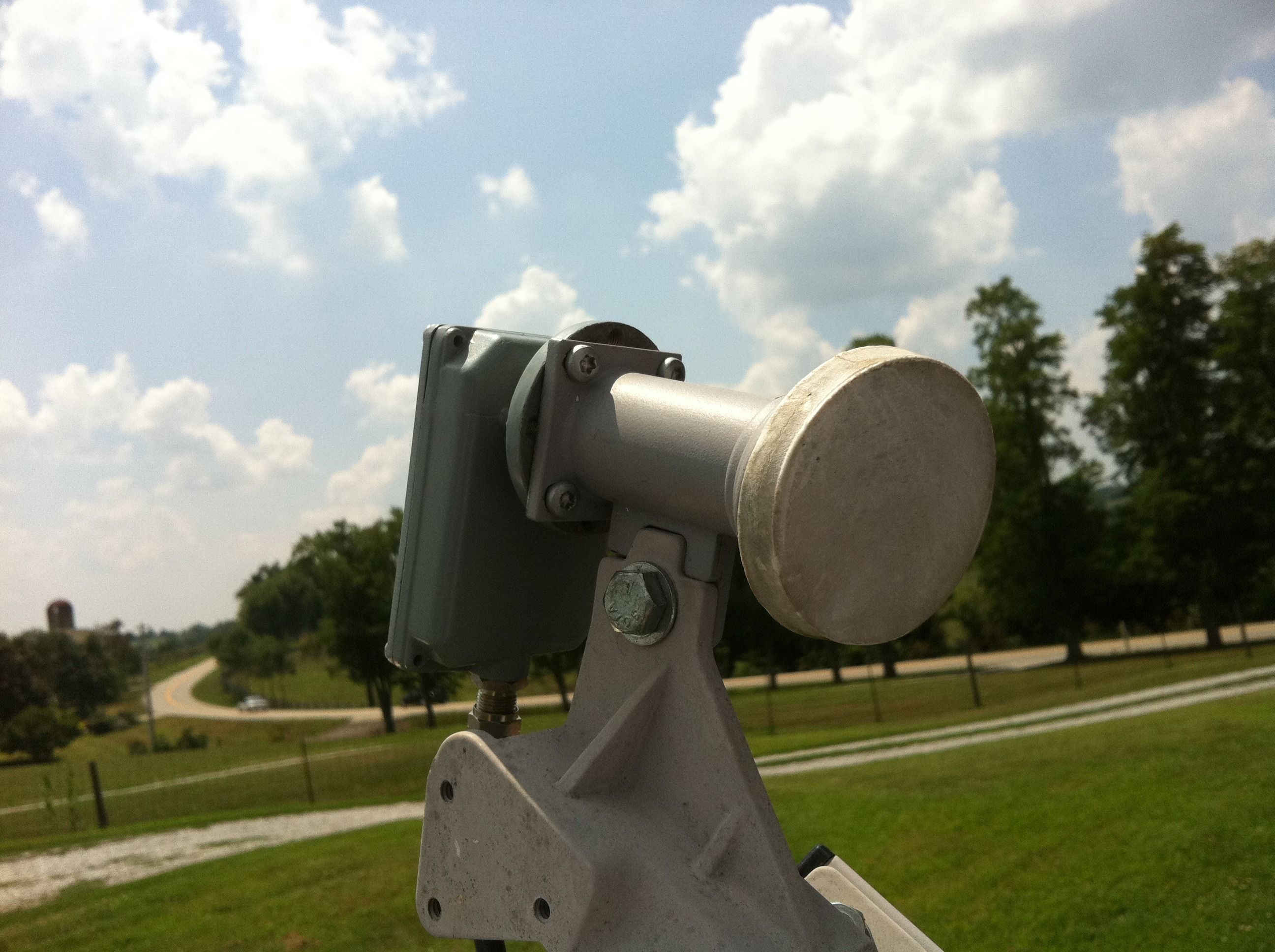

so I got my stacked LNB from turbosat yesterday! got the horn mounted up and on the dish. Seems to be working pretty good so far. I am still getting used to aiming with this lnb though. Seems slightly more difficult than the hughes lnb was but im happy with it! played around with the dish today and yesterday checking out diff sats and i cought my first feeds ever. Really exciting stuff and it just leaves me wanting more. thanks for all your help this far guys! :bow

Lot of those strange two-way dishes float the feedhorn on the parts you need to remove.
Really hard to get it restored to the proper location.
This dish appears to bolt it firmly to the arm/framework. - :up
Congratulations on a job well done!
PS: thanks for the fine pictures, too.
Really adds a lot to a thread, and helps others who may follow in your footsteps.
I do love it! Lol but it's not over yet. Still waiting on my switches from sadoun but so far so good! Thanks for the compliments guys. Haha, makes me feel like my first rodeo was a full ride. :up

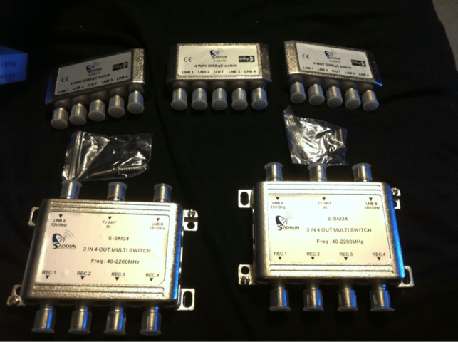

Switches are in and on the board, now to venture under the house and get it up and running... Whoohoo spider time!
