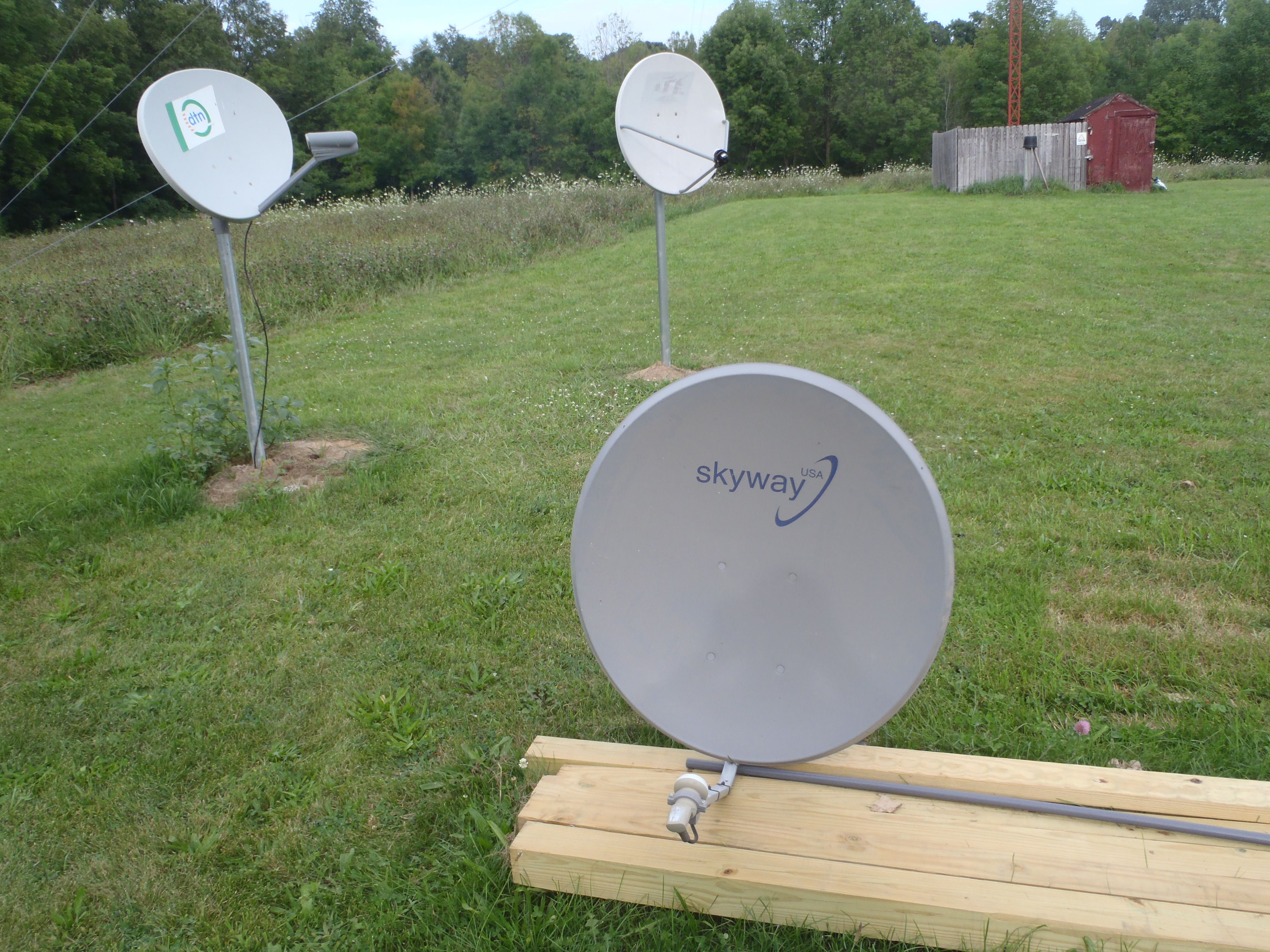

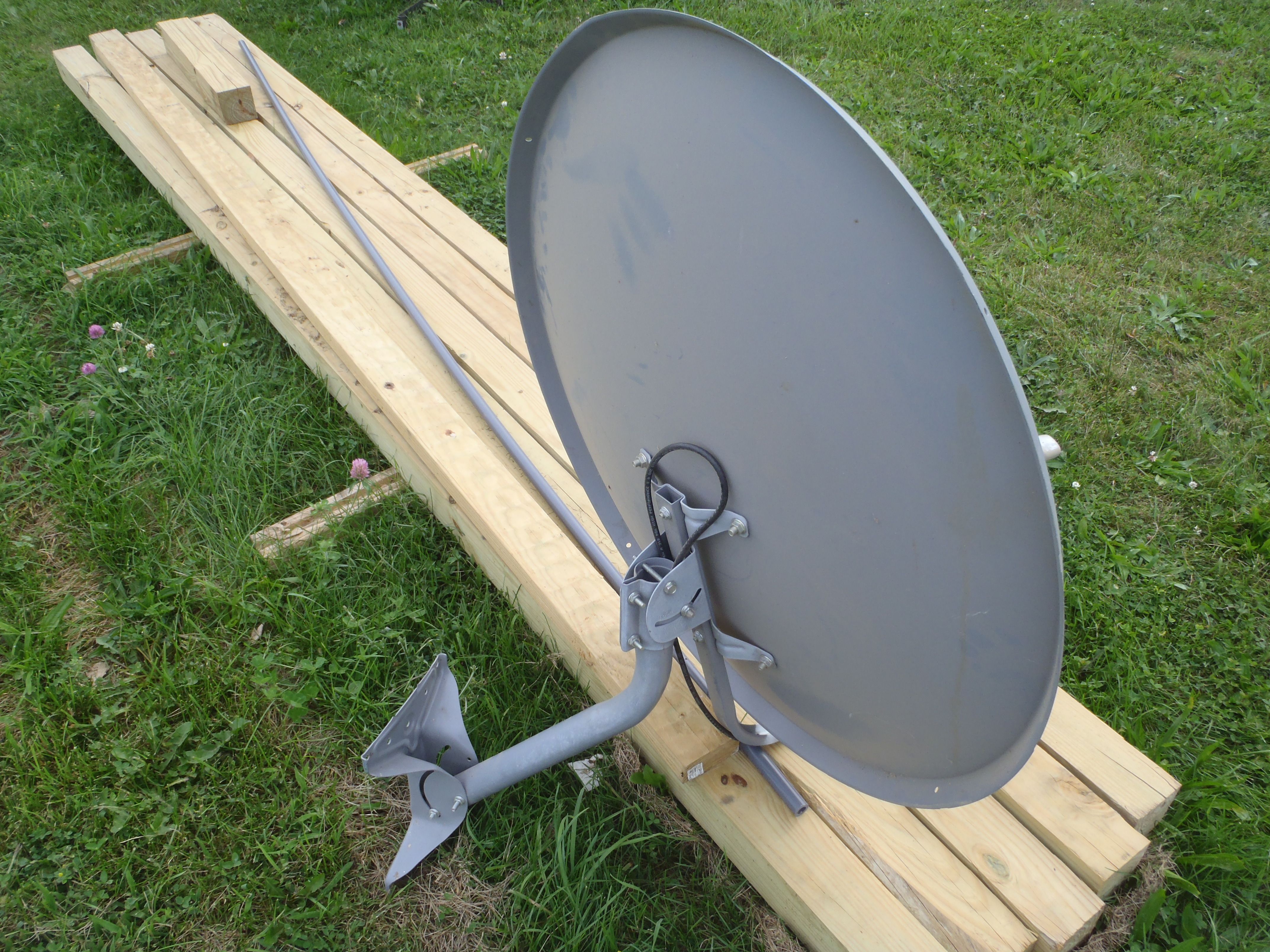

"Scored" this dish for $2 today at a garage sale.
Had never heard of the service, thought it was a programming service, now I see it was satellite
internet service. The dish doesn't have a transmitter on the arm, thus, I wonder if it's already been
used for FTA.....
Would THIS dish or a round .75m DTN (Channel Master) spare I have be better for a first dish for a buddy entering FTA? I want his early experiences with FTA to be good!

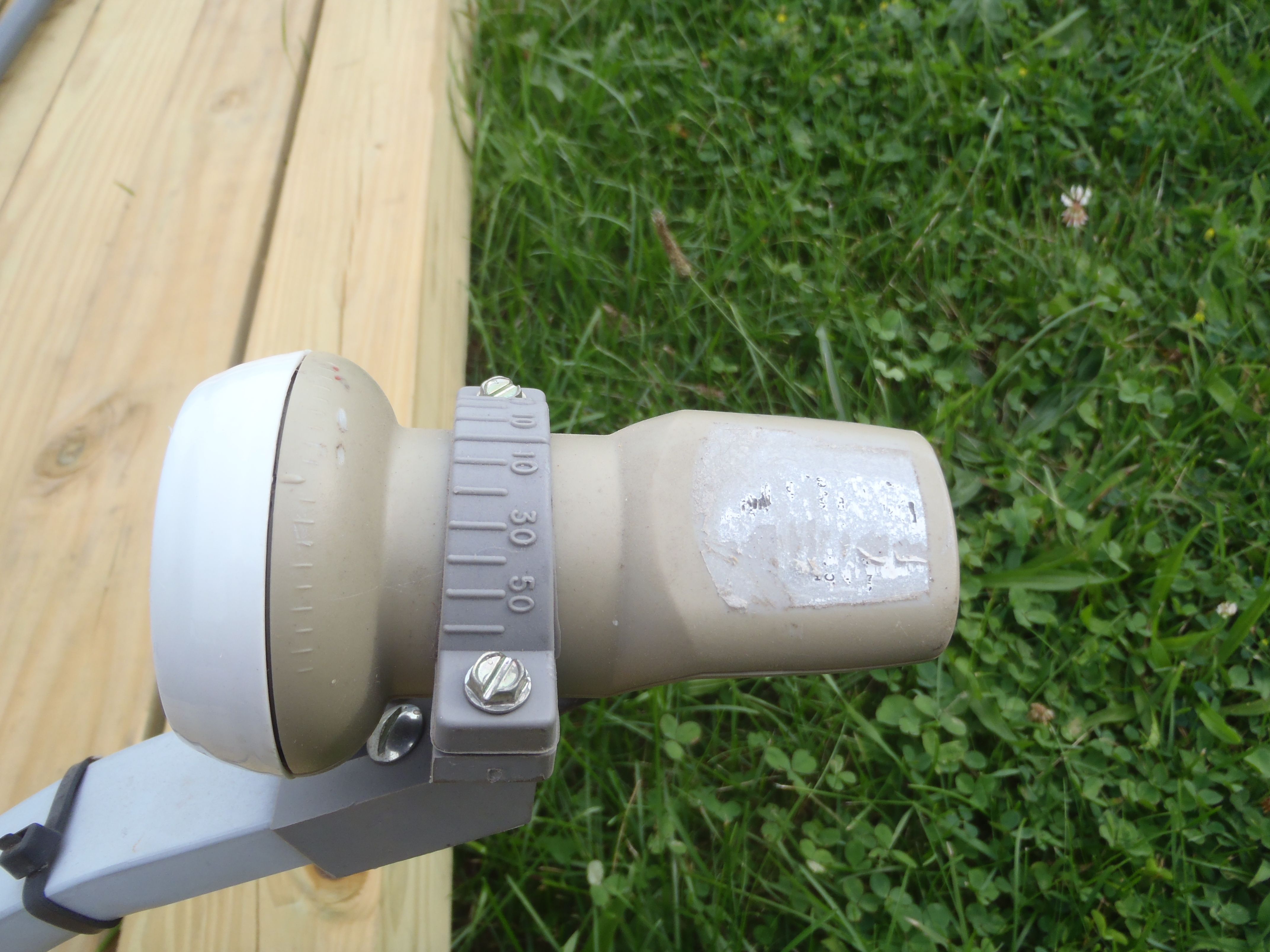

Looks like its an FTA linear LNB on there. Dish will work on KU band but its on the small side. You should have no problems with Galaxy 19 at 97W. Puts out a strong signal and has about 255 channels of very varied programming in many languages.

Agreed on the LNB, it's not original to this, I'd bet.

I don't see anywhere in the thread mention of the actual size for the $2 dish? If it's bigger than the 75 cm, than I'd say that dish would be better, if it's smaller, than use the 75 cm. Same size, either one. That dish looks exactly like one I have here and it's been a good dish, I like the LNB mount better than the ones on my other dishes. Cost me $50 though, not $2! Can't go wrong for $2!:D
I think that will work great without a doubt. It is identical to the winegard ds2076.

Good old skywayUSA based out of Kentucky they tried a Oneway Internet service never really took off speeds were slow and prices were high and had to use a dial modem for your return path. If I recall they got over on echostar for over a million when they shut the doors.
