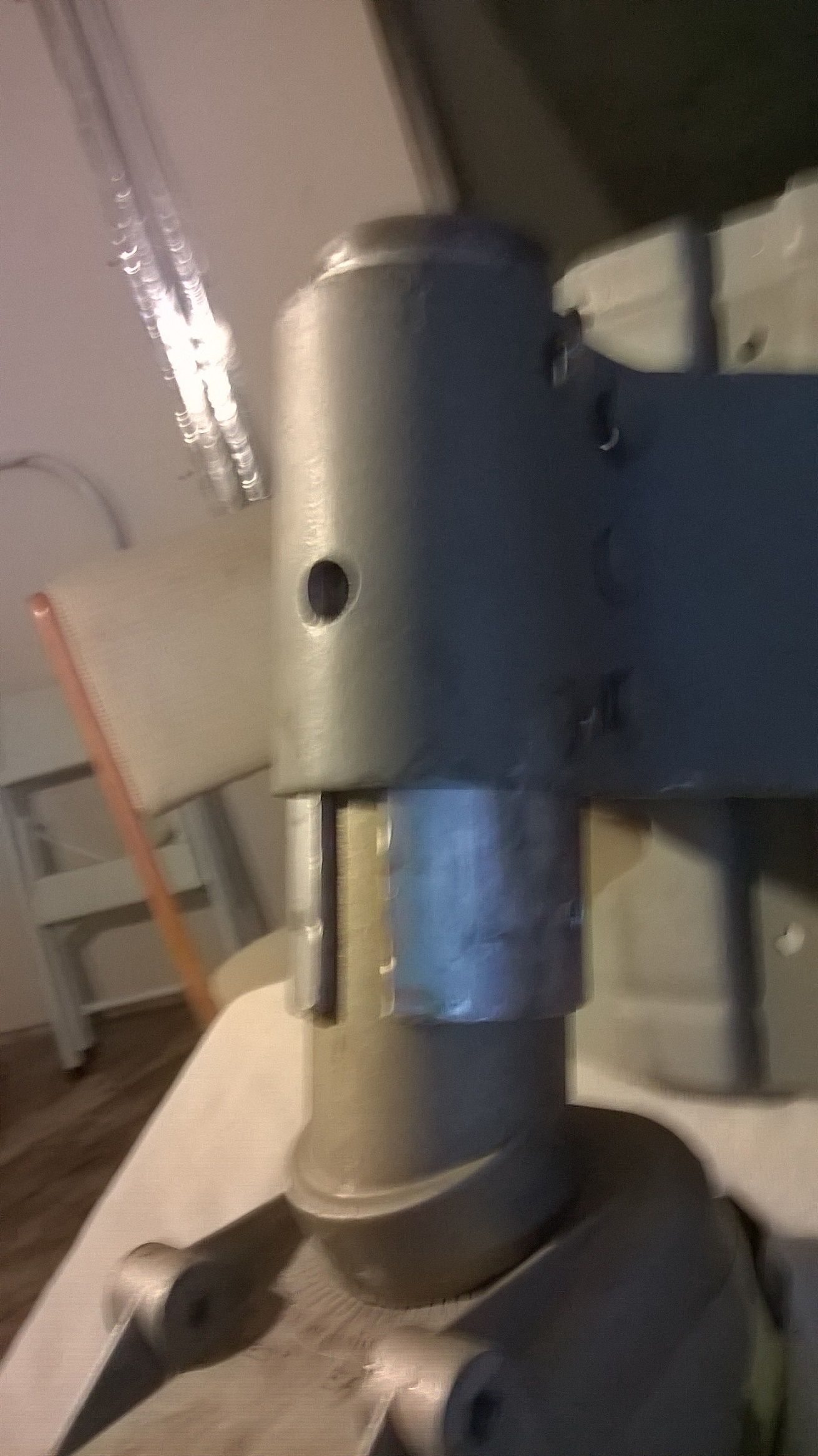

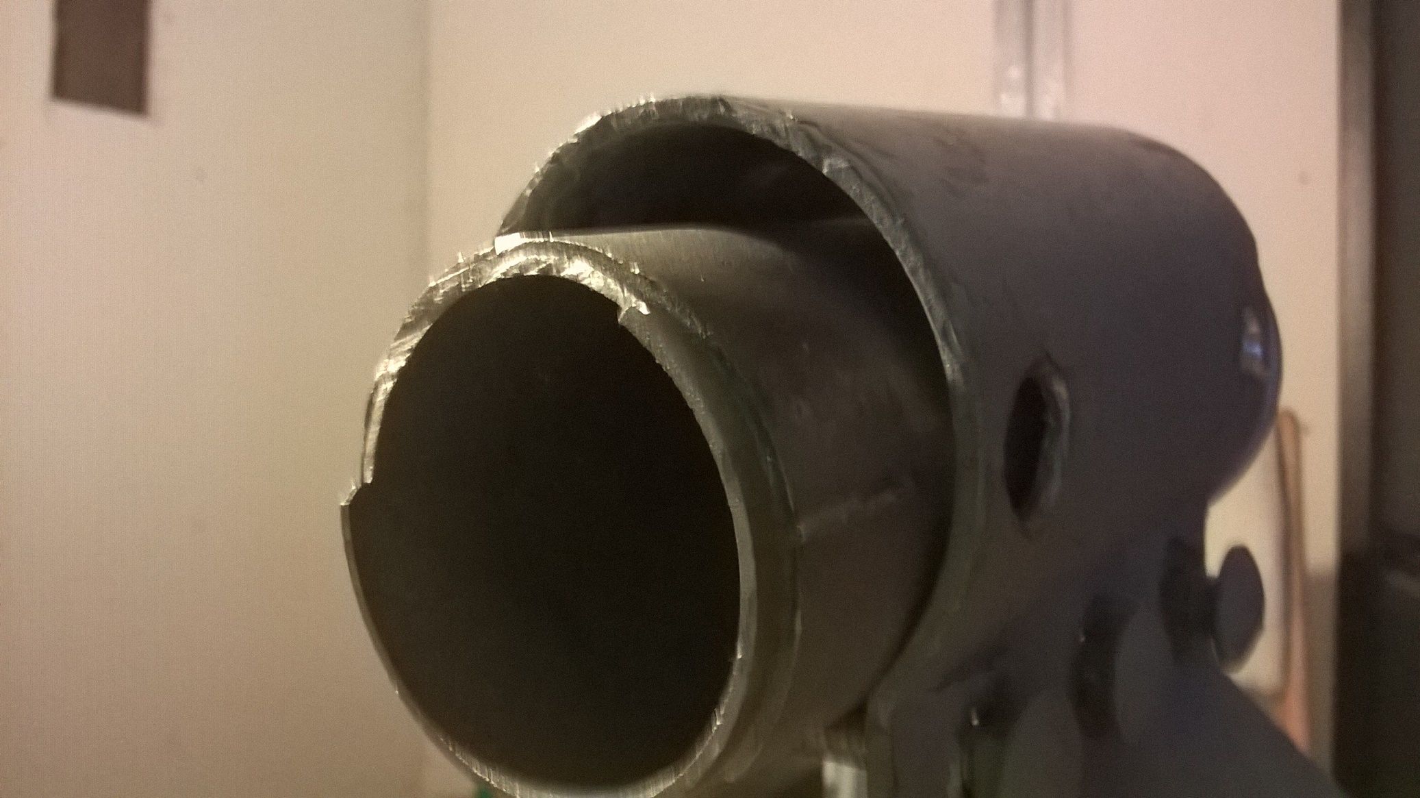

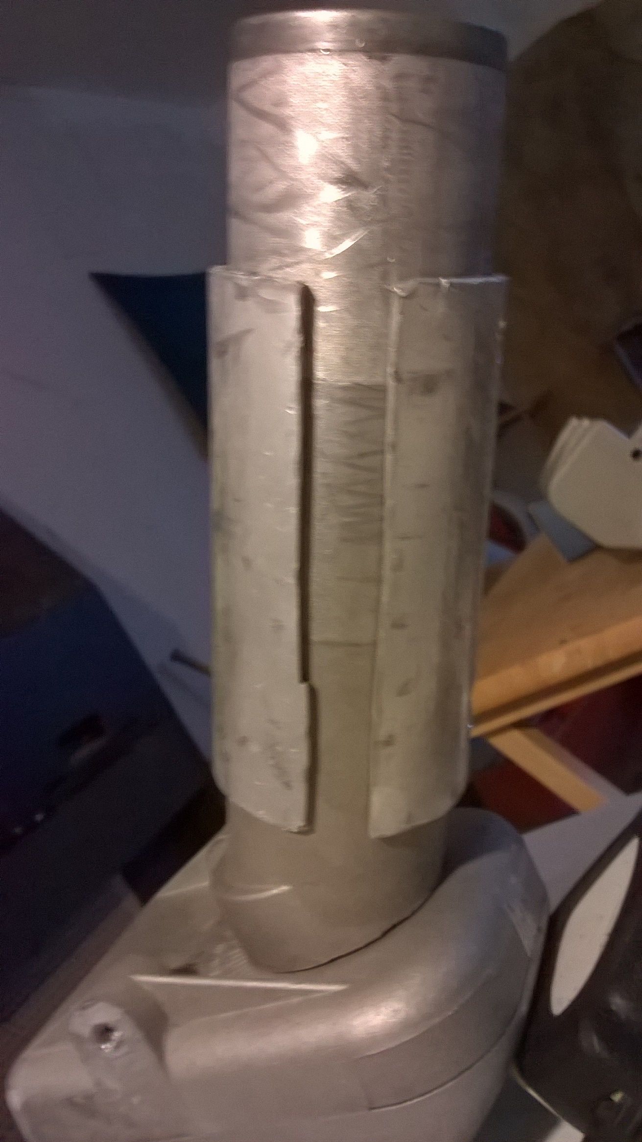

Hi Bluebeard123. There are several important points in your enquiry. I'll do my best to answer them all. I own the Stab HH120 motor & a 39inch Wineguard steel dish. Yes the Stab motors have about the best rock solid build quality of all the motors. I have also owned other brands as well. I would go with the Stab HH120 & a large ku dish.
First ... yes there are issues with the Stab/Wineguard combination. But it depends on which models you have. The issue that everyone talks about is the back mounting bracket on the 39 inch diameter Wineguard steel dish has a larger opening than the shaft diameter of just about every available diseq H-H motor. The bracket opening is 2.25 inches & the diameter of the Stab HH120 motor (plus other make & model available) shaft is 2-1/16 inches. So there is a gap between them. See pic 1 below. So you have to add a "sleeve" of some sort to get them to bolt together tight. You can't have the dish bracket loose on the motor shaft. The sleeve fits over the Stab motor shaft & inside the Wineguard bracket. See pic 2&3 below of the sleeve I made. Its easy to make .... just get a section of pipe & cut out a section down the side so it compresses down to fit over the motor shaft. You could substitute PVC plastic pipe split on both sides in the same manner.
Second ... I think the StabHH120 motor shaft is too big for the smaller 30inch dish brackets. Most people with the smaller 30inch dishes buy the StabHH90 motor which is smaller. Most of us agree the biggest dish you can afford & fit is the best approach for ku-band. Some folks get decent reception with a 30 inch dish but the PBS channels on 125W are hard to get on a 30inch. Plus a bigger dish helps a little with rain fade issues. I would try to get a 36inch or larger dish.

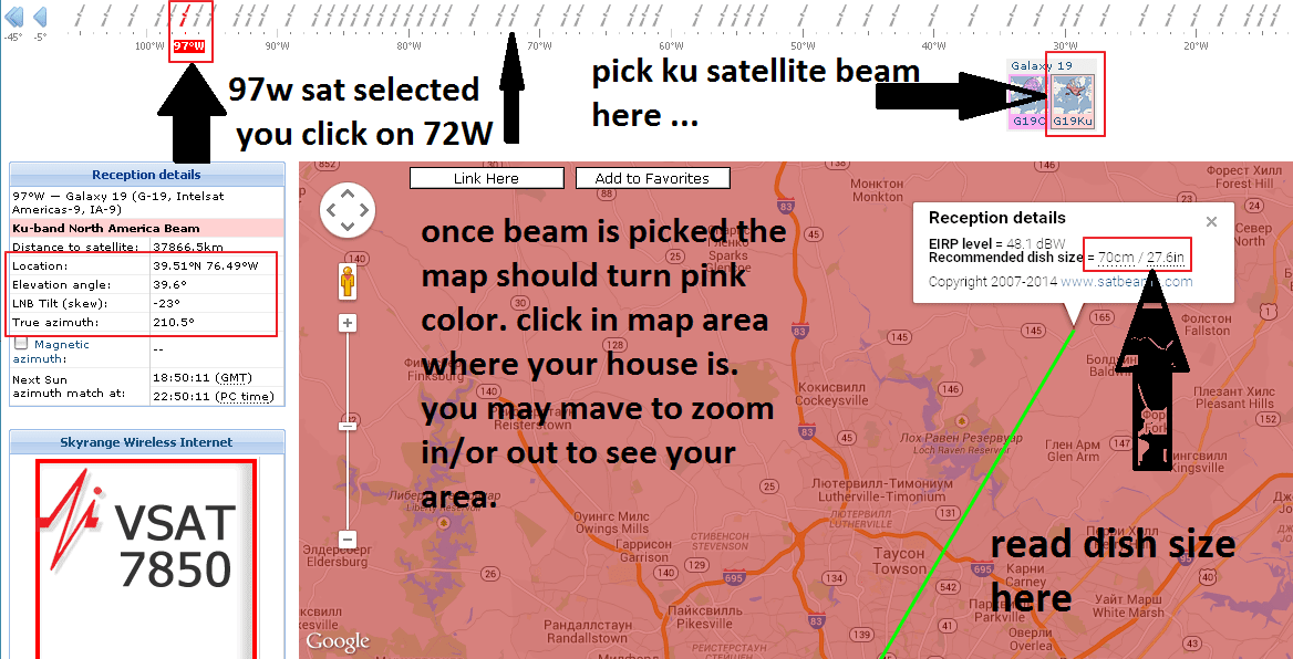

no PBS isn't the only one. ALL the FTA sats are weaker than the DTH sats like Starchoice or Dish or Direct. the 2 networks (Starchoice vs FTA) aren't the same. I know that a 30in dish is fine for receiving DTH sats like Starchoice or Dish or Direct but those sats transmit with WAY WAY more power than the FTA sats. You can't compare DTH reception with a 30in fixed dish to FTA reception on a motor. Its like apples to bananas.
To help you figure the minimum size dish needed go to the satbeams website http://www.satbeams.com/footprints you pick the sat you want (say 72w) from the row of sats on the top. then the beams for that sat come up. click on the ku band north America beam. then a map comes up showing the sat footprint. then move the cursor (I think its a little white hand) on the map to where your house is & I think it gives you the MINIMUM size dish needed. then repeat for the other sats. that should tell you if a 30in is okay. but those size calculations are based on absolutely perfect conditions all-around (& there are a lot of variables) so be warned.

Its the 31" Wineguard DS2076 which does not work with the Stab 90HH motor. The problem is the mounting hardware on the dish limits the full range of elevation adjustment when mounted on the Stab. So depending on your latitude it may or may not work.

Great Info, I went to that site, but I cannot find where you input ku or where it tells you what size sat you need. I live north of Lake Tahoe in CA. It sounds like the bigger the better. Any particular brand/combo I should consider?
Pick your sat from the line of sats at the top,then under that line a box appears with the name of the sat with a choice of C or Ku maps,choose a map then click on the map where you are and dish info will appear.

hey bud. I think before we decide on a combo we should decide on what size dish you need. Lets not get ahead of ourselves. below is a recent picture of what satbeams should look like (thanks very much borisov-54 :)) I couldn't show you a picture cause mine isn't working. I've modified the picture to drawn in where to pick the sat & where to pick the sat beam & where to read the dish size.
If satbeams is working for you follow the instructions on the picture below. Then repeat instructions for each sat you want to check dish size. Once you've figured out the dish size report it back here in this thread then we can move forward to pick a combo.

How do you get it to show the reception details? All it shows me in the little white box is www.satbeams.com
Actually over on the left side it shows azimuth, elevation, sat location, distance, but it doesn't show anything regarding dish size.
When you zoom in on the map and then click on your location a box should pop up showing EIRP and dish size required.
When I click on the location of my satellite the box that pops up says:
"Copyright 2007-2014 www.satbeams.com" and that is it. There are no recommended sat sizes. If I click on that box, then I get a field to send an email to the satbeams people. I am using Firefox. Maybe something is wrong with my set up.

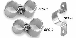

To hang a Winegard DS-2076 on a STAB HH90, use two SPC-1 clamps to offset a 1 5/8" stub post and provide clearance for the declination setting. :)
