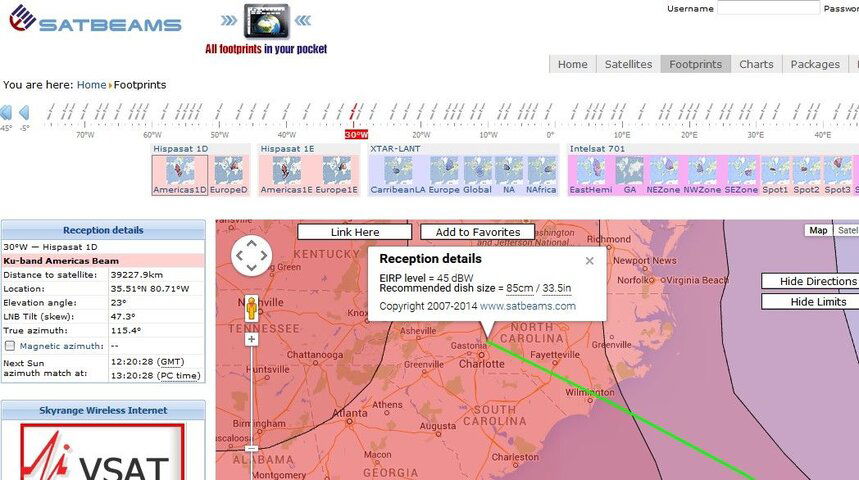

To use satbeams fully you have to have mug like this IMG_20150220_235149 (Large).jpg
or go to direct link to satellite footprints and look for your location :shh and it does not matter what browser you are using. And when you click on your location additional window will appear to show you some additional information including recommended dish size. ScreenHunter_186 Feb. 21 20.24.jpg

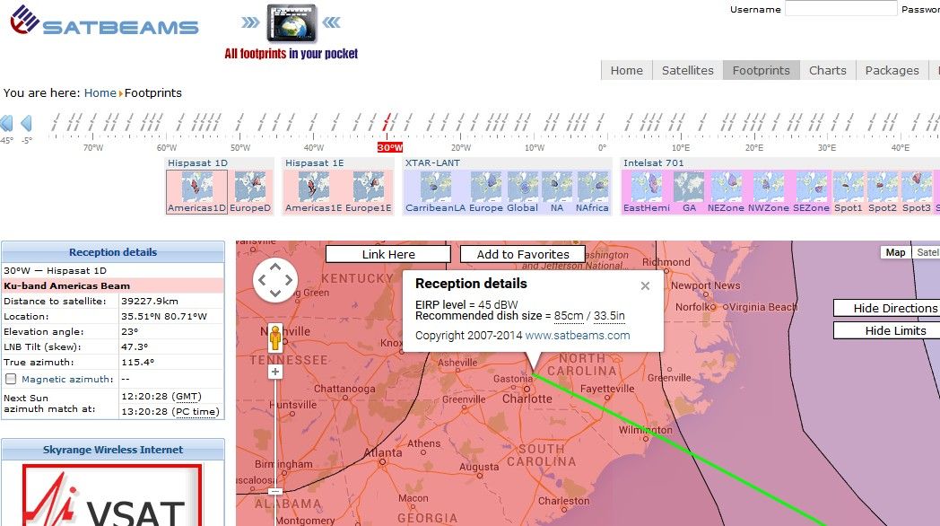

Attached is all I see. If I click on the box, I get an email form that sends an email to the site admin. It has to be because I don't have the coffee cup

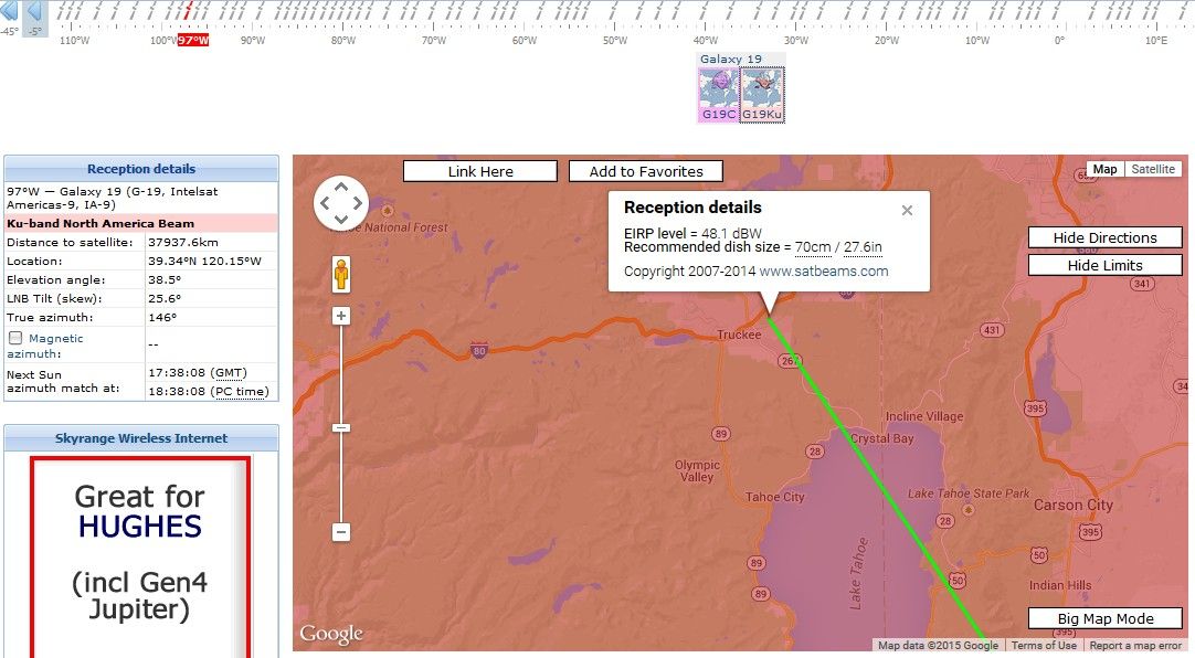

I see that according to data you need at least 70cm dish.

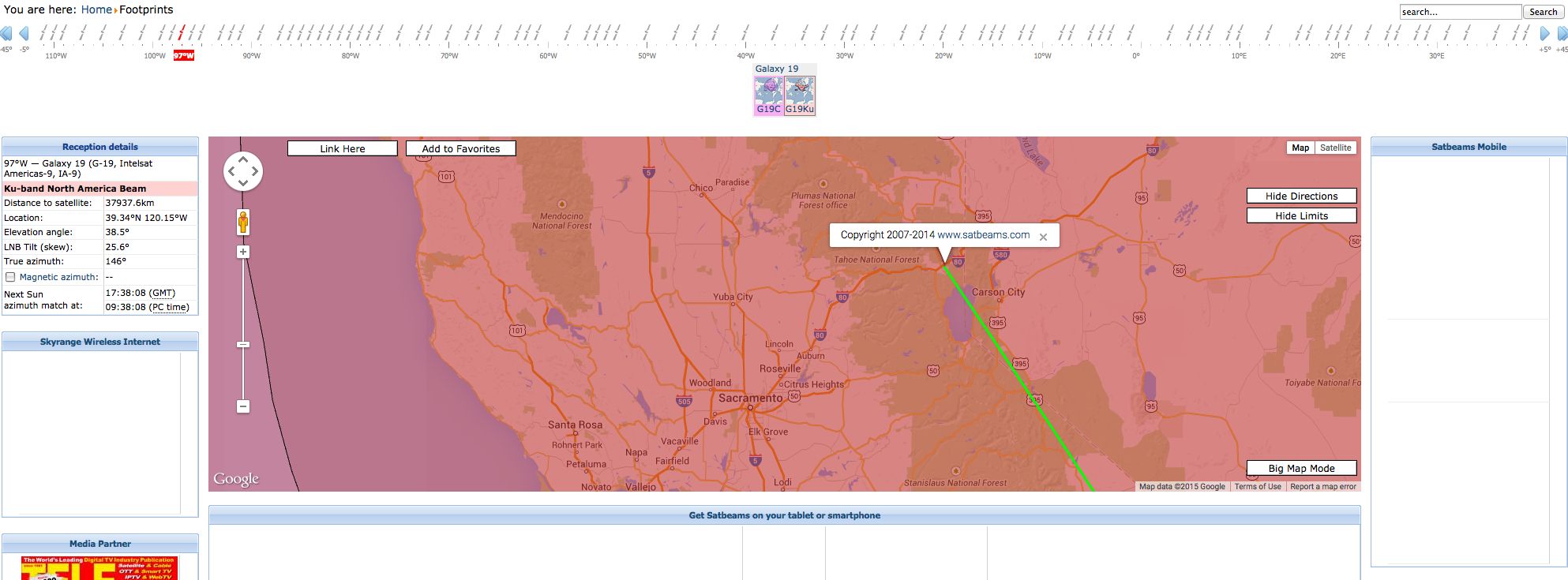

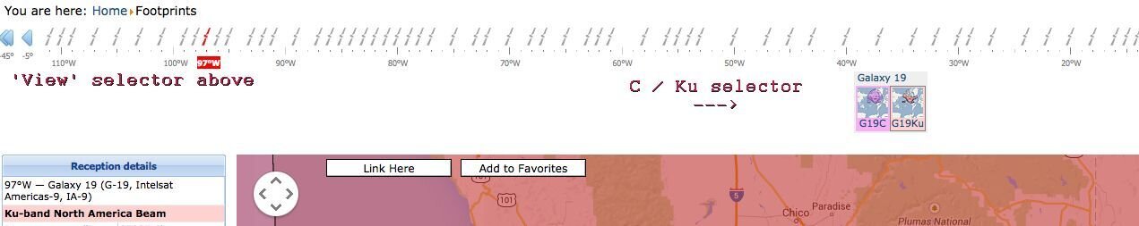

Satbeams - I've had to open a different satellite link in another tab for them to work. Changing the 'view' 5 or 45 degrees works OK. That's been the norm for a couple of years using chrome or firefox. C or Ku selection links work OK, they are just above the map. (Small 'icons' of the related map)

3. Clipboard01.jpg changing the view 5 or 45 degrees E or W.
