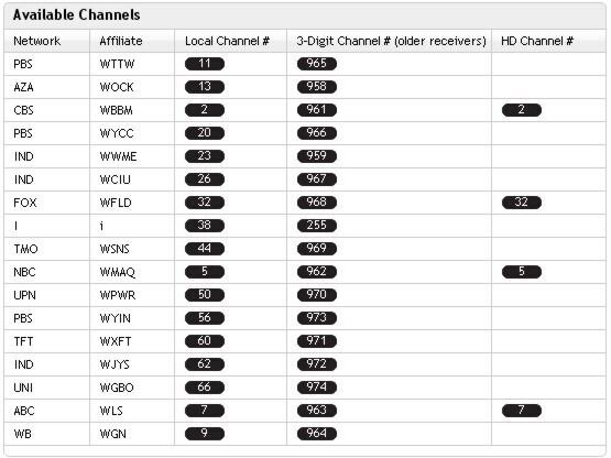

If you live in a MPEG4 HD locals area you will get:
1. The NBC, CBS, FOX, ABC HD locals for sure (some are saying something about WB and/or UPN in their areas ???) via the dish.
2. ALL your locals in SD via the dish.
3. ALL of the digital OTA (depending on your antenna and how correctly it is setup) I wouldn't recommend the suppied antenna, but getting your own.
