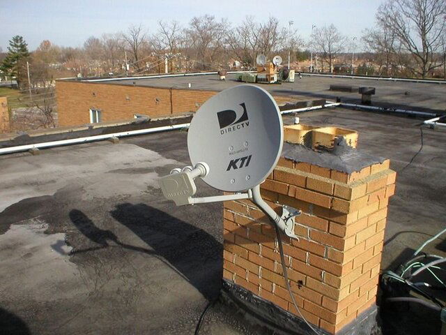

Below is a thumbnail of my dish on the rooftop:

May be a dumb question, but did you check the cable lines from the dish to the reciever? I've seen other installers go to apartments and figure that the existing dish was'nt being used and just ran cables from the ground block to the the new location instead of installing a new dish. Dumb, but true.

In a last ditch effort, I climbed to the roof to triple-check the alignment of the satellite dish. As I mentioned earlier, the dish was still securely in position with absoultey no play. It had been professionally installed. I visually checked the elevation and tilt settings and they were very close to the required configurations.
The tilt was dead on at 62 degrees. I didn't touch that. The elevation was a bit trickier. The gauge on one side of the LNB Arm/Antenna Back Assembly had a different measurement than the gauge on the other side. Both measurements were about 2 to 4 degrees off of recommended elevation. I loosened the bolts and moved the gauge measurement to the recommended 34 degrees. So, it registered correct on one side of the back assembly, but was a little off on the other side.
I went to Wal-Mart and bought a compass that had azimuth indicator. It was a bit difficult to figure out the exact azimuth of the dish. My best guess was that the dish was off maybe 15 degrees or so. I had a friend stand on the roof with a cell phone to adjust the azimuth. I called him and reported back the level of signal strength that I was seeing on the televison.
He moved the azimuth and a satellite signal was detected. The signal varied and wasn't detected on Sat B (119) trans. 23-31. He was getting really cold on the roof, so I figured we should switch postions and would try my hand with the azimuth. He came inside and I went to the roof. It took about 10 minutes to switch positions. By the time I made it to the roof, he indicated to me via cell phone that the signal was now coming in loud and clear. I waited for the entire system to get synced up (which it did successfully) and came back inside. Everything appeared normal.
So, my signal has returned. I needed to adjust the dish. I'm very confident that the dish wasn't disturbed by anything because it was very securely in place on the roof. I'm guessing that maybe the original installation was incorrectly done and the dish was set at the wrong coordinates. Perhaps the satellites position in space changed very slightly and didn't affect those dishes that were aligned correctly, but only affected those dishes that were "barely" configured correctly. I don't know for sure. That's my best guess. I just can't belive that anything (man, animal, wind) knocked my dish out of whack because roof access is very tough to get. The dish also has a very clear unobstructed view of the Southern sky. So nothing grew or was built to obstruct the signal.
