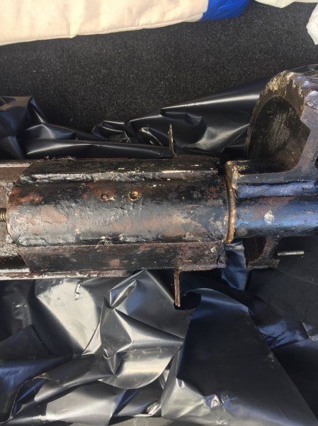

I hit it today with everything I had and could not get it. On my way to a mechanic to see if they could bang it out

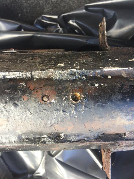

The mechanic could not help but I saw a pin on top? Do I need to remove it to be able to take the shaft out?
there isn't a pin I know of. It looks like you have two holes for a grease zerk. One is drilled through the nylon bushing. My first AJAK was abused before I got it and it showed the grease zerk had been installed as an after thought. You could see on the shaft where the drill bit hit it.
You might stick that whole thing in a 5 gal bucket of diesel fuel and let it soak for a few days or a week and then give it a whack.
And I would try to get the shaft to just rotate back and forth some before trying to hammer it straight out.
