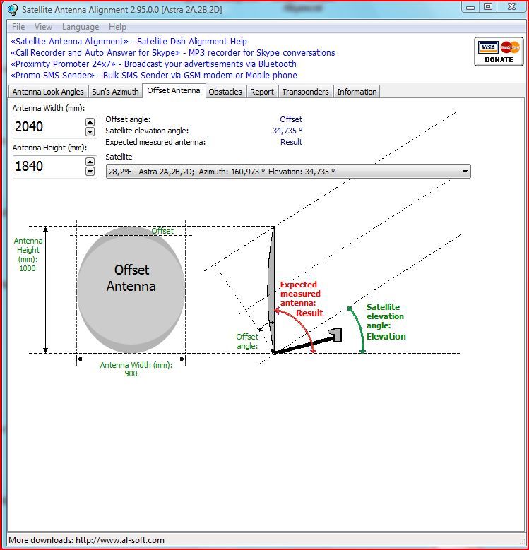

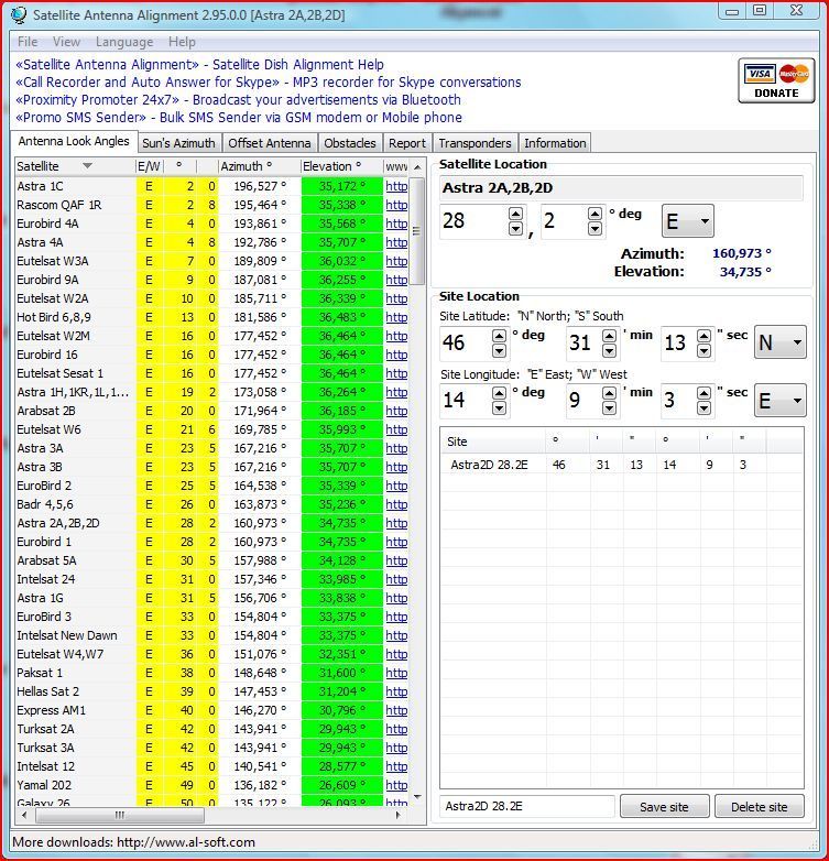

Astra 2A,2B,2D LookUpAngles.JPGAstra 2A,2B,2D Offset Antenna.JPGAstra 2A,2B,2D SunAzim.JPG
I reading that correctly.
Yep! And if a satellite is not at zenith, find it's azimuth, then refer to the sun azimuth table for the time the azimuth is closest. align dish to the sun at that time. Bingo.
Although the sun is above the satellite during summer months, the suns shadow won't appear on the dish itself, only on the lower support arm.

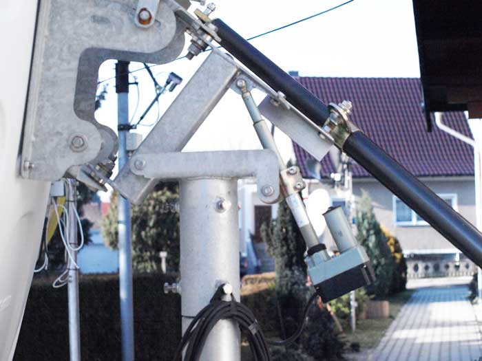

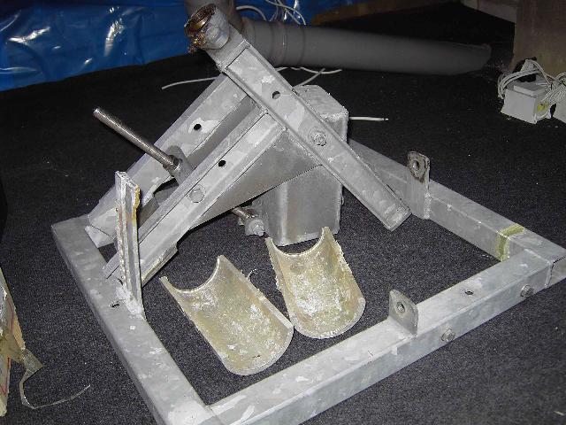

I have added a couple of pics of polarmounts i have found and mine as well, i am sure I canalter my to suit using some parts as the dish fixing,the pole mount and the threaded adjuster can be adapted. When I have something construction, a new can of worms will be opened.

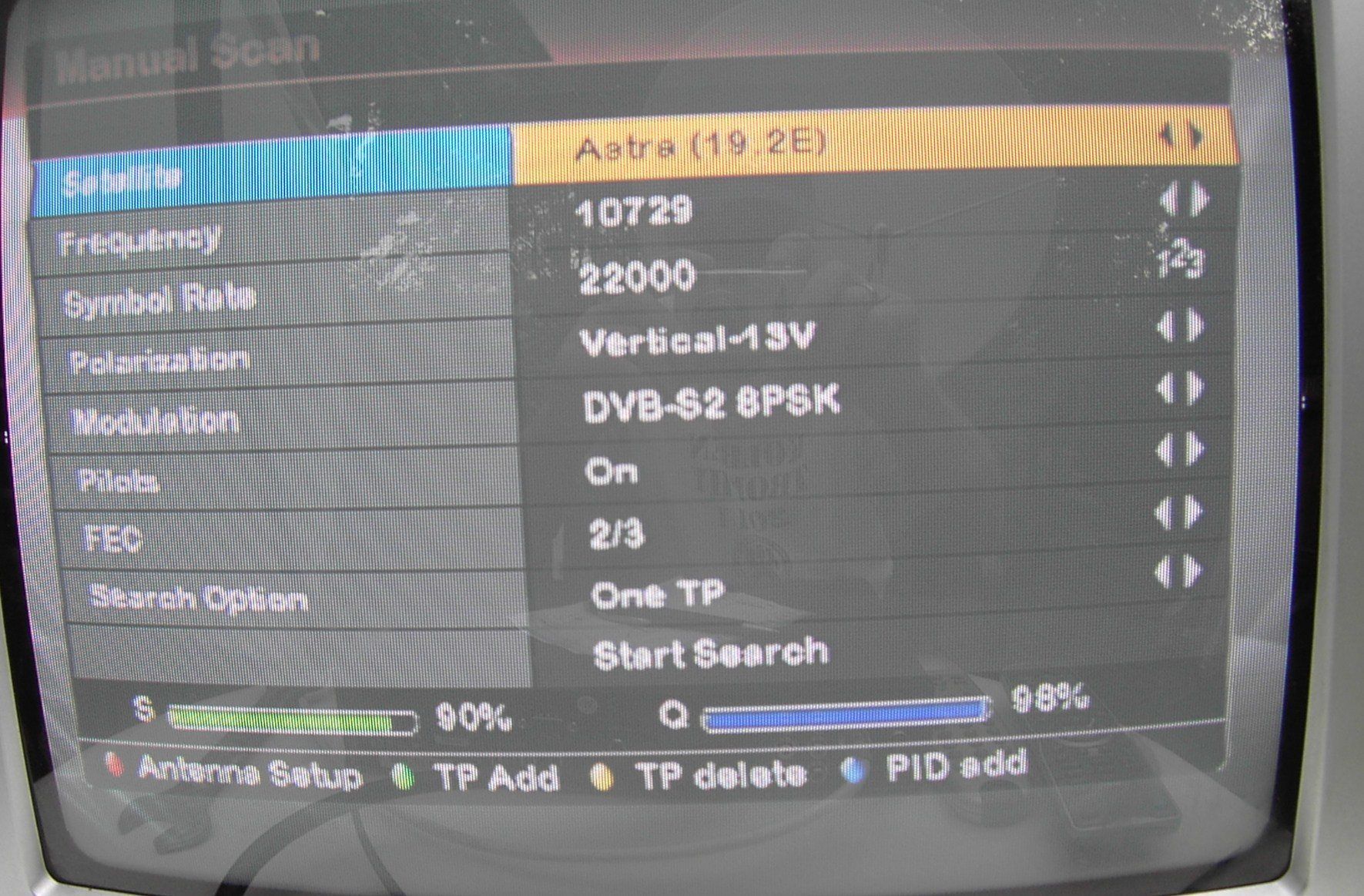

When I connected my spiderbox by the dish, instead of 28.2 Astra it was 19.2 astra,. the old box is for nothing.
Didnt catch the sun at due south, so using 19.2 as datum point. I measured the circ. of my pole 286mm. so to move 9° more eastwards I needed to swing the dish 7.15mm east to get 28.2.

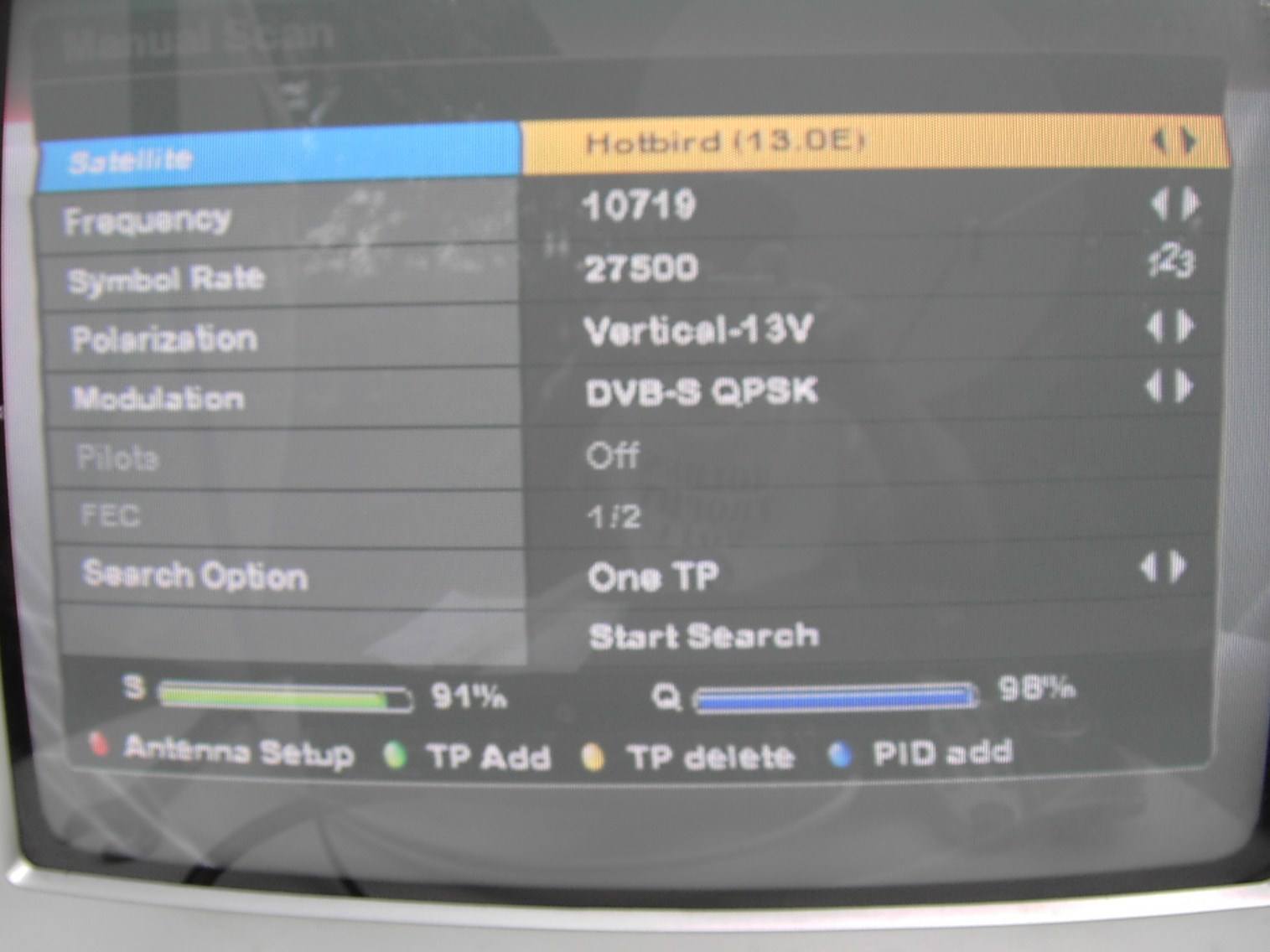

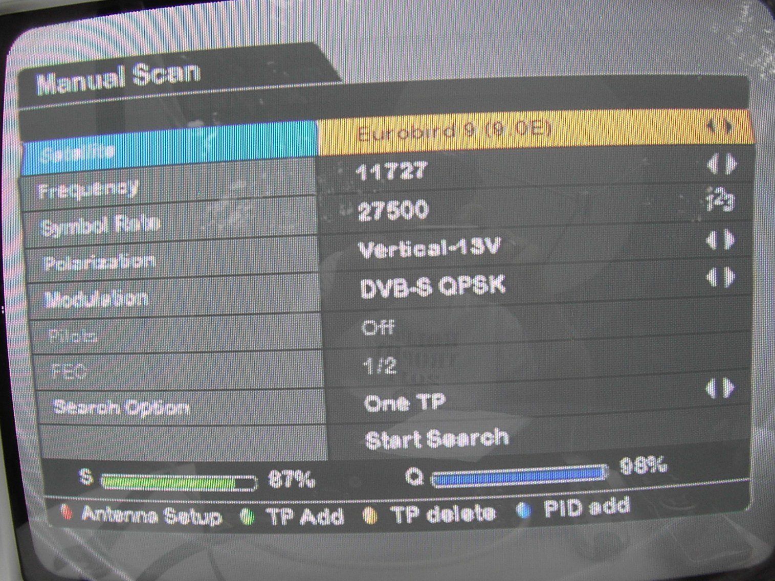

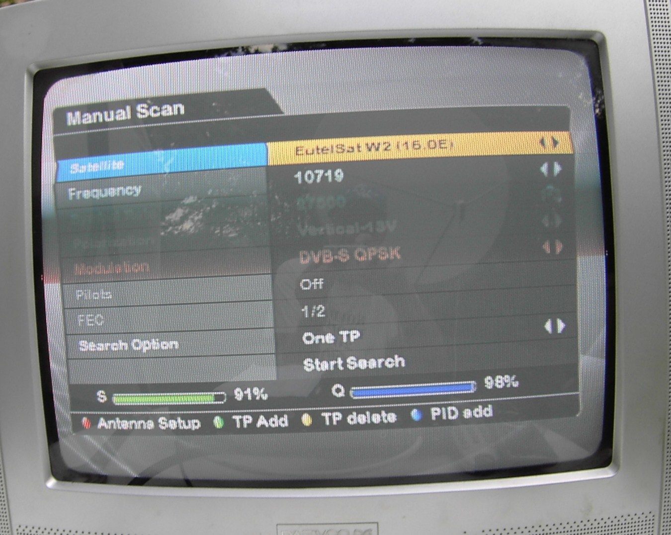

I couldnt get a signal so tried some others, some came (all reading 98%) but some I couldnt get.
I then thought this is the arc that is why a polar mount must be used but I saw one anomally which was eurobird9 which I also had a 98%. Here is a list of the sats I experimented with before it rained again.
Astra 1D 28.2° El. 34.735° Also Eurobird 1 same figures.
Astra 1 19.2° 36.264°
EutelSatW2 16.0° 36.464°
Hotbird 13.0° 36.483°
EutelSatW1 10.0° 36.339°
Eurobird 9 9.0° 36.255°
EutelSatW3 7.0° 36.032°
If the arc of the satellites is the explanation then why could i get eurobird9 but not eutelsatW1?

I threw together a picture to hopefully explain the angles involving an offset dish on a polar mount. See Attached:
Example (Angles measured at 'due south") :
Location is 47° North. Offset angle of dish = 24°
From the chart* the Elevation angle** (modified polar axis angle) is 47.65°
The Declination offset angle from chart" is 6.38°
Dish face = 24° + 6.38° + 47.65 = 78.03°
Testing/Confirmation: offset dishes "look" offset degrees up from the perpendicular of the face of the dish.
90 - 78.03 + 24 = 35.97°
Dishpointer.com says the satellite arc elevation at "Due south" with location at 47N is = Elevation: 36.0°
36 and 35.97 is close enough to = for me.

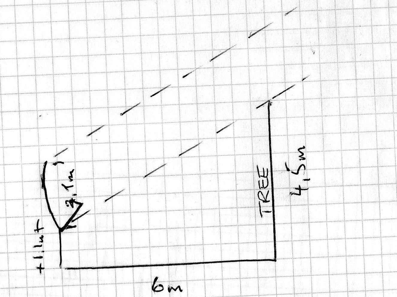

Hello FTA, hope you see this.
I am having a problem getting a fix on the Thor 5/6 at 0.8w, as I said earlier I probably must drastically prune a damson tree, well I have lopped it down to 4.5m height. It is 6m from my dish. The bottom of my dish is 1.1mt with the top being another 2.1mt higher. I have looked on the Sat anntenne allignment table for Thor and cannot get the correct distances in but have 5m fot the tree and 5m away from the dish. This gives an angle of 45°, but where on the dish is the base line where the distance from the tree hits the dish.
Obviously if the dish is higher it will pick the signal up but how high must I lift the dish. This is why I havnt started the polar mount as I will have to alter something.
See my sketch maybe this will be clearer.
The bottom of the dish will be the first area shaded by an obstacle.
Bottom of dish 1.1M from ground.
Make 'baseline' the same height on tree, 1.1 meter from ground.
Find Tangent of satellite elevation. dishpointer.com** ( I used 34°)
Multiply Tangent of elevation angle by baseline distance (bottom of dish to obstacle/tree)
Result is allowed height above the baseline.
Overall height = result + height of baseline above ground (1.1)
**According to dishpointer.com

My math: 34° sat elevation, 5 meter baseline distance to obstacle.
Tan(34°) = .6745
.6745 x 5 = 3.3725
Overall tree height without shading dish
3.3725 + 1.1 = 4.4725 M (From ground-if ground is level)
(BTW, what's correct to label a number in meters, M or m?
4.5 meter tall tree will just shade the bottom 0.0275 meters of the dish.
(about an inch)
Thanks again, I will raise the dish maybe a meter as wifey wont let me prune more off the tree. I could find another place but would be inconvienience.
So I will lift to start with. Does the signal come in over the whole area of the dish, I thought it was just a beam hitting a point and then reflecting to the lnb.
So what about the width of the dish, is that liable to shadow/obstruction as well.
Thanks. I have copied everything down.
The dish itself is a 'lens' that focuses at the feed. So yes, any of it's surface that's shaded from the satellite is lost signal.
Trees start at the ground and grow up. dishes collect signal from the bottom to the top. reason to use the bottom of dish and top of tree/obstruction in the calculations.
Sometimes the top of the dish has to be used as the reference. I've had to relocate some subscription(pizza) dishes that were located under and too close to an overhanging roof.
(Tucked up neatly for looks, but no good for performance)
Thanks again, have taken the chainsaw to prune the tree again, thats the easiest and the wifes out. Took about 0.6m off. (60cm)
Missed your M or m on line. smalll m is used. (6m.) same as (600cm.)
