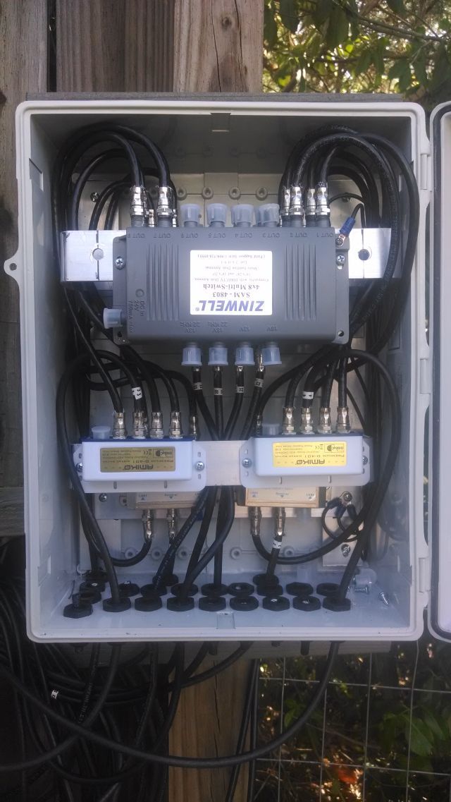

On my MultiSwitch there are inputs for 4 LNBF's (See Photo)
LNB A LNB B LNB C LNB D
18V/0HZ 13V/0HZ 18V/22KHZ 13V/22KHZ
I understand the 22KHZ signal is to toggle between the C and KU bands and the 22KHZ port is for KU and the 0HZ port is for C-Band.
Question 1: - I have two Coax cables coming from my C/KU Band LNBF Universal LNBF (NS741). One from C and the other from KU. Is either the 18V or 13V ports for either the C or KU band or does it matter?

On my MultiSwitch there are inputs for 4 LNBF's & Universal c/KU LNBF (NS741
No need for the multiswitch with thqat LNBF. Coax from receiver direct to the LNBF.
IIRR, that LNBF uses DisEqC to select band. (Port one for C, port 2 for KU) and 22 Khz to select 10600 L.O. (11.7 to 12.2)
For examples of multiswitch use, see Switch setups simplified, in the FTA / MPEG2 FAQ's section.

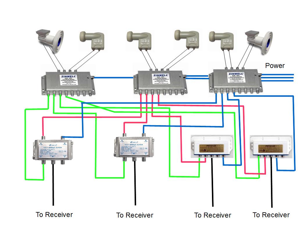

my plan is to be able to hook up to 3 or 4 receivers to the dish LNBF.
Multiswitch and a dual output LNBF, but they are either C or KU band.
the Titanium C2PLL would be my choice for C band on the BUD. A separate 36 inch dish and dual output LNBF for Ku.
Or, I suppose you could Siamese a prime focus Ku LNBF on the BUD. But it won't be looking at the same satellite as the C band LNBF.
