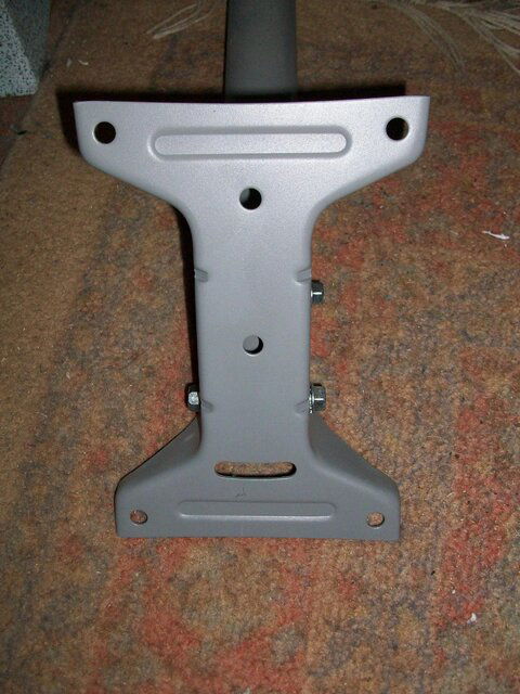

Yes, the footprint / base? I have a plate mounted on a pole, I could have new holes drilled and taped for a DirecTV dish.
I have a 1 5/8 pole already cemented into the ground, I can remove the mounting plate easily.
The holes form a rectangle 5" x 7 7/8". There are also holes in the middle of the base that are 2 3/4" apart.
The holes are 3/8", and yes the measurements are center to center.
Here is a shot of it oriented correctly.
