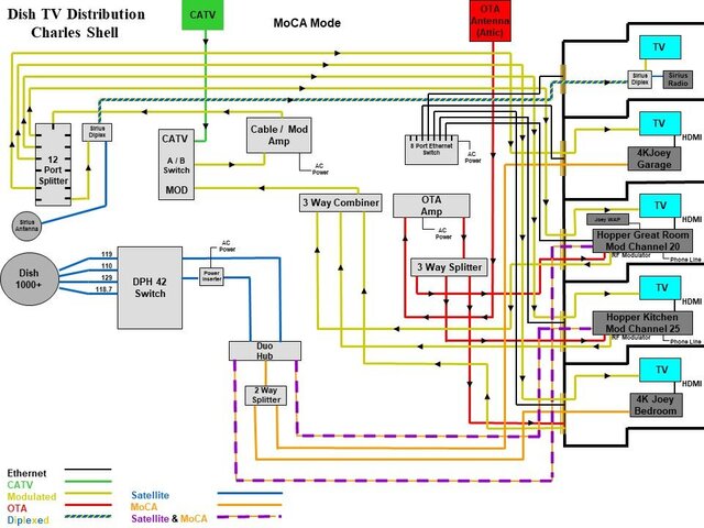

Charles, do you have a diagram of how to run that jumper?
I use a Duo Hub so both my Hopper 3s see each other. For two Solo Hubs setup you run a coax from one of the Solo Hub's Client port to the other Solo Hub's Client port.
