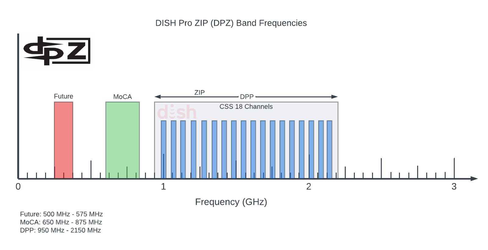

This is what I found. The Frequency ranges are confusing to me since I thought ALL Hoppers use up 3000 Mhz
DPZ is older legacy equipment
  • DPZ Frequency Range:
    • 500MHz - 2150MHz
    • Minimum 3GHz rated RG6 and components required from LNBF to Receiver
    • Note: Tight bends in cable reduces the frequency rating
  • Communication:
    • FSK
      • Includes all the advances from DiSEqC
      • A new protocol was needed for the channel stacking technology
        • Each CSS Channel is set to the desired satellite transponder
      • Support 16 tuners simultaneously over one cable for the Hopper 3
      • Only ZiP equipment is compatible with FSK
        • Dish Pro Hybrid LNBs are backwards compatible with DP/DPP/XiP receivers using DiSEqC
    • Channel Stack Switching
      • Full Transponders are split out (rather than odd and evens)
    • MoCA
      • MoCA stands for Multimedia over Coaxial Alliance and is the standard protocol for transmitting Internet data over coaxial wiring, or Ethernet over coax
      • Clients (Joeys) in DISH systems use data transmission instead of video signals to function
  • Tuners Supported Per Coax:
    • 18, 16 for receiver use
  • Diplexer Support:
    • None
    • Note: OTA and TV2 feeds cannot be diplexed on DPX systems as they run on the same frequencies as MoCA and will interfere with each other
  • Splitter Support:
    • Spitter use is designed to split Client feeds (MoCA)
    • Client feeds require at minimum 900MHz rated RG59
  • Channel Stack Splitter Support:
    • In commercial installations Channel Stack Splitter use is designed to split the CSS band for multiple receiver use
    • Up to 8 Wallys in dual tuner mode
    • Up to 16 Wallys in single tuner mode
    • Channel Stack feeds require at minimum 3GHz rated RG6
    • Note: a power inserter or switch is required
  • Check Switch:
    • 1-5 steps depending on equipment attached
