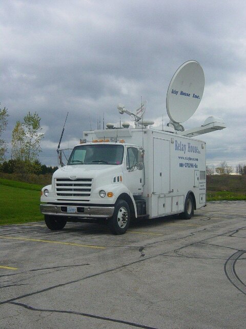

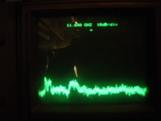

I have hit NSS7 from just north of Chicago. I will post a pic when I get home.
I decided to throw up the dish for a challenge. :)
I am in Port Washington, WI (Just north of Milwaukee)
Neal

this makes me jealous of you guys on the east coast, Here on the west coast, its like next to nothing for the birds on the other side of the pacific, out of the Footprint, we are stuck to Conus only birds for the most part.
You get to bring that baby home with you at night?
I'll have to put you on the guest list for my next party. :)
