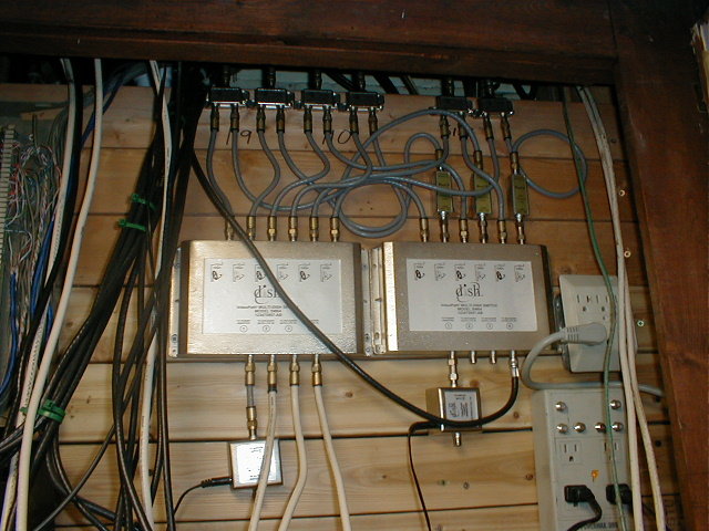

hi: Can anybody tell me how to connect 2 sw 64 switches , actually I have 1 sw64 for 3 sat dishes and 4 receivers ( all lnb are non dishpro) I want to add an extra receiver.
http://www.dishretailer.com/images/installation/7.jpg
You need the following parts...
#1 You need 3 of these...
http://www.dishstore.net/product_info.php?cPath=41&products_id=38
#2 You need 6 of these...
http://www.dishstore.net/product_info.php?cPath=44&products_id=78
We don't exactly have the "Dishnetwork" branded splitters anymore, but if you order that part we'll make sure the correct one gets shipped out that does the same thing.

I should've recommended you 1st. The whole point I was trying to make was that it is possible to hook 2 up.
