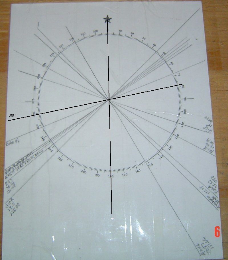

We'll start with the compass reading. Since you can't put a real compass near metal or it will give a false reading, I made one for that purpose.
I would make one similar, or print out and use this one. I have made a line for 259.1 compass reading. Set your paper compass on the ground in front of the dish far enough away to not be affected by the metal, and put your real compass on the paper, and line up North and South. Take note of something on the horizon for reference. Then place the paper compass directly beneath the dish, and line up the center LNBF support arm with the 259 line. That will get you close to G10.

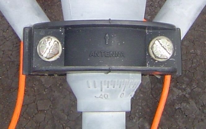

The next step is to set the skew at the junction block. Take careful note that you set it at the + side of the numbers. Also be careful with the bolts on the junction block. I have read where they are easy to strip out. I use PB Blaster for stubborn bolts. As you can see in the picture that I made that error when setting mine up. It cost me over half an hour before I realized my mistake. Your setting as noted above is +38.7:

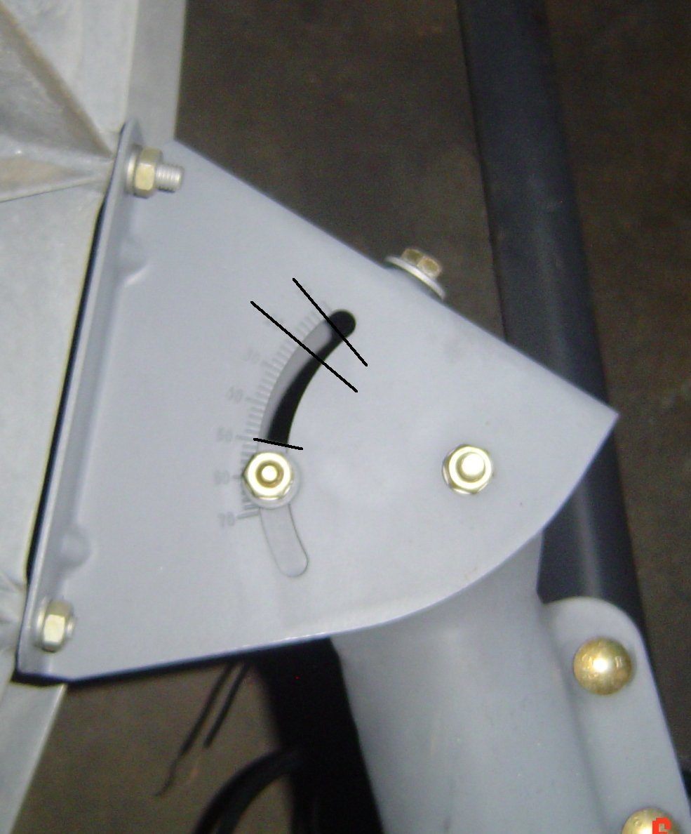

Here is a picture of the elevation markings on the side of the mount on a Primestar dish. I have marked where I think the installer should start. The mark at 10 degrees is the beginning, because I like to start lower than the actual setting, and work my way up. If you haven't found any signal by the time you get to the second mark at 20 degrees, it is time to move in one direction or the other. (East or West)

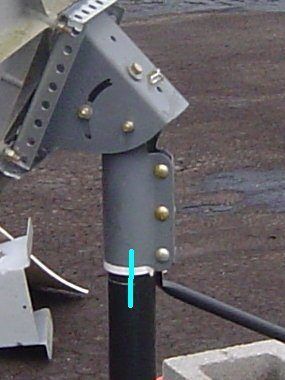

Once you have the elevation mark at the 10 degree mark, place a mark on the mast that runs onto the cap like in the picture below.
