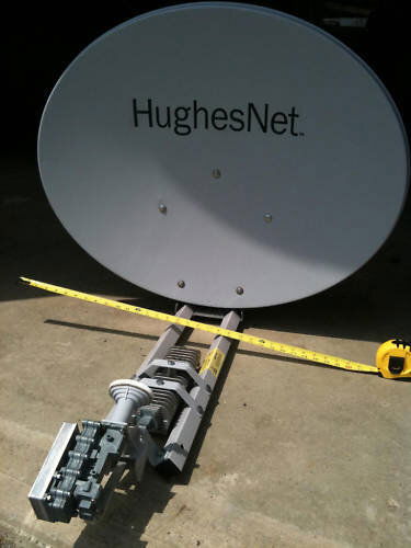

Hi everyone, I just got a hughesnet dish it measures 28 3/4" X 34"
and I cant get anything on it. I have been reading a lot about FTA here for the last few weeks so am familiar with basic setup, elevation, azimuth etc...
I'm using a coolsat 5000 and would like to get Galaxy 19 for starters.
Perhaps the dish is to small for Salem Oregon? I am very frustrated been trying for a couple weeks now, even tried a spitfire elite Lnb with no results.
Funny thing there is a di*h network dish 500 fully setup when I moved here just couple feet away from my new install and the coolsat scans 119 well, all scrambled but well :) So I'm thinking looks clear from around 90 to 190 degrees (magnetic)
So I move my hughesnet dish 20 degrees east or so and nothing, heck tried 123.0 W today still no go. Any clues? I'm at loss. One last thing hughesnet dish was set at around 22 degrees elevation by a former hughsnet installer, wonder why so low?
P.S I included a pic of the same model dish as mine.
Sorry about the lengthy post but Thanks in advance to all.

I hate to say it but disregard pretty much everything sathen wrote. Its all wrong
The Hughesnet LNB usually has a transmitter and a receiver part on the LNB. You can remove the transmitter part and use the existing LNB for FTA. I've used Directway and DirecPC dishes for FTA.
The dish is big enough to get FTA. a 30" dish minimum is required for FTA. The oblong dishes actually help reject interference from satellites next door
If you could take pics of the dish and LNB that you have it would help a little better. But like I say remove the transmitter from the dish and then you should be OK for FTA.
Those dishes can skew so make sure you have the right skew for the satellite in question. You can check thelist at the top and put in your zip. It will tell you skew for each satellite (along with the elevation too). Since you want ot get 97W and are on the coast skew is critical to get a signal ;)
For Salem OR the numbers are as such
32 elevation
130 azimuth (where it is in the sky)
-24 for skew. Since the dish skew is at 90 to begin with if you are standing behind the dish turn the dish counterclockwise towards 66. That is what the skew is
Ono the CS5000 make sure the LNB Frequency is set to SINGLE and 10750
make sure you have an active transponder up when aiming the dish. 12177 or 12152 are good ones. Make small movements with the dish because the receiver takes a little bit to acknowledge the satellite. The bars on the meter will turn green when you are locked on the satellite.
Aiming the dish is pretty straightforward if your mounting pole is plumb and the dish's markings are accurate.
The geostationary satellites are in an arc across your sky, highest in the middle at your true south. Once you visualize this, it becomes a lot easier to wrap your mind around finding one in particular at a certain azimuth/compass reading.
Make sure your mounting pole/arm is exactly plumb, then set your dish elevation and skew to the correct figures for your location. On a high-quality dish like the Hughesnet the markings should be accurate.

Your Hughesnet dish is plenty big for Ku band FTA.
If you can't get a signal, write down all your settings from the manual scan setup screen in the CS5000 and post them back here.
The Dish500 you have will also work for 97w, 101w, and most of the stronger Linear Ku FTA sats with your Spitfire Elite Linear LNB mounted on it in place of the twin circular lnbs.

I Thing U Right Iceberg. Just realized that he has 34 inch NOT 28 like I saw in the first look on his letter.Yea. With 34 inches hi will be OK as long as his LNB can be tuned to Local Oscilator 10750. I just finished my experiment on using 18 inches dish with full success so even with smaller size it is possible. I would not use it for permanent use ( On rainy day U can forget it) so I always would recommend as big as possible.Later I put some pictures..
aiming a skewable dish, for beginner:
Mounting an LNB beside the existing one, would require aiming the dish differently, so let's not get into something like that on your first one. - :rolleyes:
Make sure the post is plumb.
Set the skew on the back of the dish to 90° (no offset). - (no, not a typo)
Stand well behind the dish with your compass (to prevent the metal from affecting the compass).
Aim across the dish at 130° (using Iceberg's numbers)
Find a point in the distance, that lines up with your dish, on the 130° direction.
For best results, pick a tree, fence post, corner of a house, that's at least several hundred feet in front of the dish.
Make sure the dish is aimed toward your distant reference.
The way you will do this is to aim the LNB support arm. (that's about all you have to work with).
Make a pencil mark on the post, and a matching one on the clamp that holds the dish to the post.
During your dish test alignment, you will may twist (aim) the dish on the pole so the two marks are out of alignment by maybe 1/8" and no more.
Line up the marks; note the dish is aimed at your distant object.
Now, skew the dish the -24° as Iceberg said, and lock down the skew adjustments.
Does the dish look like it's still aimed at your distant reference point?
It won't appear to be, but if the pencil marks are still aligned, then it IS ! - :cool:
Skewing an offset dish adds an optical illusion to the process of aiming that you don't need.
This procedure cancels that effect.
I am reminded of this situation every time I fiddle with a dish that has it's own skew.
However, I don't recall ever seeing it written down.
Feedback from other members is requested, on improving or fine-tuning the idea.

i have a dish identical to that one, the lnb on it works quite well.
you should be able to get very good signal on 97w
also, you dont have to remove the transmitter, just leave it unhooked, personally i would leave it on to keep bugs out of the feed tube
the only reason to remove it would be to reduce the weight of the dish, and being as you are not putting a motor on it, there is no reason to do that.
even without a transmitter that particular dish is too heavy for a motor
hope this helps,
Denny
