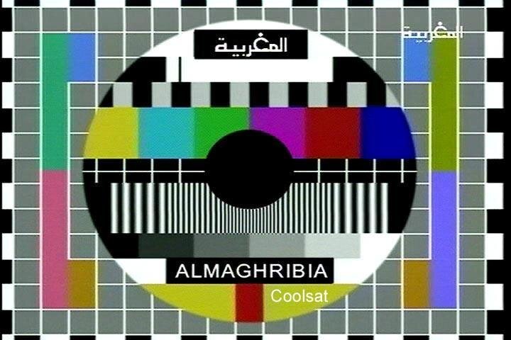

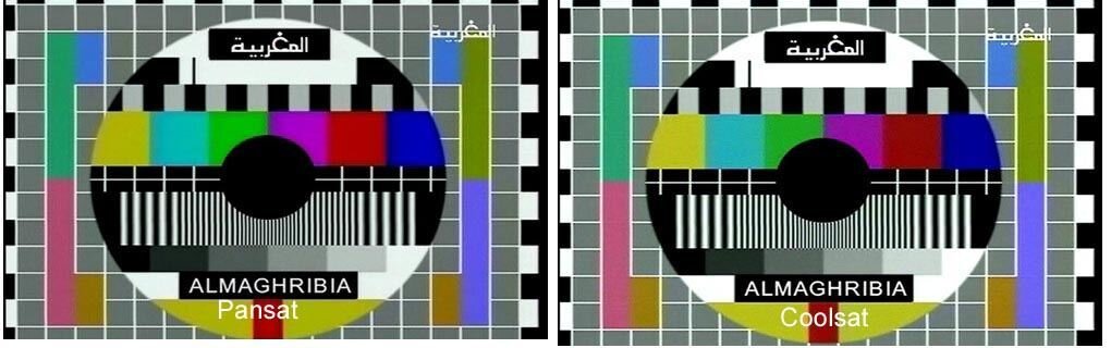

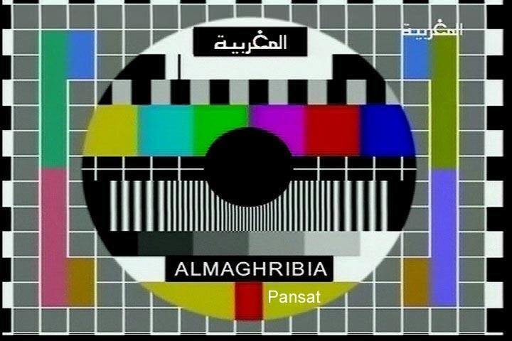

First Image Series- Almaghribia Test Pattern
I was somewhat surprised to find that there is a discernable picture difference especially in the way the machines handle color saturation. The most noticeable difference is in the red color, which appears to be not only more saturated on the Pansat but also a slightly different hue. The deep blue is brighter and again more saturated on the Pansat as are the purple and light green in that row. The remaining colors seem to be more similar than they are different to my eye. Greys and blacks seem to be equal while the Coolsat appears to show a somewhat brighter white. Sharpness is about equal.

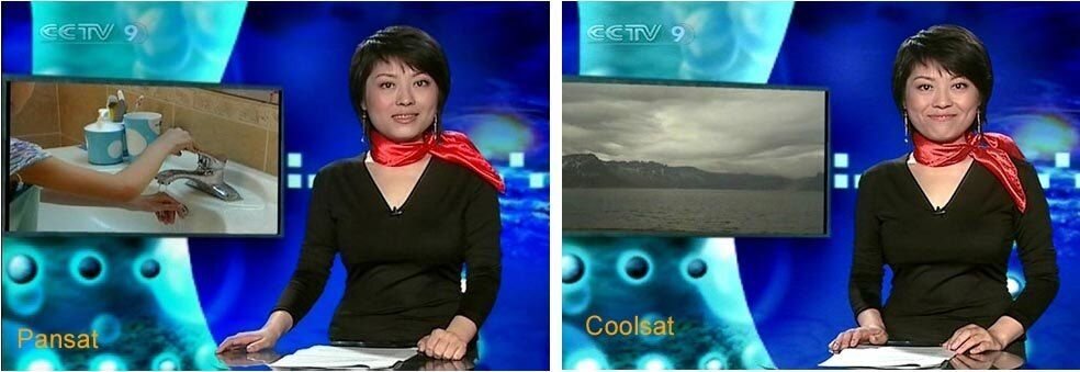

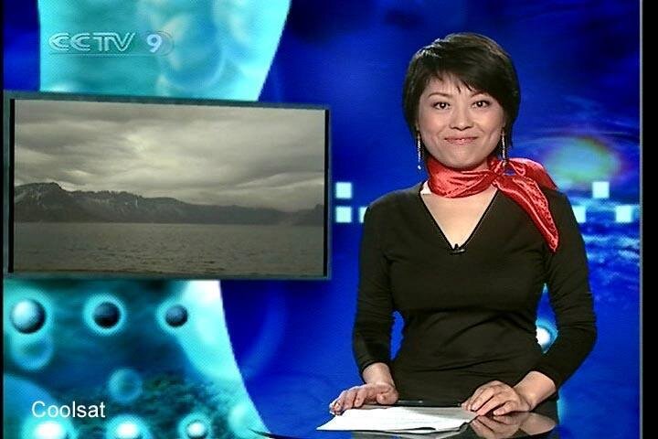

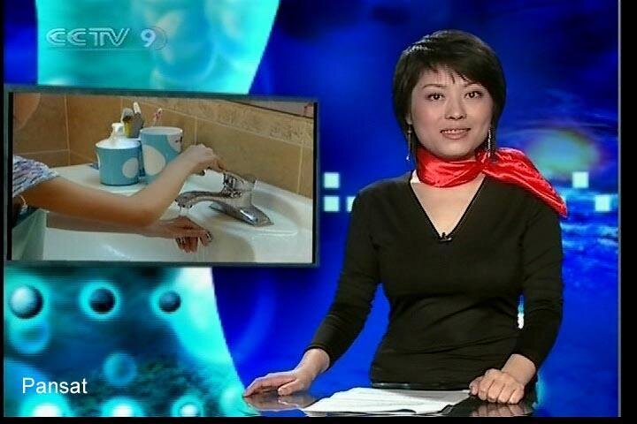

Second Image Series-CCTV 9
Again, the Pansat's more saturated color is evident and easily seen in the girl's red scarf and the deep blue background. The blue-green background color on the left seems to be less affected while skin tones appear to be fairly similar to my eye. Again, sharpness seems to be about equal.

To me they both look saturated. The Pansat being brighter, may make it more noticeable. But the Coolsat still has it. It's just a bit more dull.

I don't notice any saturation in either of the units. The Pansat is simply brighter. Like you said. The prospective buyers will need to chose which suits them best. Both units have beautiful pictures.

Hi Tracy in you first set of picture the one with both (small) picture the coolsat red look more like maroon while the pansat look red, the
darker colors look better on the pansat while the lighter colors look better on the coolsat,

I agree with you about the difference in the reds and I prefer the video of the Pansat overall. However, I am using the Coolsat as my main unit because of the new firmware update-love the new blind scan they have. Now if Pansat follows with an update it would be great.
