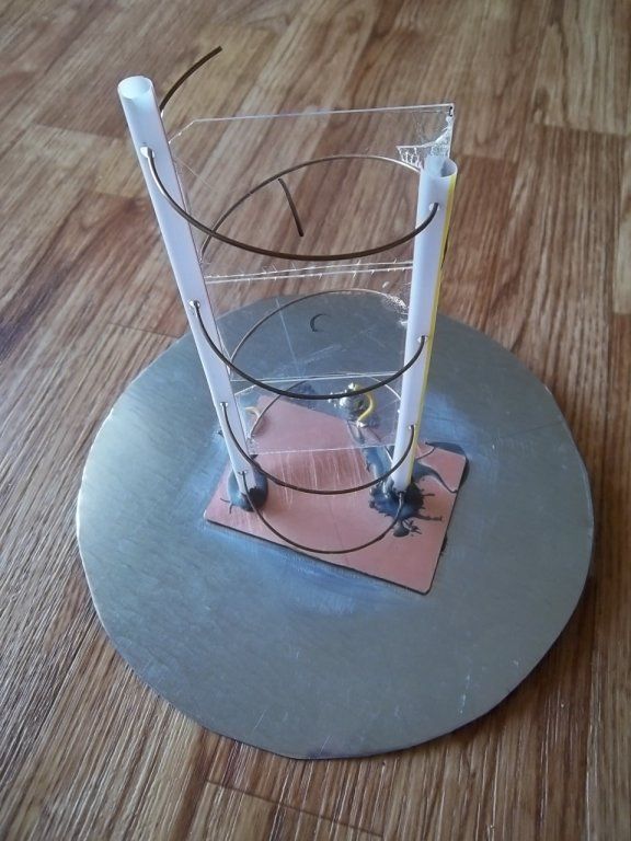

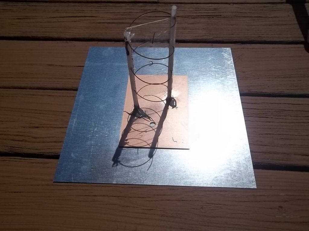

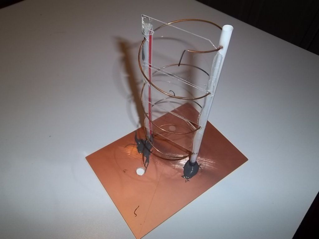

Inmarsat project so far, homebrewed 1.5 GHz left hand circular polarization helical antenna to be used with a satellite dish ( FTA dish is fine). Ground plane is 8 inches diameter, coil is 3.5 turns copper wire, 58 mm diameter coil, 46 mm spacing between the turns. Coil form made from straws, anchored with epoxy.
Found that a spray can of Febreeze is exactly 58 mm diameter, perfect for winding the coil.
