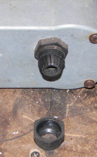

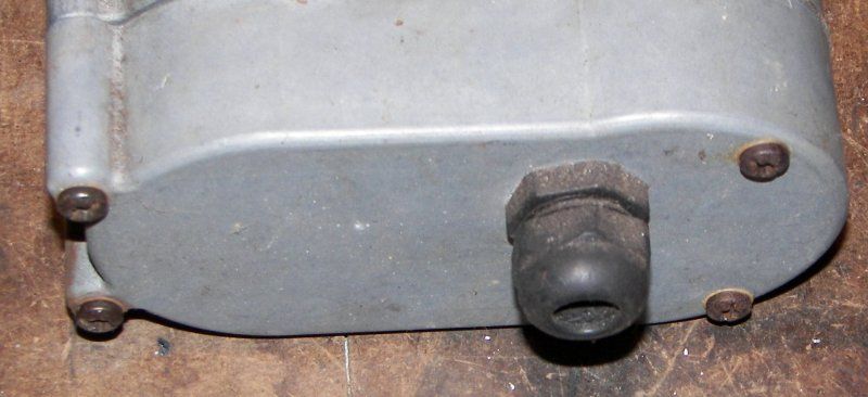

Yes, i used one of them to "seal" the 4x14awg cable, and the other 4, i know its wrong, but i used them to separate the cables inside the actuator :confused:
RamboHack
Monterrey, Mexico
That's not what they're for.You should have a plastic connector that the cable passes through to get into the box,similar to this,see pic.The rubber grommet goes around the cable,under the nut,tighten the nut to make a weather seal.100_0755.JPG 100_0756.JPG

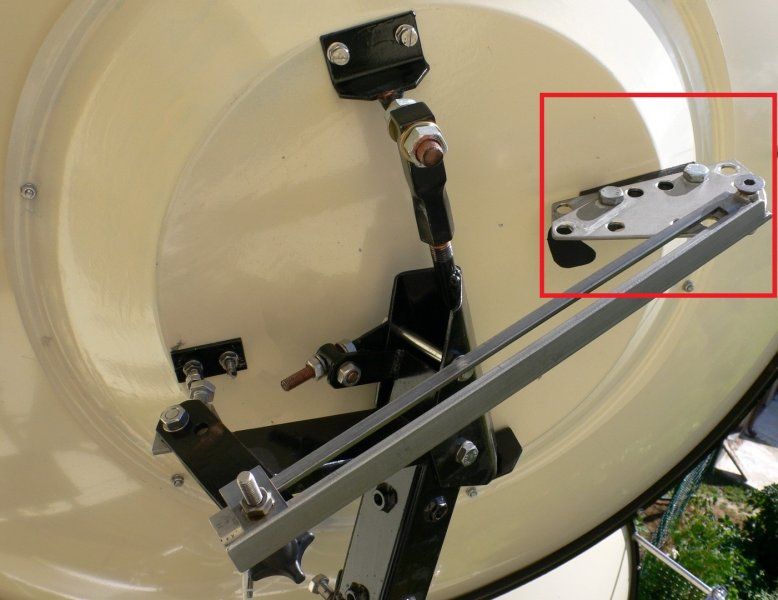

P.S. Before you try to get a polar mount to move too far East to West, do some research here on "flop over". You don't want that to happen, if that mount might possibly be prone to it.
First of all, Rambo, if in real life you look like on your avatar then nothing should be hard to do for you. Even lifting your dish together with it's mount all alone! :clapping That was joke :)
But, seriously, good project and proper approach to installation. Learning not only by doing but also from other user experiences.

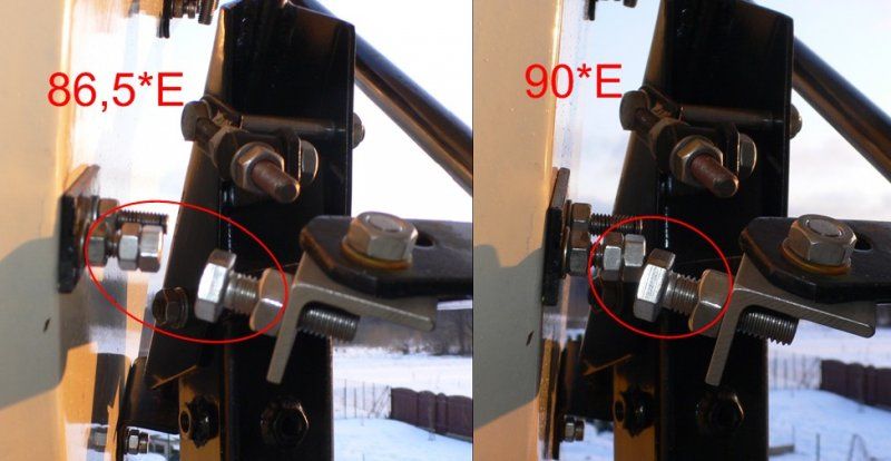

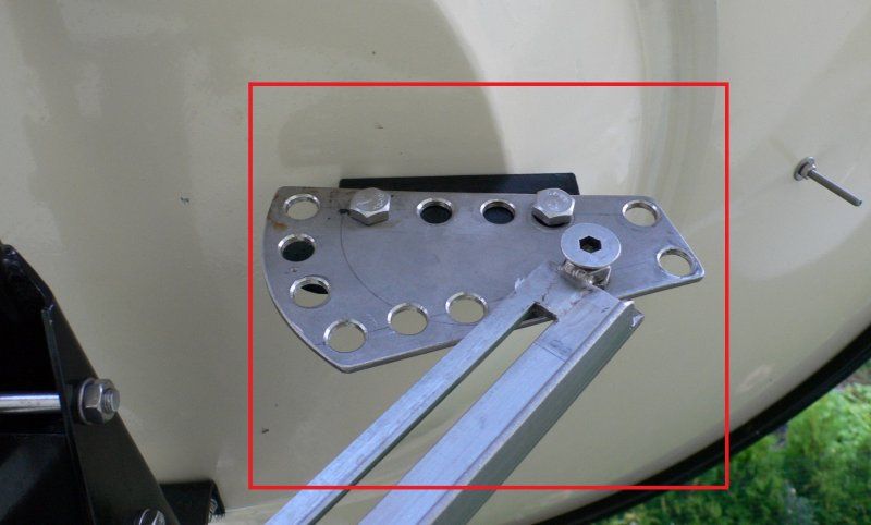

2 things I wish to say:
- Already mentioned "flopping" phenomenon. To avoid it happen I used to add adjustable mechanical stop to the mount. When it is installed it is even possible to remove actuator from the mount but dish will still be tuned to far East (West) satellite. Of course, when mechanical stop is installed, the actuator should be properly used to not break anything.You can see one of my mechanical stops on the picture 150MechStop.jpg
- Secondly, choose of connection points of the actuator is very important. That helps to use full length of the actuator, make it's duty easier, avoid flopping of the dish and get H-H arc. You already experienced when actuator tube almost hit the mount. Most likely you need to replace connection point of the actuator. I did it by attaching the plate (in the Red square ;) ) with lots of holes and found the proper one to be the most appropriate. P1240353 (Large).JPG P1240359 (Large).JPG

Personally, I would weld an angle iron to the mounting ring in an "L" shape and move the reflector's actuator mounting point 16 - 24" further out from the current mounting point and 6 - 8" away from the reflector. This change will not only eliminate the pinch point, but also add provide more counts per degree of travel and have better stability in wind loading.
By extending the side bar on the lower actuator tube, the result will be increased western travel before the "flop". Ultimately, keep your eye out for an old satellite dish with a horizon to horizon mount. Swap out the mount for complete horizon to horizon travel. The HH mounts are rare, but especially useful near equatorial locations since the polar mount design cannot see the entire arc that is usually visible in equatorial locations and the dish movement is so extreme.
