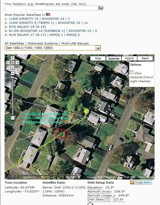

I have a couple of questions regarding my location, if it's suitable for western arc, or if I'd have to use eastern arch. I'm interested in purchasing his same dish (dish 1000.2 pro hd) 119,129,110. I took a picture using an app he had called dishpointer pro, but the satellites seem to jiggle around quite a lot to the point where it seems i have clear LOS, and then I have trees blocking. So I wound up using dishpointer dot com and it seems like it points right into the trees from my backyard (doing it on a roof will not clear the trees I think) or will it?.
Can I have some opinions on this? I'd be okay with 2/3 sats, and if its not okay, would you recommend eastern arc?

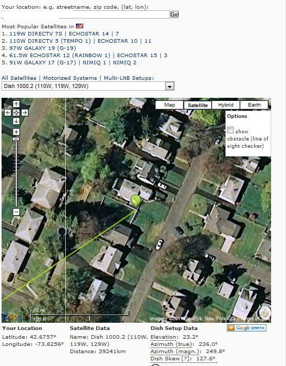

Because using the "obstacle obstruction" tool, if i put it over the trees, it says the maximum height the obstacle can have without blocking the LOS in my case would be 37.2. So if I got on top of the roof, that would only add an additional maybe 16 feet. I did notice however that if I drop the satellite on my front lawn I think I could easily get itUntitled-1.jpg
If you have NLOS to any of the Western Arc satellites, I would strongly recommend going with eastern arc (you'll be missing channels if you can't get all 3 WA sats). Also, the Albany, NY HD locals only come off satellite 61.5, so you would not get them in HD with the western arc setup
