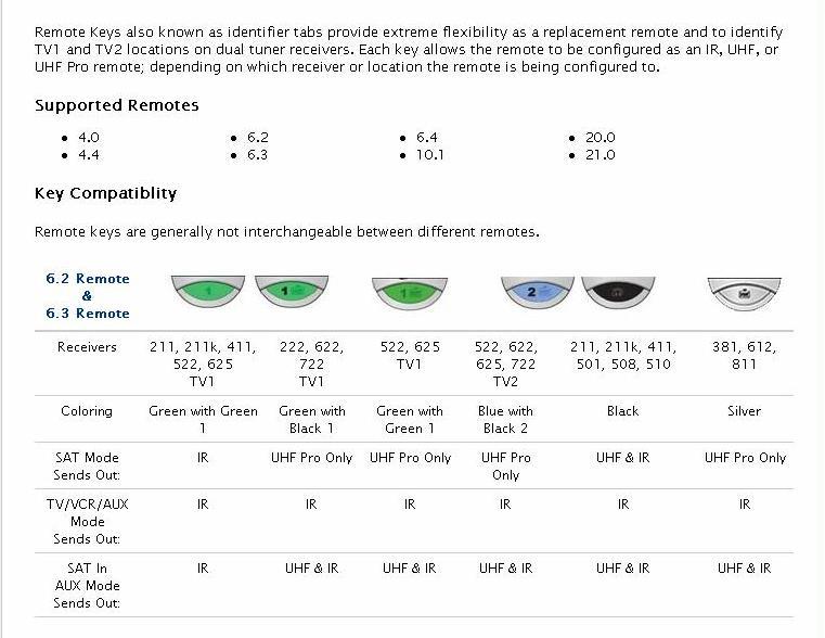

It does have an antenna and I have a 6.4 IR/UHF but the tech at Dish could not get it working. I have a 2 and the systems wants a 1 remote?

Do you have any other keys/tabs for the remote? It would be the same TV1 UHF tab as the 522

I tried it with the "blue" side up labeled 2 UHF and got no response- remote quit responding. I then tried it with the black side up labeled UHF and the remote worked but it didn't change the IR1 that still shows.
