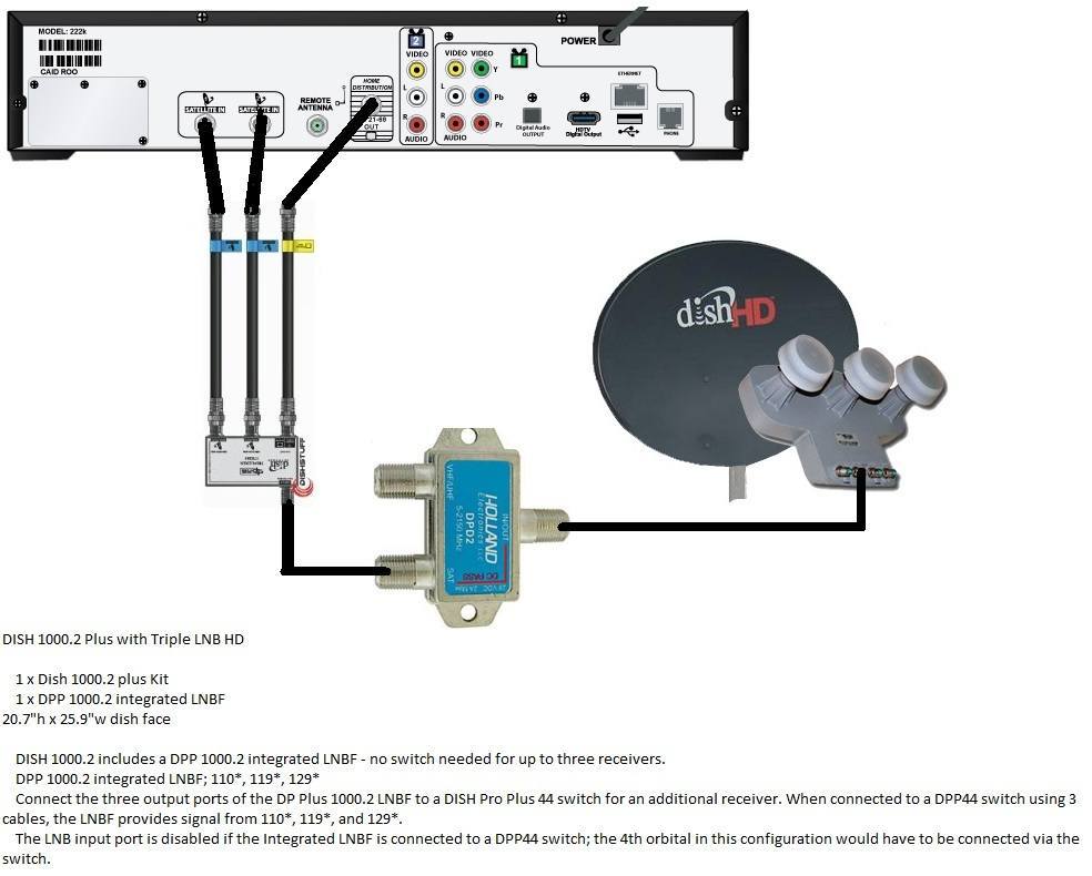

This is my installation I'm doing myself, I was just wondering exactly what's wrong with it? On the point dish screen [which I aligned myself], i was getting a signal of almost 80. Turning on my ViP222k it goes through the very first acquiring signal progress bar and then gets to the guide part, which doesn't complete and I'm just met with a screen of "Complete Signal Loss" or "Partial Signal Loss" This will be a 2 room system (from one receiver) but for now I'm just trying to get a picture in the one room.
This ViP222k receiver was from another system before I got it, also.
Is this a setting on the receiver or is my installation wrong? Thanks.
Your diplexer is backwards and have you run a check switch

Flipped the DPD2, I ran the switch test but it tells me the test has found I have fewer satellites than previously detected, selecting save will result in a loss of channels. The dish this came from the and the one I installed are the same, should I have any less satellites? When I hit save its recommends I never remove satellites from my configuration..
You are not pointed correctly. Save the settings and report what you do have. We should be able to get you pointed closer.
