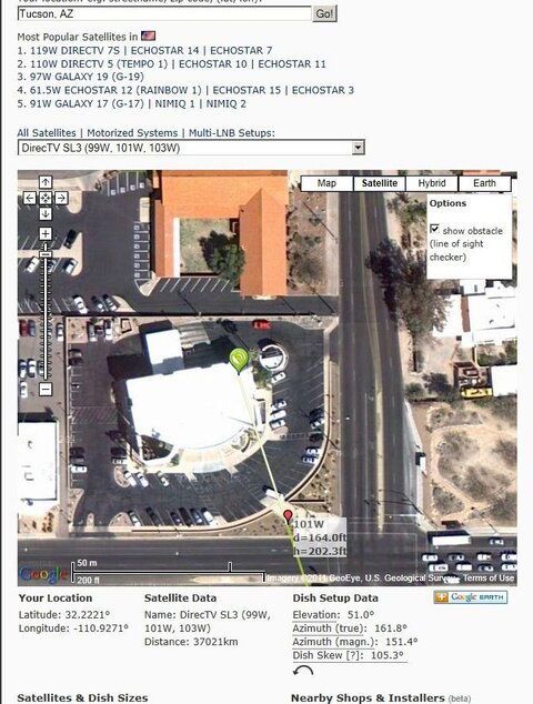

Sorry; I dont see an image which I get the impression there should have been.
Anyway, get a $12 heading compass from wal-mart or similar and aim to the known coordinates and then look up at about 50 deg while facing that heading. some smartphones have a compass app that can do in a pinch.
or try here too with your LAT/LON - choose the MULTI-LNB dish type (see example)
Satellite Finder / Dish Pointing Calculator with Google Maps | DishPointer.com
