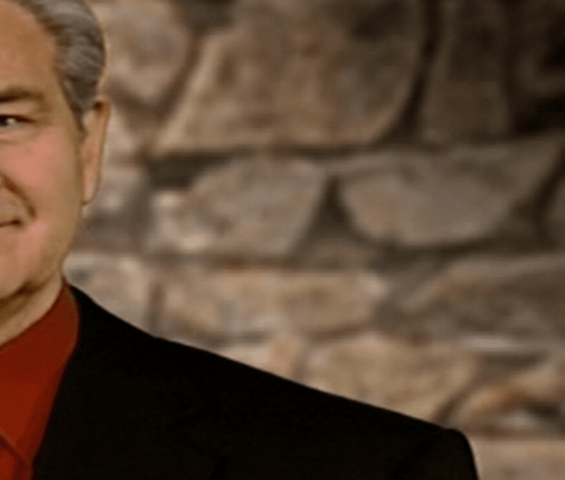

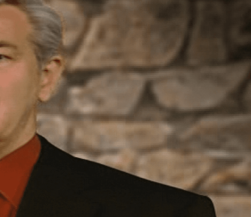

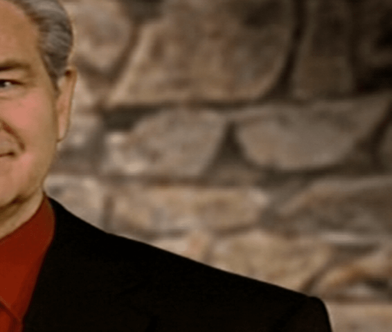

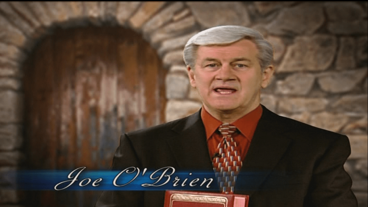

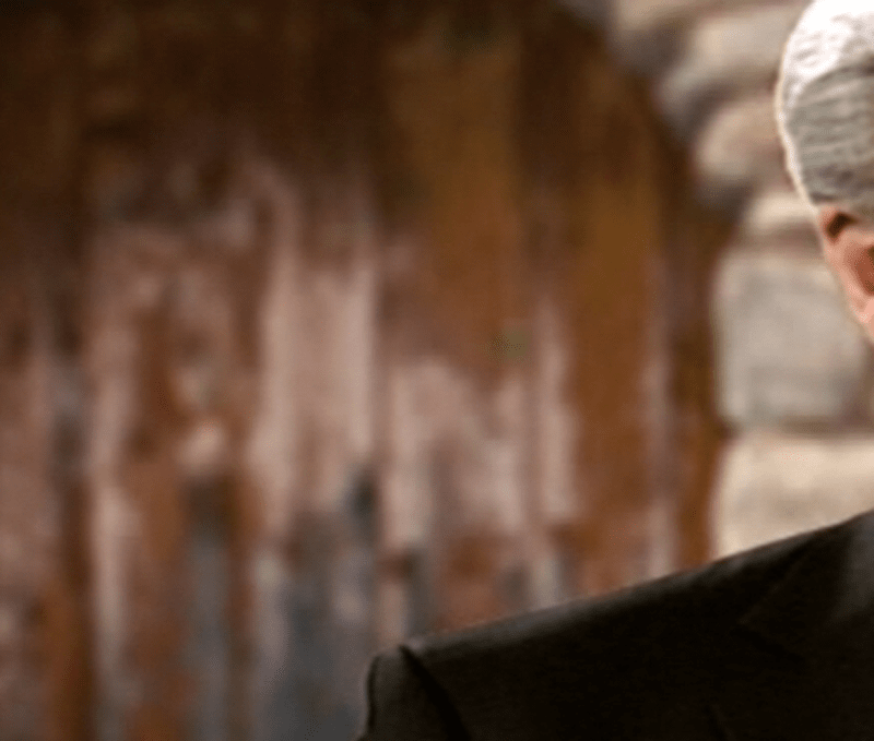

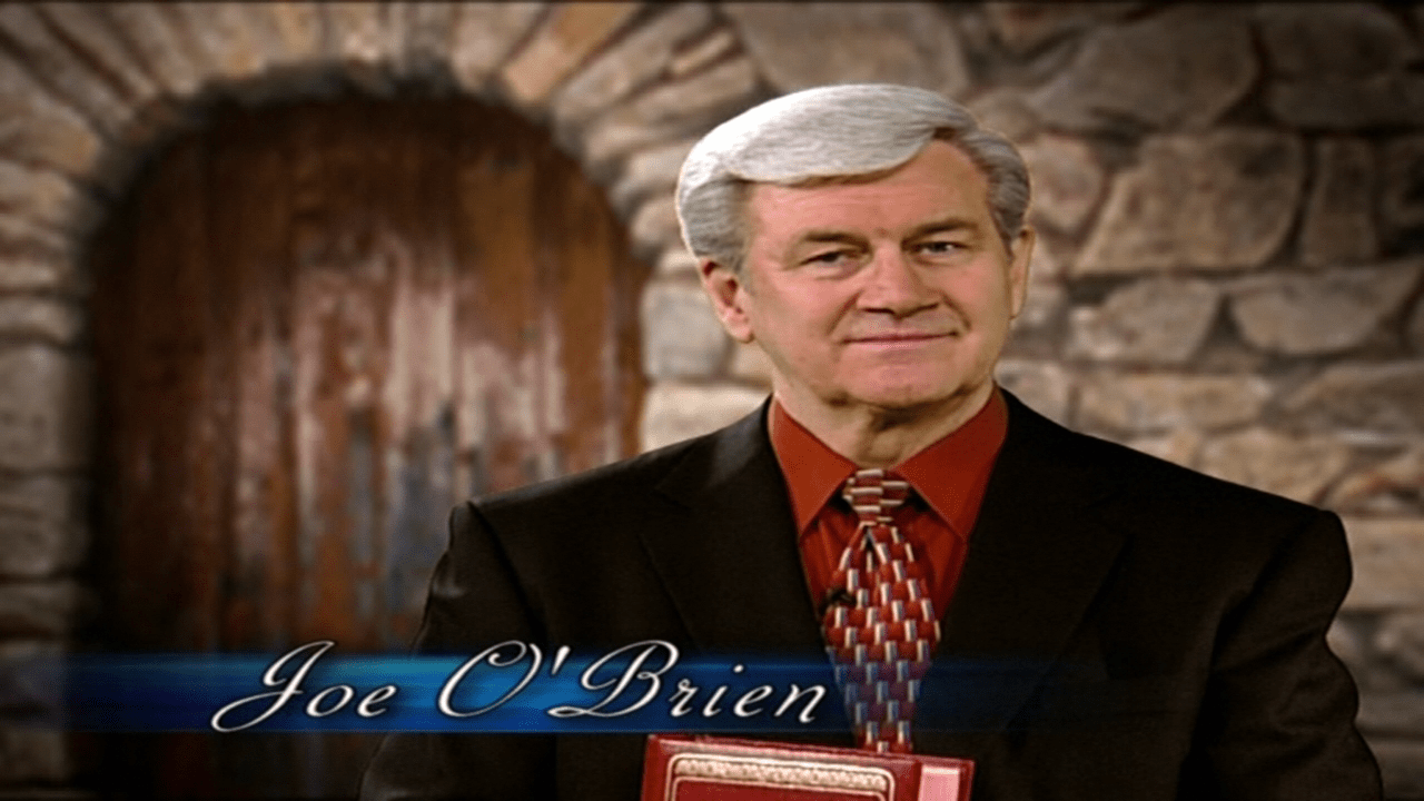

This is a little off topic, but since we are comparing the X2 to the MicroHD I am wondering if anyone notices an issue with the SD channels looking a lot worse then they do on the MicroHD? Its only the SD channels, the HD channels look fine and as far as my eye can tell equal in HD between both boxes, yet the SD quality is off on the X2.
I am wondering if its only me, maybe a have a bad box or perhaps its something with the X2 chipset.
Scott the last software seems to have improved that problem, the SD channels do look better to me, but as noted it might just be the result I expected. But I still get an occasional USALS glitch moving from one sat to another, yesterday the audio on TuffTV just cut completely off after about 35min, and sometimes that little box that says "No information" pops up and won't go away without a reboot. Considering going back to the Apr software mine came with. Overall though I think the last firmware is a bit better.
Scott, the deinterlacing issues affecting 480i and 576i source video are an issue with the Novatek chipset. This has not been resolved with either the X2 Premium or the GEOSATpro HDVR1200. Personally, the SD video quality is poor and the incorrect deinterlace processing is more evident on some channels. A great comparison channel is a credit roll or any contrasting hard edge on G-19, 3ABN English.
We have been working closely with Novatek engineers on solving the deinterlace issue for the past 6 months. While a resolution is pending, it has not been released for any developer. Unfortunately, the solution may only be available on a chip revision and not via update.
This has been a major reason that we have not officially released the HDVR1200 for FTA market. We maybe try to hard for perfection instead of turning users into lab rats and guinea pigs. :D
At this time, ALI chipsets provide the best SD deinterlacing for consumer STBs. MStar are the worst and Novatek falls in between. I'll capture a split screen next week for side by side comparison of the PQ.
Thanks for the technical information! I like hearing the x-planation of things, even though I don't always fully understand all the terms.
