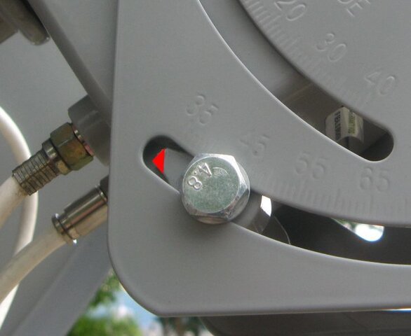

Lak7. i did lock my true south at 90 percent. but as i went further to lock say 101 i lost 72w(true south). what is so confusing for me is with the motor lat is that bolt is so huge where does the real reading allign with the middle of the bolt? being that setting is set it and forget it i would like to understand what reference point to look at to set 45 degrees. i think that would help me when i am messing with the settings for the dish. if a real accuracy is needed how in the world could i set the inclinometer on the motor to get a accurate reading?
It's not the Bolt, see Pic, I colored the indicator Red...
OH MAN. thanks Lak7 now i know i have been setting it way off. i was using the bolt. so now maybe i can get somewhere. its funny i read the manual and it shows that but gives no explanation. here i go back to the yard:)
Lak7 thank you. i put my motor to that reference and now i was able to lock 103-68w. a major improvement. without you guys i would be lost. thank you very much.
