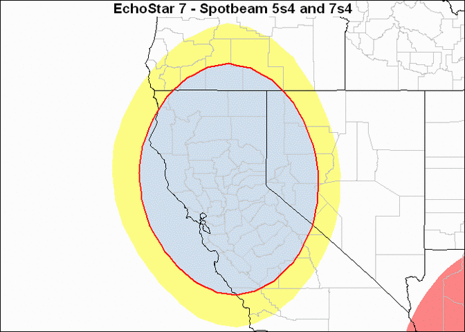

The San Francisco high definition locals are on sat 119 - TP 7 (12311) (R), spot 4.
From what I can tell, that spot beam goes from Central California north up to the Oregon
state line. So you "should" be ok. I have attached a copy of the E7 spot beam map I used to find out.
