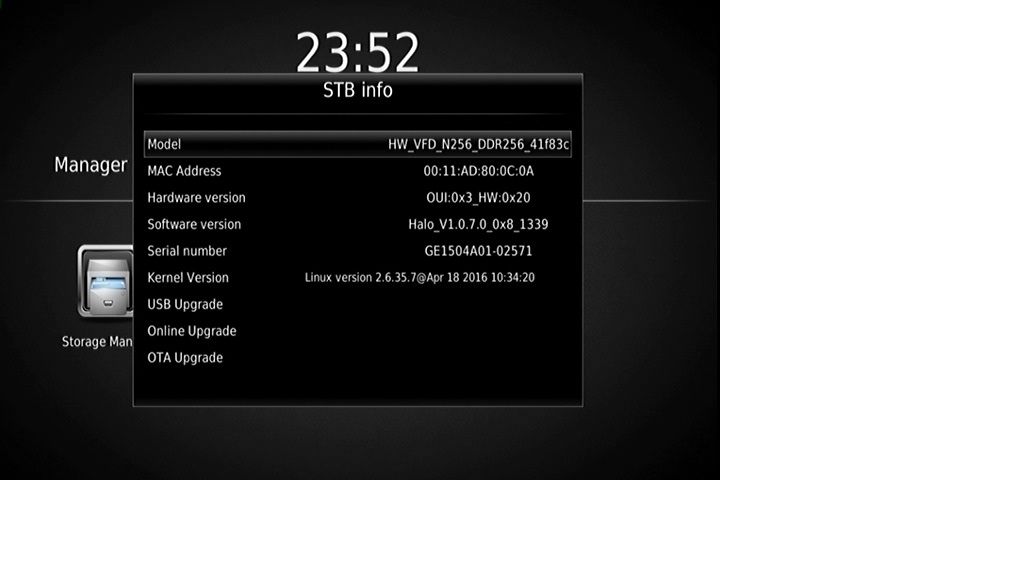

I'm including a screenshot from my GeoSatPro HDVR3500 FTA satellite
receiver's INFO. so that you would have a better understanding which
firmware I have NOW. And which Firmware I should have.
As long it doesn't lose my program satellite list and settings.
I hope you understand it all as I describe on this post. Well, I tried.
Hope all helps with answers.

Disconnect all external drives and reboot
If the issue occurs without drives attached, perform a factory reset then reboot. If the problem still continues the firmware is either corrupted and needs to be reloaded or the flash memory has failed. Likely an issue with the internal (onboard swappable) USB drive.
Contact the distributor for support. They will either provide firmware to reload or you may need to send it in for service / replacement.

If you already loaded new firmware, this already did a "factory reset". No need to perform a factory reset again.
Does this problem only happen after loading your satellite list? What happens if you don't load your satellite list and just scan one satellite? If the STB can be powered cycled without resetting and going through the extended reboot before loading your satellite list, the fault may be caused by a corrupted satellite list.
My guess is that the internal USB flash drive has failed and will need to be replaced or the main flash has a defect. Contact Satellite AV again and you will probably be asked to send the unit in for testing and repair.

OK, so it is not a corrupted satellite list that you are loading. This is definitely a internal memory issue. Likely the internal USB swappable thumb drive (either 32 or 64GB) or a main flash failure. Looks like the STB will need to take a road trip back to the mothership...
