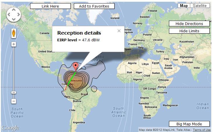

Are you receiving these outside of the satbeams footprint map?
It appears the Montreal EIRP is estimated to be 38dbw and in NorCal it is 28dbw. An 8 foot dish should be more than adequate for the SE US with the estimated 42dbw.
We have received user files from several C-band systems on the east coast with channels scanned in from this bird.
Brian
I'm inside the footprint in the strongest part in the Carribean 46/48dbw.
46/48dbw is the C-band, not the KU-band frequencies that you referenced in post #6
Where are you in the Caribbean?
Are you receiving the KU-band frequencies that you listed or the C-band?
If KU, what size reflector?
Hey brian I don't see 78? is this because my channel list is from the original software that came with the micro and since I loaded my channels it does not display?
I added it but my additon does not look like the others, and I can't seem to put it in order.
I guess I will add in 31.5 and 34.5 in as well manually.
46/48dbw is the C-band, not the KU-band frequencies that you referenced in post #6 47dbw Ku Band Venezuelan Beam
Where are you in the Caribbean? Puerto Rico
Are you receiving the KU-band frequencies that you listed or the C-band? KU Band
1.4M
I've been trying ever since I started FTA to DX the Ku signals from that one here in northeast Georgia. No luck at all. Then again, I only have a 90 cm dish ;)
Probably would need a minimum 5 to 8m dish to even have a chance at DXing this transponder if the estimated EIRP and footprint is accurate.
