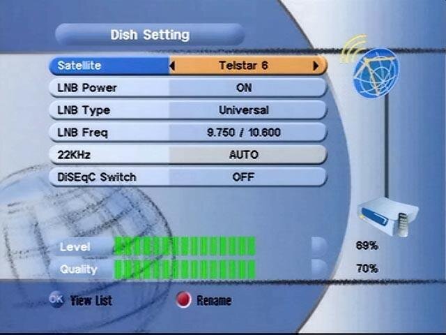

1. After you have locked the signal with the bar "in the green" you can run a blind scan and get channels.
2. For me the magic number is 63% to lock. Anything below that is no go. Could be different for you though with a different setup from a different location.
3. I doubt it is the receiver. FTA sats are hard to lock onto due to relatively low power. Run an Internet search on your particular LNB (or contact the retailer or LNB-maker) and make sure you have the right settings. Then using a compass, make sure you are lined up on G10 with numbers that PSB gave you. Make sure you hold the compass level and still and that it is not too close to any metal objects (even the dish).
When you have done this and you are sure you are right, consider this just a starting point-remember some dishes will read slightly off, my own dish is off by 2 degrees elevation. Then lock the dish down but not all the way as I described before and make VERY small and slow adjustments in asimuth and elevation. Have a TV at the dish if at all possible and watch like a hawk for the quality to spike in the green. If this happens you are close.
If you still can't get anything use the numbers PSB gave you and try for a different satellite. If you can get something on another bird it will give you confidence and you will know that your settings are right and nothing is defective. You will still have to get your TS in at some point. That is what I did when I had trouble getting my TS (true south) bird. Later, I realized that my TS was blocked by trees so be sure and check line-of-sight issues. Remember-the dish is actually aimed about 20 degrees higher than it seems. If you do all of that and still nothing then some setting or connection has to be wrong or something is defective. You should be able to hit green somewhere on something.

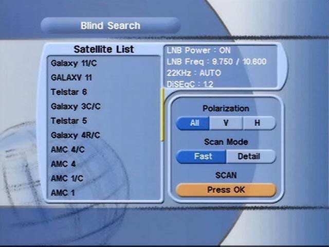

Here are a couple of screens. The "Dish Setting" shows what you should see and a typical signal level-remember that the LNB settings will be different for your specific LNB. After you get signal you can run a blind scan (pic 2).
