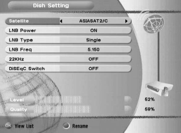

I remember Iceberg also mentioning LO. What is LO and where do I set it? I don't recall seeing anything on the setup menu called LO.

the LO is in the setup menu under dish ( for each satellite)
so from the menu
installation
dish setup LO is the second or third one on the list
LO for C band = 5150
LO for Ku = 10750
Huertaaj, it's labeled as 'LNB Freq' on the screen.
