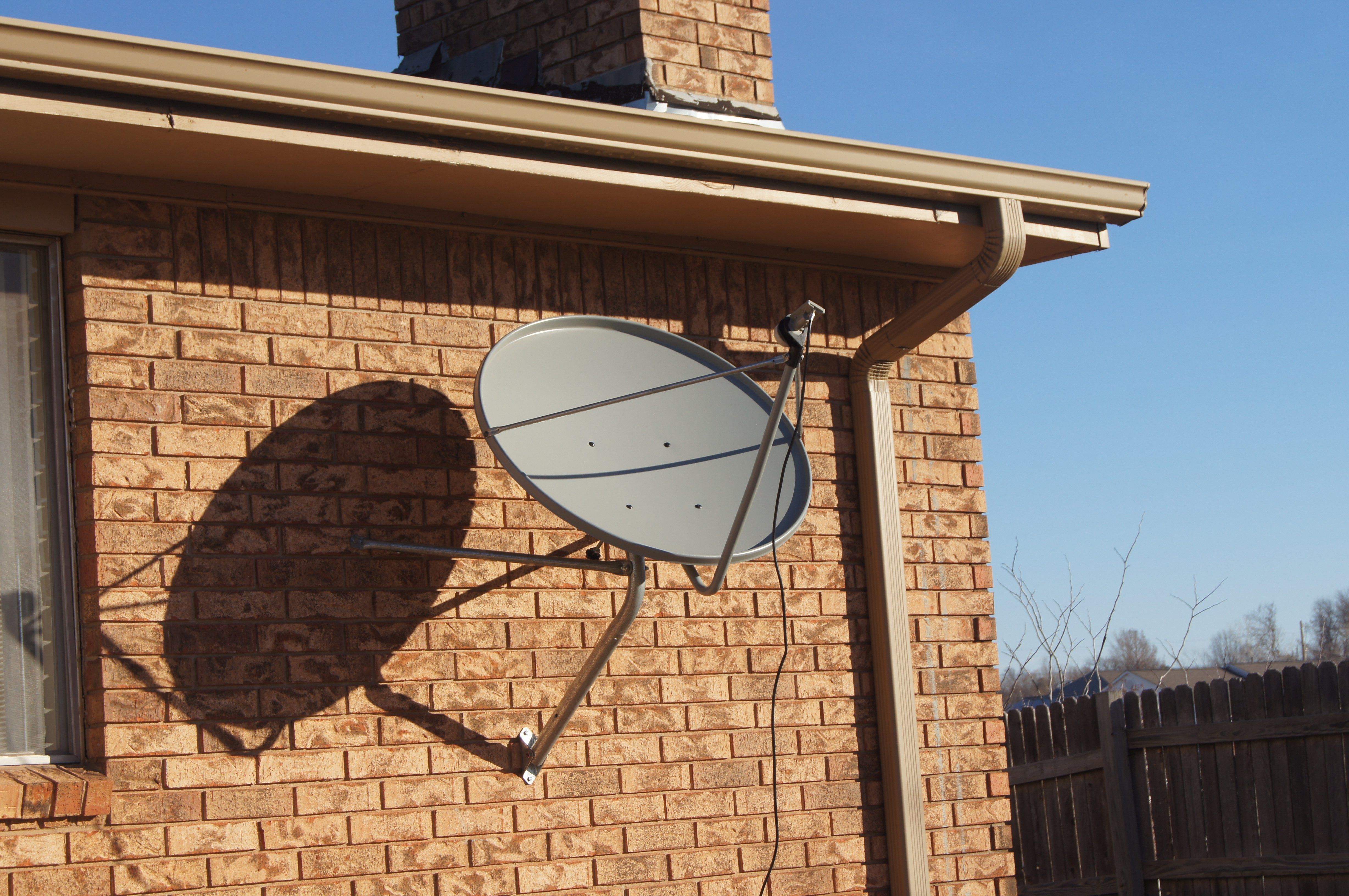

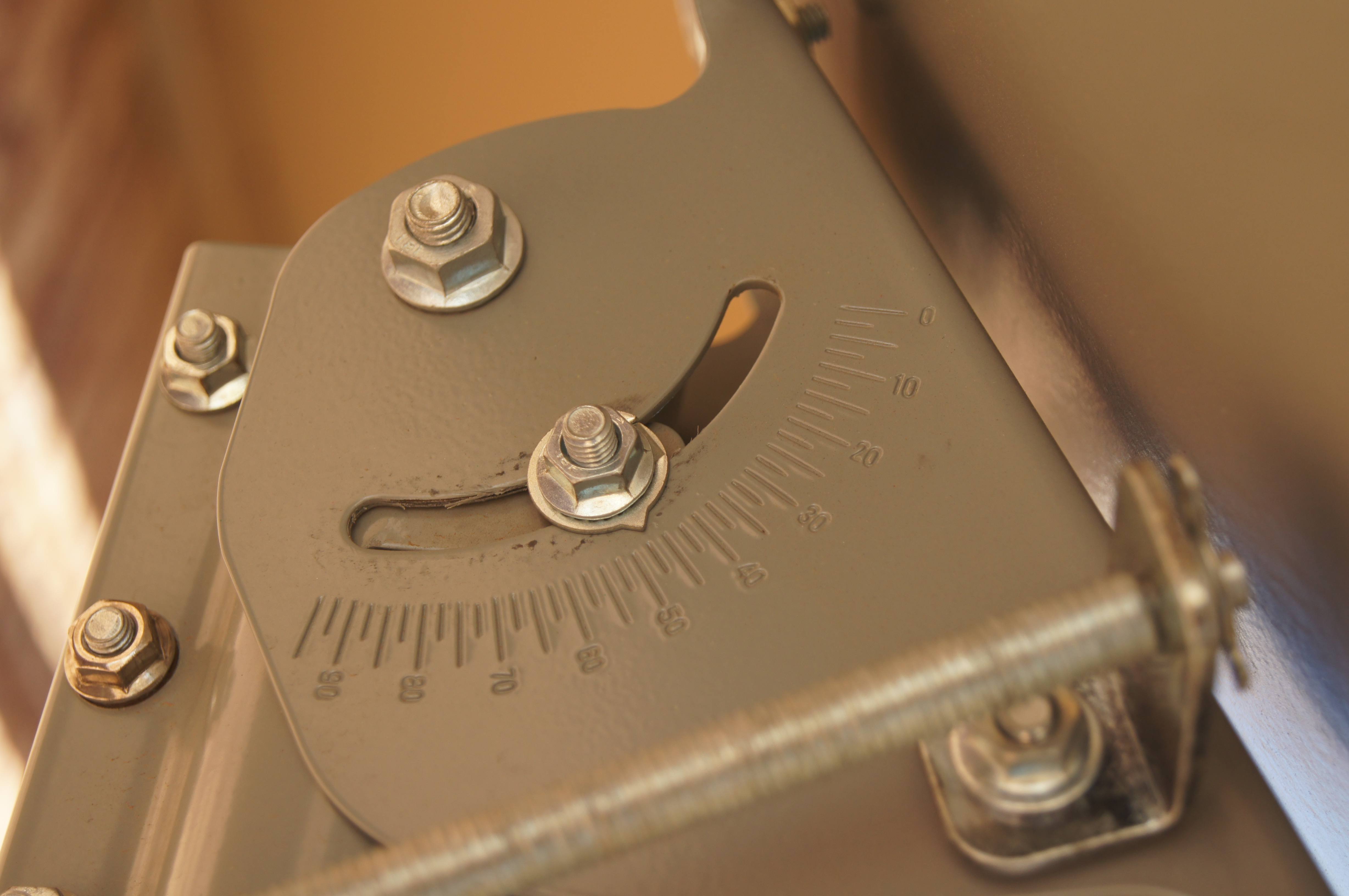

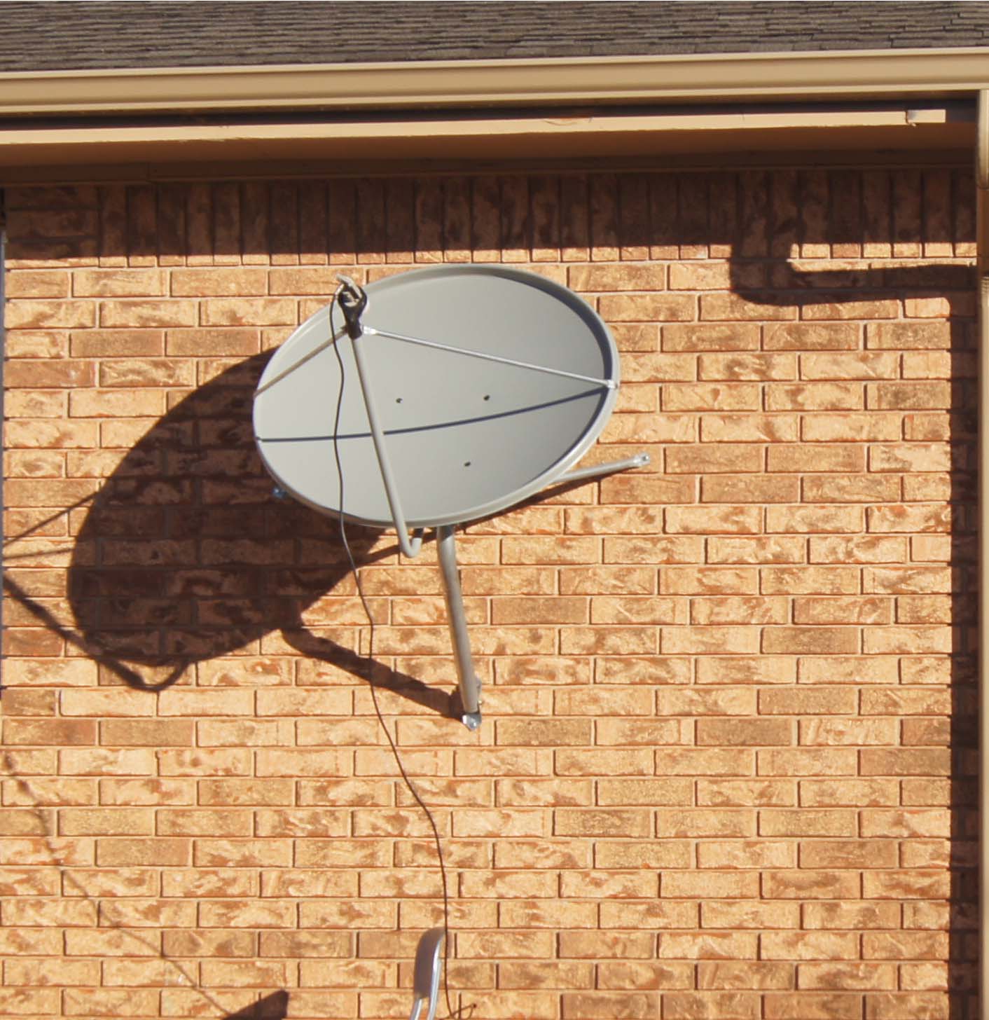

DSC03252a.jpgThank you to all of you who reply and making some suggestions. I have attached some pictures to see where I am so far. The vendor sent me some of the information that included that D/L Freq should be at 11789 and Sym Rate at 28125. According to my location the elevation should be a 48.1 which is hard to set on the dish, and the Azimuth at 176.
I try all these and nothing is showing up.DSC03249.JPGDSC03249.JPGDSC03253.JPG

I agree that the dish appears to be aiming too high, but the picture of the scale looks correct.
Are you watching the signal meter on a TV next to the dish as the dish is slowly panned East /West? If no Signal Quality reading s detected, increase or decrease the dish elevation in one degree increments and repeat.

Looking again at your Pics, the angles may be deceiving.
The one Pic shows gauge at 46, so crank it up to 48.
I have exact same Dish at home, and remember the elevation gauge being accurate.
Also, at about 12:45, the Sun will be at the same direction as the Sat - give you an idea where you should be pointing.
Shouldn't the dish elevation be set to compensate for the offset of the LNBF support arm? I am thinking that the dish elevation should be set to something like 48.1° - 22.5° or 48.1° - 24.5° etc. I have a block in my mind but I was thinking the actual elevation of the satellite from Stillwater, OK was 48.1° and that the dish elevation will be less than that. Or am I in error?
RADAR
A typical offset dish elevation scale would already account for the offset angle. Have never seen an offset dish with a non calculated offset scale, but there is always a first!
I must be trying to confuse myself with setting up a H-H motorized offset dish. Maybe the dish appears to be aiming high, but then again, Stillwater is 10 degrees further south than I am, so that will make a difference. Lak7 stated that he has the same dish and believes the elevation scale to be correct. Gfb may have it set just a couple degrees too low still. I'd boost it up a couple degrees like Lak said and then get a portable tv and the receiver out there in the yard and watch the quality meter as the dish is panned in the azimuth VERY SLOWLY.
