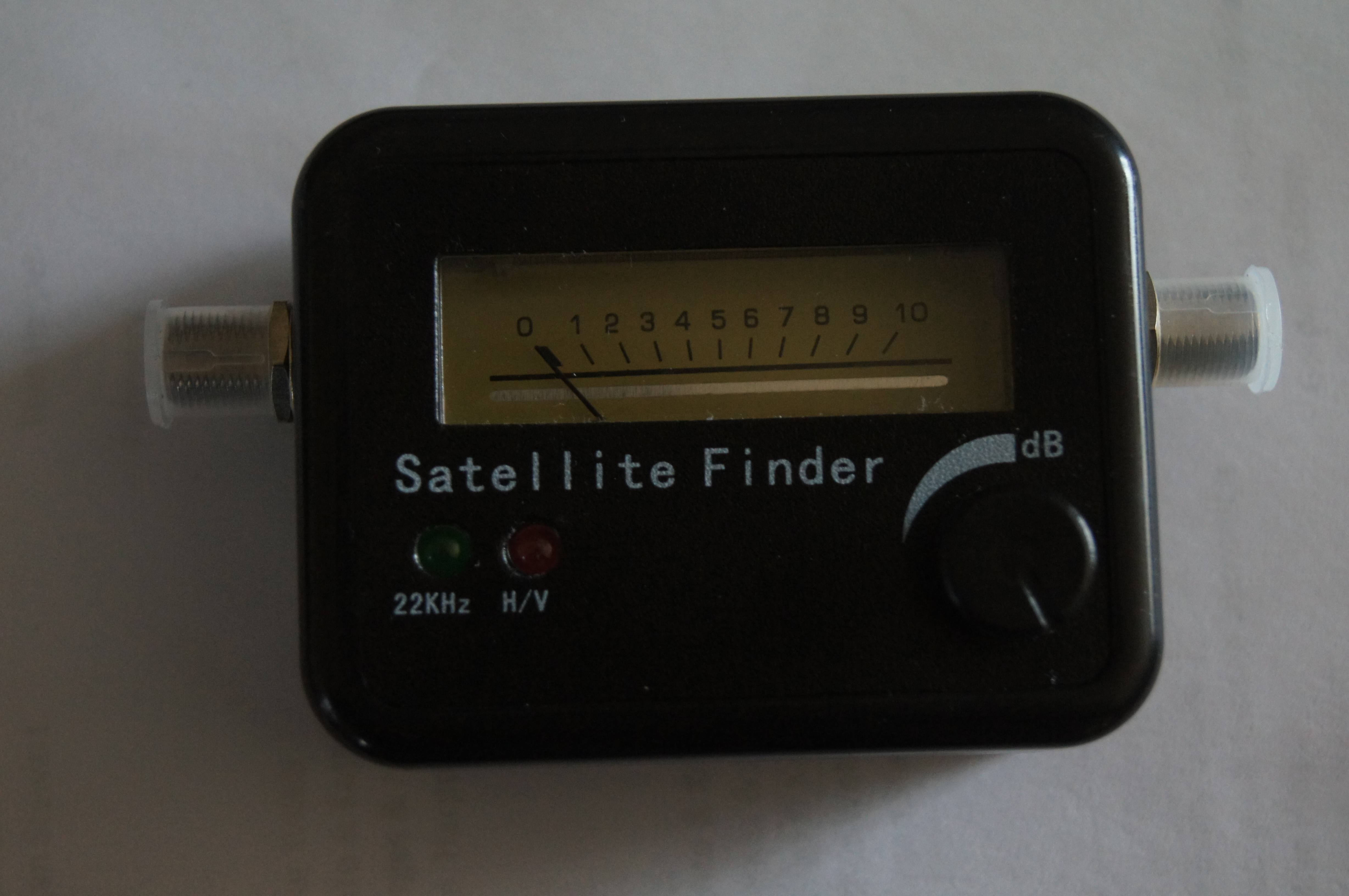

I have a Satellite Finder, but I do not know how to use it. I read that I have to set the reading in the middle, at 5, then what? How to know that this noise is a signal from the Satellite? DSC03256.JPG
I have a Satellite Finder, but I do not know how to use it. I read that I have to set the reading in the middle, at 5, then what? How to know that this noise is a signal from the Satellite?View attachment 83987
Satellite meters like this one are generally a bit lame. There is no way to know which satellite you are on until you scan and verify it with your receiver. This type of satellite meter is basically performing the same function as your signal level meter on the receiver. It will detect ANY satellite, but you don't know which one. You need the QUALITY LEVEL meter to really inform you what is going on. You can utilize this type of meter to help you get in the ballpark, though. If you cannot get a portable TV or some sort of monitor out to the dish, you can try it with this meter.
With the dish not pointed at any particular sat, just picking up background noise, use the adjustment dial knob to position the needle at 1/3 to 1/2 scale and then start panning the dish in the azimuth. When you see the needle jump way high, readjust the knob to bring the needle back down to mid scale and continue adjusting the dish until you peak the signal again. When you cannot increase the reading any longer, then revert to your receiver and your TV monitor and verify the QUALITY SIGNAL level. If it seems like you are getting a "HOT" reading there, you can try to scan and then verify if you hit the RIGHT satellite or not.
I used a meter like this many times.
Do like radar said.
You still move your dish very slow when making adjustments and while making adjustments look at the meter. The meter response faster than the receiver will, at least that is my experience.
Like Radar said this meter will not tell you what satellite you are aiming at, it will only tell you that you get a signal and that you are aiming at a satellite.
When I am trying to aim a dish at a satellite I always take my small TV and receiver to the dish. I set everything up so I can see the TV, my meter, and able to use my remote right there from the dish while adjusting it. I also keep tools in my pocket to have them ready.

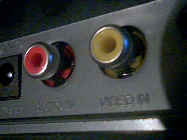

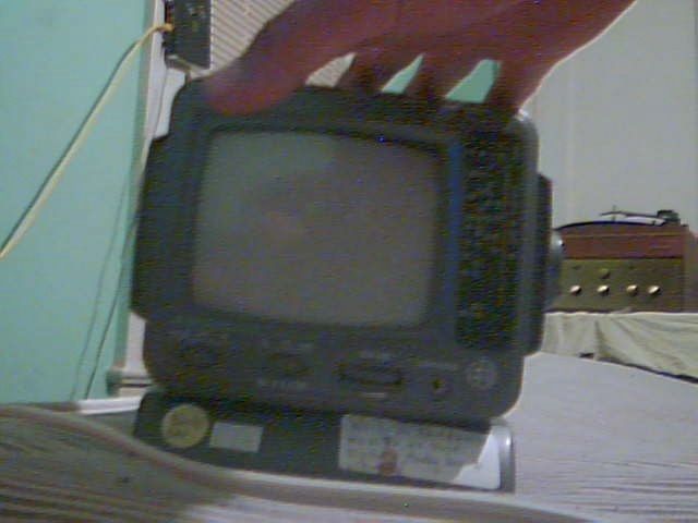

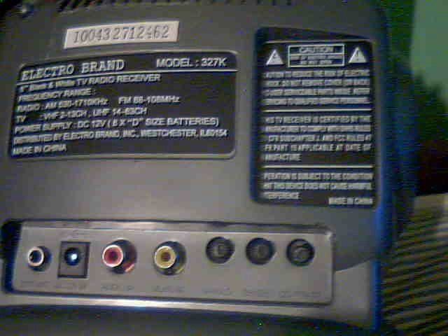

Get yourself one of these (see first photo). They run off battery power or from an AC to DC power adapter. Since the switch to digital TV broadcasts they show up quite often at thrift shops and yard sales. I paid $3 for mine and it came with the power adapter (wall wart). Make sure it has the RCA inputs (composite inputs ) for the audio and video signals coming out of your receiver (see third photo). They are so very handy. -Wes :)
2013-01-06 01-38-47.520.jpg2013-01-06 01-40-17.206.jpg2013-01-06 01-41-30.853.jpg
