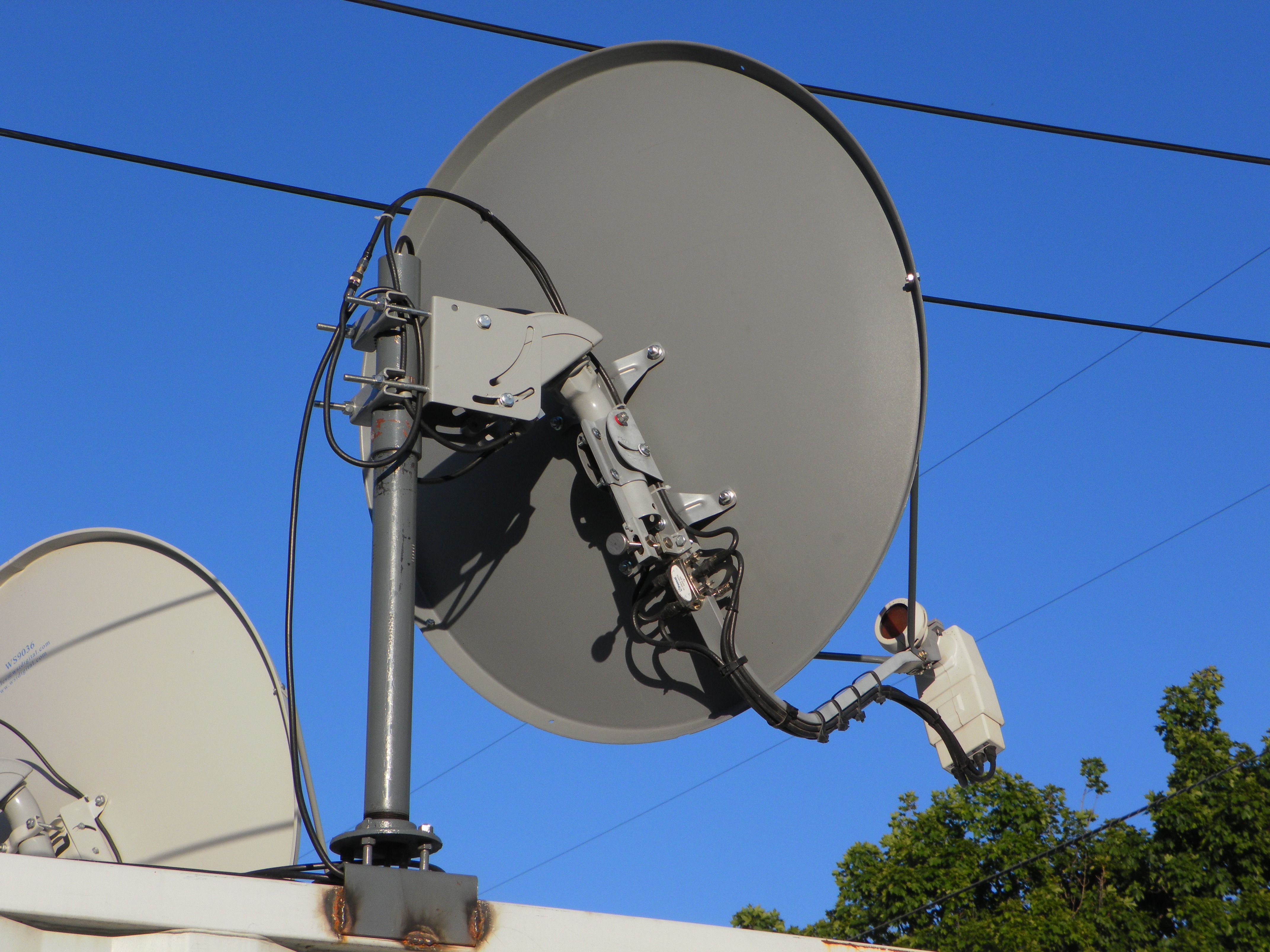

satfav17.JPGThe Winegard DS-2076 was my first FTA dish. Very good dish. I'm still keep it up and running.
