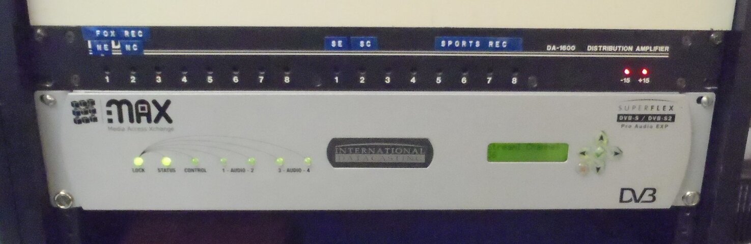

Srictly from someone who contracts to use that satellite for reception of our newscasts and sportscasts, I can tell you there are authorizations that talk TO our particular receiver, which is actually a full rack-mount PC. Called the MAX receiver for "Media Access Exchange" it has the DVB and DVB S-2 logos right on the front. Local spots come over the internet to insert in certain programs (like our CBS news) and are automatically played back from memory storage as part of the 'cast. We can be DE-authorized as easily as authorized, much like subscription TV. Some feeds will be "open" at times, however.
It was my impression that for MOST of the major suppliers (Westwood one, now "Dial Global") an authorization hit is needed to the particular receiver from their network operations. This makes sense, as it would keep stations with lesser conscience from just "grabbing" any feed they want and airing it without permission. We are authorized by contract to receive and re-transmit CBS NEWS and the 1 minute updates from Yahoo Sports Radio (formerly Sporting News Radio.)

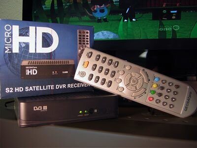

The GEOSATpro microHD STB is only 5" wide x 1.25" tall x 4.5" deep and weighs 6.1 ounces.
Will be shipped with a full size remote, batteries, external power supply and 1 meter - 3.5mm AV breakout cable
First Public Photo Release..... on SatelliteGuys!
Estimated release end of December, 2011 or first of January 2012.
