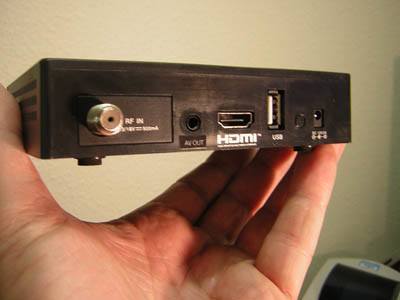

Brian, can we see the back of the receiver?
Port configuration on the preproduction approval unit without graphics.

the AV breakout cable......is that like what DIrectv is doing on their H25 unit? The H25 works fine on HDMI but if you want component you need the cable with the 10 pin DIN on one side and the cables on the other?
It is a standard 3 ring and shank 3.5mm plug with RCA plugs: composite video, left audio and right audio output. Dolby licensed and decoded on the RCA plugs.
