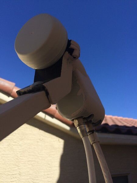

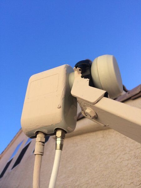

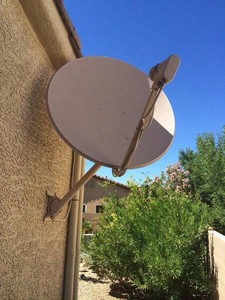

So I took pictures today of the LNB and the Dish.
From the looks of it, without moving the mount, I can get between AMC 6 and AMC 15. However I want to go through the HOA docs and see if I can't move the dish to the roof to get more of the belt.
The measurements are a little smaller than I thought, 33 in vertical and ~30 horizonal (probably a little bigger horizontal) which works out to 83 cm x 76 cm.

That's no Dish Network LNB I've ever seen. It looks like a normal dual-output Ku-band LNB. Chances are it's pointing at 97W. Since you're in a big city, maybe you could find a dirt-cheap used receiver in a pawn shop or something and check.
A 76cm dish will get most but not all channels on most but not all satellites. (Unless you're in a really strong part of the signal footprint, the NBC transponders on 103W will require super-accurate aiming. I can't speak to the PBS channels on 125, because not only did I never try them when I had a 76cm dish instead of 90cm, but they were DVB-S rather than DVB-S2 back then anyway.)
One other word of caution: my old 76cm dish was NOT compatible with a motor -- the design of the bracket just wouldn't allow it to fit on one! I don't know what model of dish you have there, but like my old one, it has a rectangular LNB arm rather than a square one. The only way to know for sure would be to get up there and look at the bracket from the top.
The paint shouldn't cause you any problem and the dish is big enough for FTA, I have two dishes setup here that size and they work pretty well.
The LNB could be anything, probably when you get a receiver just hook it up and try it, see if it works. Or you could buy another, they can be bought as cheap as $5, you can get a decent one for around $20.
I have a MicroHD receiver and it's been really good for me, I don't have a Amiko mini HD SE, so I don't know about that one.
An afterthought: I bet you could probably scrape the paint off the label on the LNB with your fingernail or something, house paint on stuff like that doesn't usually stick very well and comes off pretty easy.
I also think that could be a dual Ku LNB, maybe still in working condition, chances are you may already have part of your new FTA setup there. ;)
Just an update. It is a dual LNB Ku band dish aimed at Galaxy 19. I had fun tracking down the 5 white coax cables that came out of the wall to the two running to the dish. But now I've caught the bug and want to add a motor.
