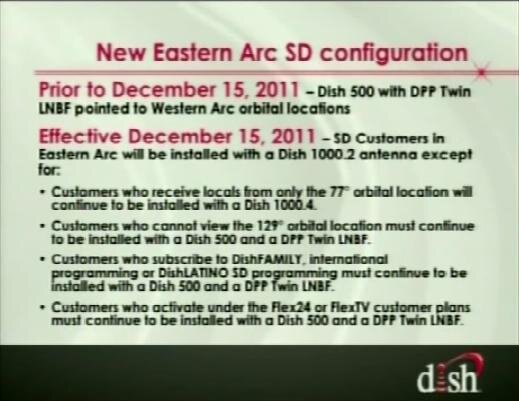

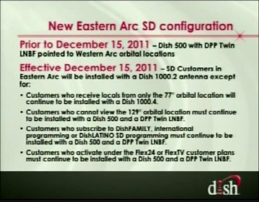

The new LNB was talked about on todays Retailer Chat...
Here is some information on the changes coming...
It probably means that Dish has figured out that 48 (16 at 61.5 and 32 at 72.5) Conus transponders will provide all the channels required for Conus service. 50 Conus presently on western arc plus the 1 they lease to AAD.
I guess one can conclude that the market has matured.
I have be preaching about the number of CONUS TPs needed for each arc for the last year or so in my posts and also speculated that Dish could do exactly what is being talked about with most folks on the EA only needing 61.5 W and 72.5 W. I did think that the QuetzSat-1 satellite would be a hybrid spotbeam/psuedo-CONUS satellite so that folks that had their locals on 77 W would only need 72.7 W and 77 W but obviously that didn't happen. For the WA, expect even fewer TPs for CONUS because Dish will eventually want to use 10 TPs at 119 W for spotbeams after the WA conversion to MPEG-4 instead of the current 5 TPs. Recognize that the duplicate SD channels on the WA should eventually go away which will leave even more space for national HD channels.
It's interesting how Dish makes this new requirement effective December 15th when the new 1000.2 EA LNB won't be ready until at least February. So pretty much techs just keep doing what they've been doing until the equipment becomes available......soon.
