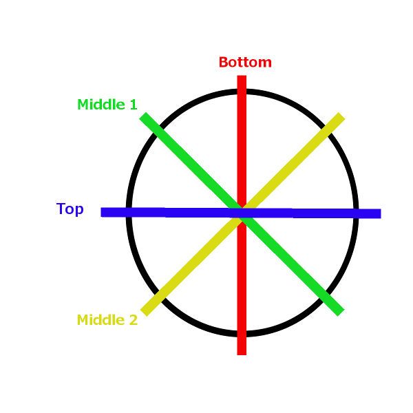

Well, that didnt work. Drilled holes through the pipe, run the bolt through, tightened it, the whole thing was looser than a drunk goose!! Back to Lowes a third time to get back the U-Bolts. :-/
Snap a photo of the bolt holes. Top and bottom bolts at 90 degrees from each other and the center bolt at 45 degrees will lock it place. You did go with a larger pole to sleeve than we recommended, so you might add a 4th bolt in the center on the opposite 45 degree.

Yes, drilling and bolting at an angle would take the post out of plumb. No worries since you are not mounting a motor. Just add subtract a few degrees here and there...
I drill and bolt on horizontal axis. Here is an image looking top down:

@Titanium: ok, I can take that angle bolt back out, check the level, and try to redrill level at an angle. I have another bolt left I can try another way. Its supposed to be stormy here tomorrow, will see if I can get to it or not.
@Titanium, or like you said, I can also just leave well enough alone, and compensate the elevation and skew, which is no big deal for me since I'm not mounting a motor. I dont know if my Manhattan receiver will support two motors.
