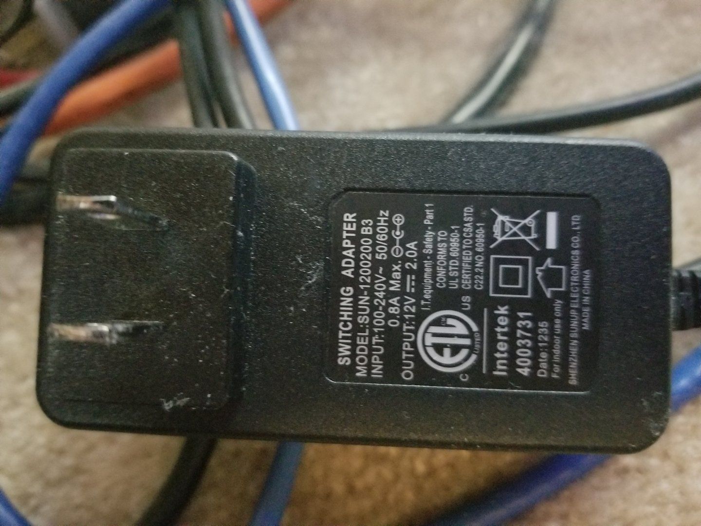

The 2-prong US plug adapter is really hinky and loose IMO. Maybe it sometimes loses electrical connection, mine did. Wrap it around the adapter with some duct or electrical tape to hold them together tight. Mine is plugged into an extension cord, and I have tape around the whole thing strapping it together. Extension cord, US adapter AND the brick. You couldn't do that if it's plugged directly into the wall, but if yours is, wiggle it a little and test if yours is also loose.

Edision is working on providing a PSU with swappable plugs. Hopefully, this will happen soon! :)
Thanks ALL for the great replies. I'll tape up my plug. Yes it's a bit wonky, but tape fixes almost everything. I'll also try a different -7 hour time zone. My AC power is flaky which is why I have a gas generator, solar, and wind backup.

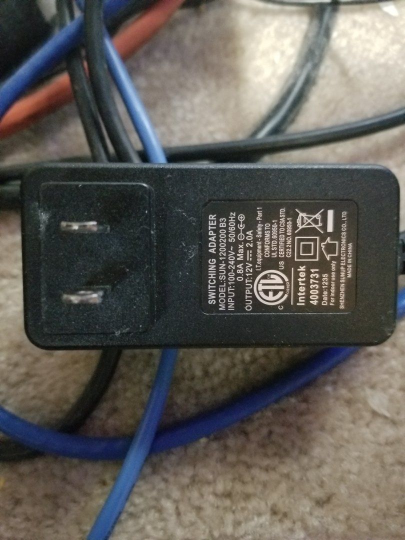

I replaced my power adapter on my older mio with the attached image. Works fine. I'm going to see about getting one for my newer mio.
