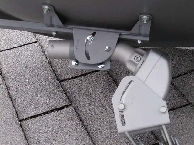

Well guys, I won't be starting a career in satellite dish installation any time soon.I got my system, but have been completely unsuccessful in finding a satellite. I have 90cm geosatpro dish / gs-120 geosatpro motor / fortec mercury II receiver.I'm temporarily in Waco, TX (lat-97.1 long-37.1). I'm pretty sure I set my receiver up correctly (taking into consideration my lnbf(std), my location, and the usals motor.) No matter where I point the dish the receiver reads 40 signal strength and 0 quality. Anyway, I think my problem is my inability the aim the dish correctly. I pointed pretty much due south with a magnetic declination of just over 4 degrees east. From my information the dish elevation for galaxy 25 is 53.1 deg. However, since I'm using a motor, I set the motor angle as my longitude and then according to my longitude I set the dish angle around 24.85 deg. The problem is, I'm not sure the angle scale on the dish is right because 24.8 deg is pointing slightly down (relative to the motor's mast) this didn't make sense so I went out and got an angle finder at home depot. Then leaving the motor angle as it was I changed the dish elevation to equal 53.1 deg (but still no luck...on a side note this looks really high when compared to neiboring subscription dishes.)Despite my confidence going into this project I now just feel like a bumbling idiot when it comes to dish installation. Any and all suggestions would be greatly appreciated.Thanks a lot.
I did follow the motor directions to the T. However, the instructions for the dish had me put the dish bracket on one way, but in order to be able to attach the dish to the motor I had to rotate the bracket 180 degrees. That's why I'm not so sure the angle scale on the dish bracket is correct (thus the reason I got the angle finder.) Along the lines of the 24.6 degree offset angle of the dish; if I'm supposed to have a ''dish elevation angle'' of 53.1 degrees for the top of the clark belt, does that mean the angle finder tool should read 28.5 degrees (53.1-24.6=28.5)?
Stick the angle meter on the front ofyour dish, right in the middle or close as you can, that should read whatever elevation you dish is set on. It's not perfect way to do it, but will get you very close.

That is exactly how my dish/motor look.
