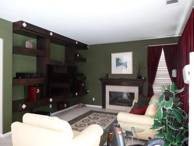

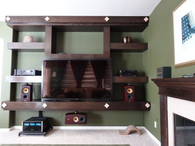

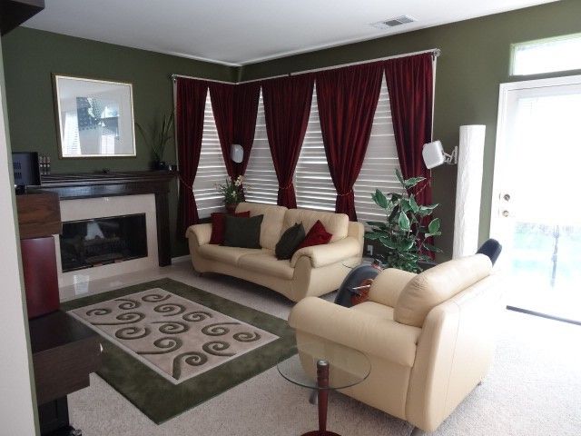

In my prior post, Starz was showing Chimpanzee, the hd picture was outstanding in 1080i. 1080i vs 1080p, pq is so close you'd not notice the difference unless there is fast action. Progressive is better with motion.
As far as why 9' from my 70" screen as my viewing distance; I moved the sofa back and forth till I found the right distance for movies in 1080i/p that I'm very familiar with. That's where the viewing was the most immersive and no pixels could be seen. If the screen was 4k and watching 4k, it could go a lot closer. Not that I'd want to sit that much closer and have to turn my head right to left to watch a movie. Ah but my inner child would love it. lol
