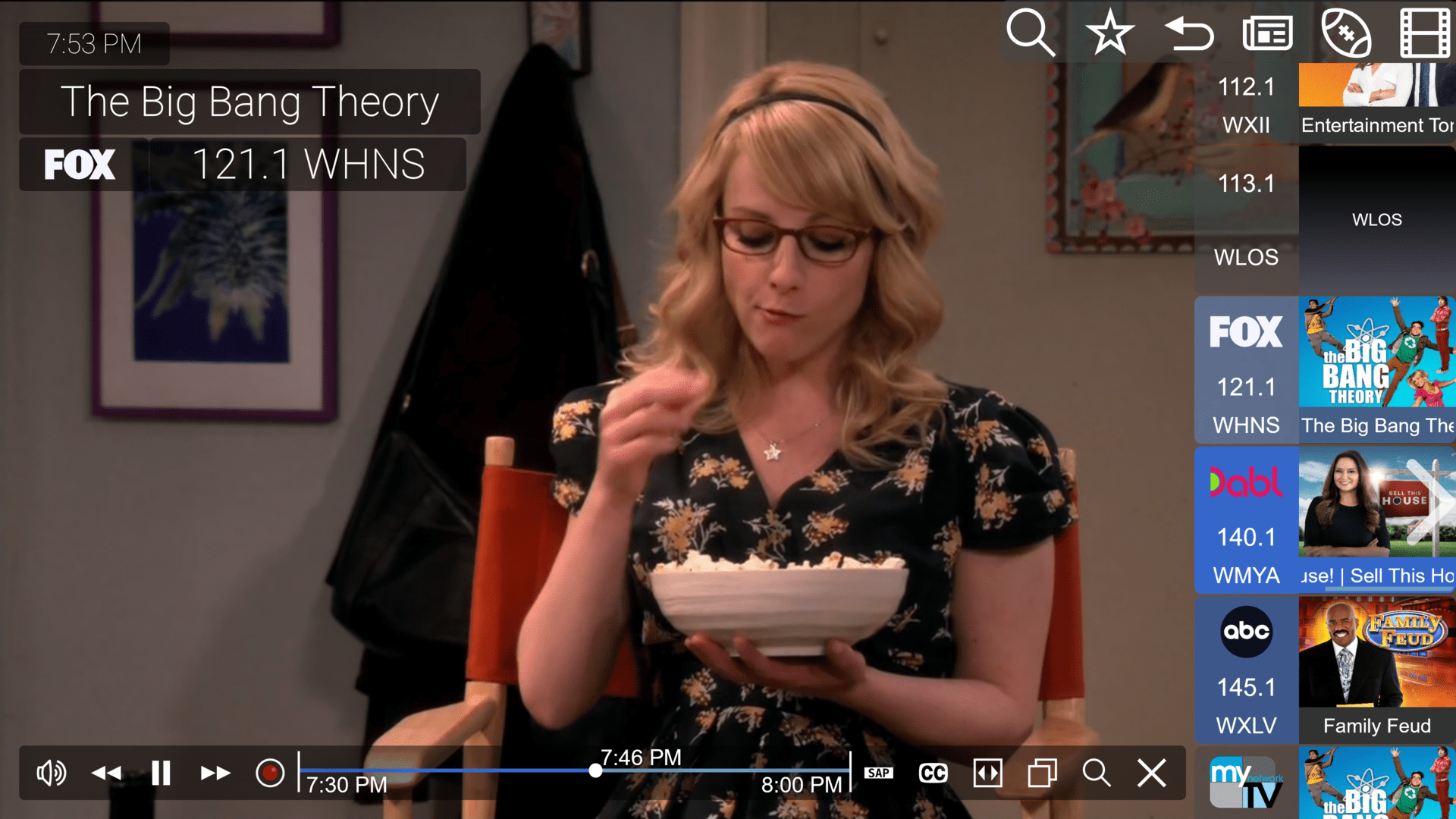

Just rescanned it is up, looks like they used channel 16 VHF2 here. Now getting Chrlotte stations along with my locals. 79 channels and the sub channels are clear as can be, they do not look up scaled.
